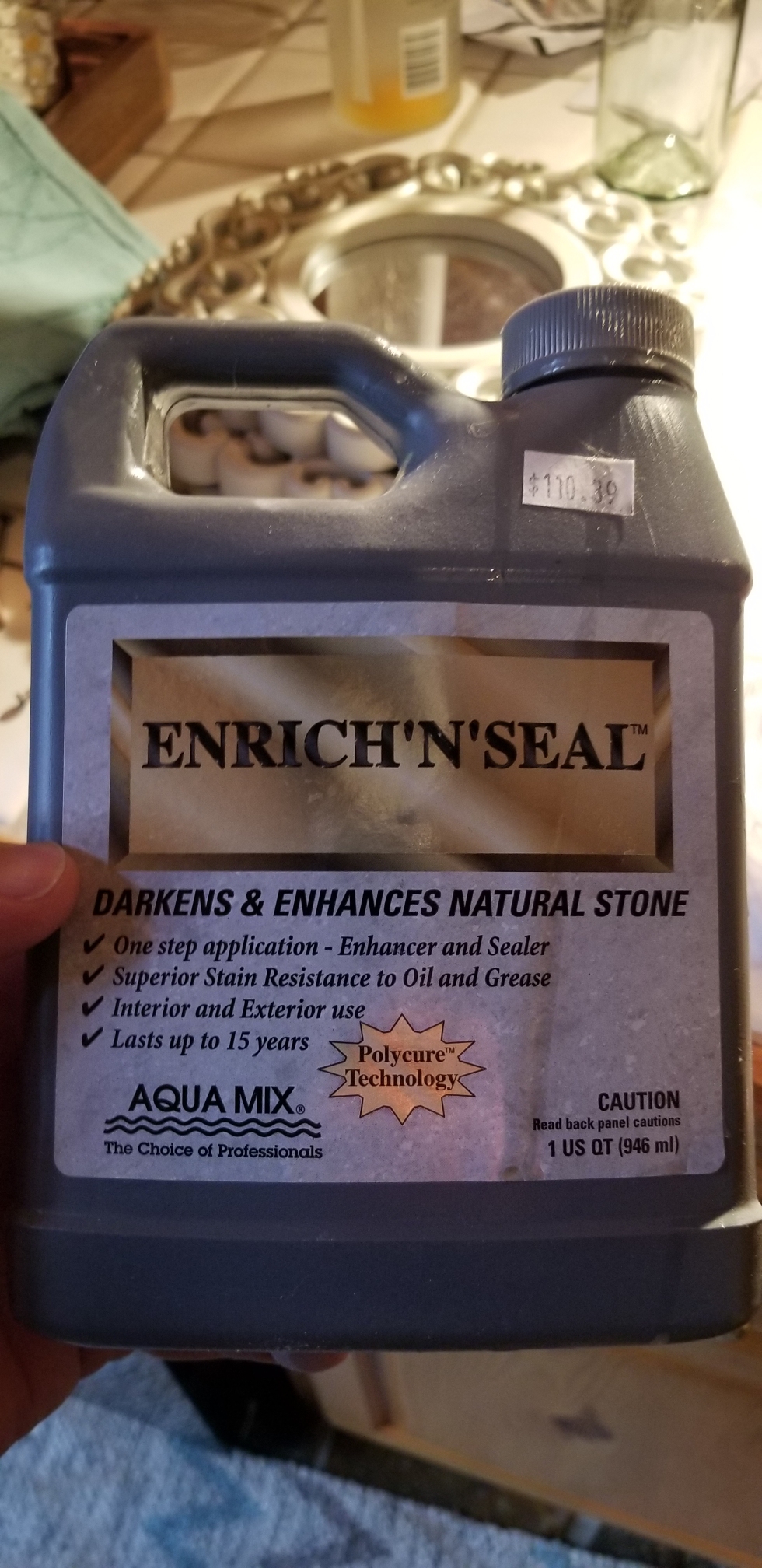

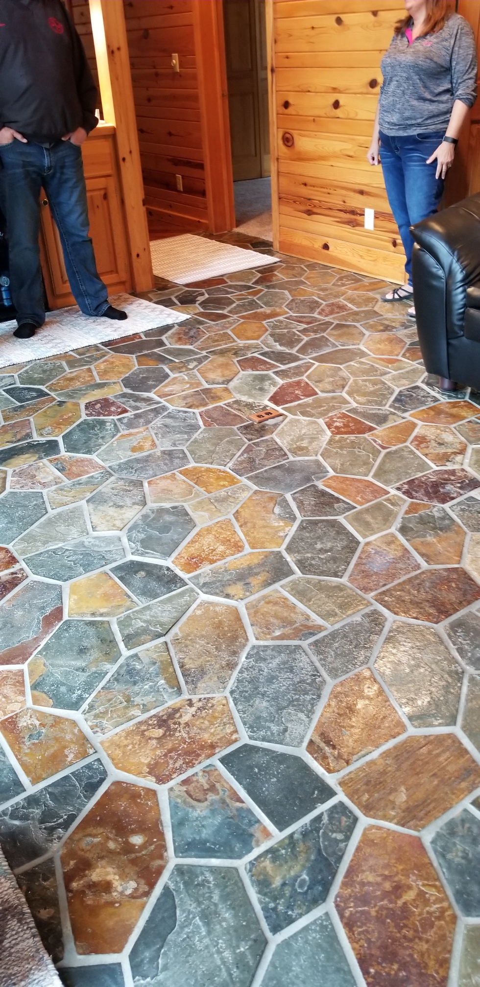

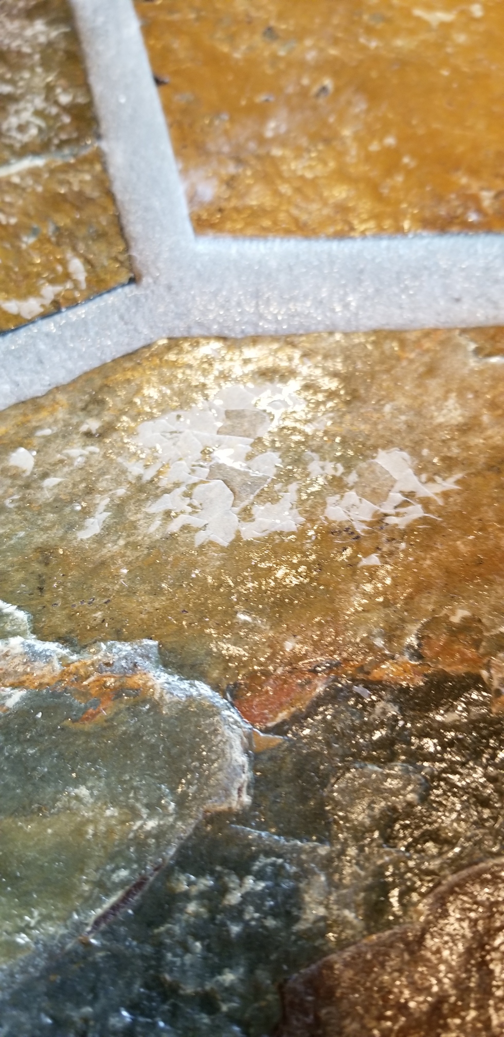

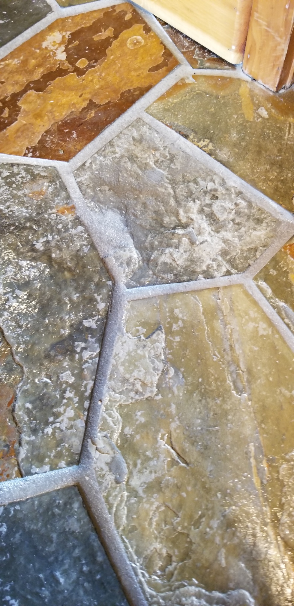

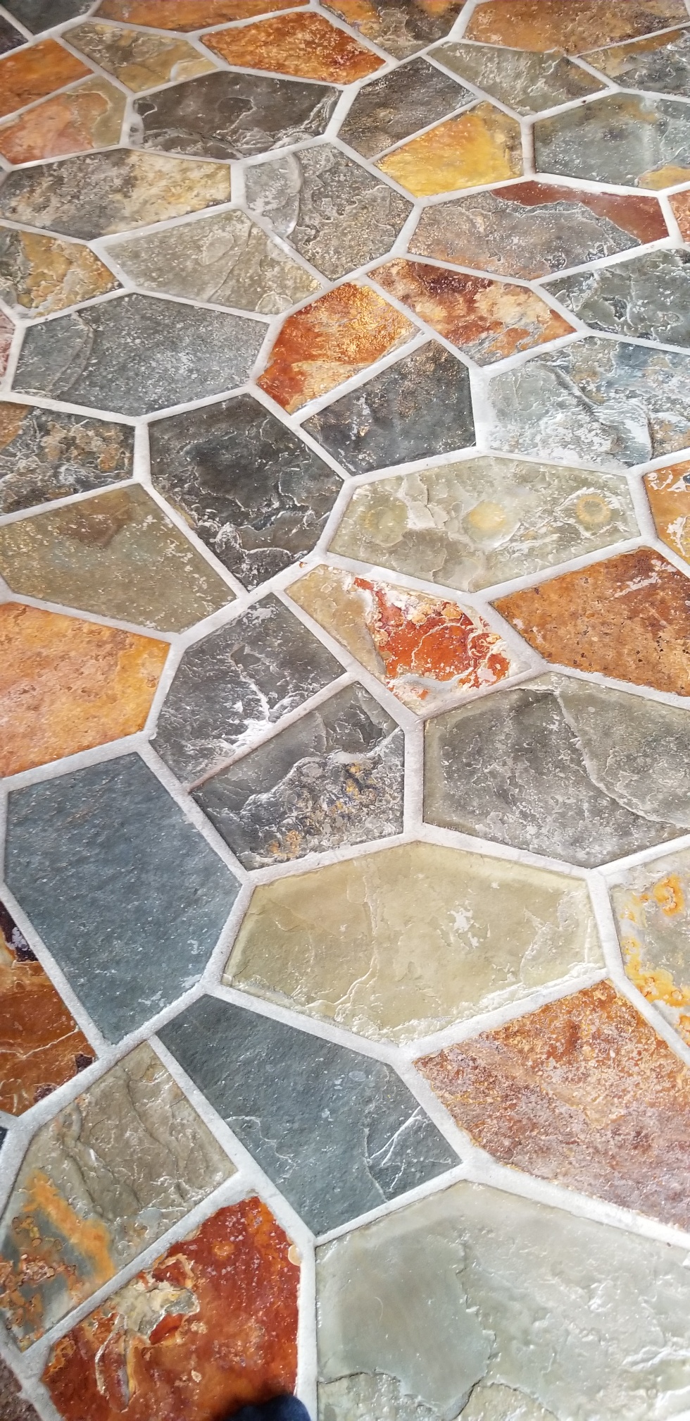

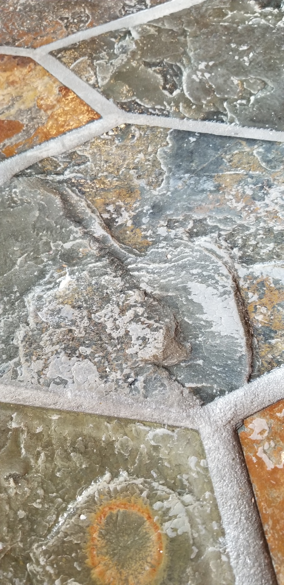

Mark was asked to correct this failing enhancer.
Looks like a topical mess to me , not an enhancer
9 month old install, customer swears onlt the shown product was used..

Great product used incorrectly

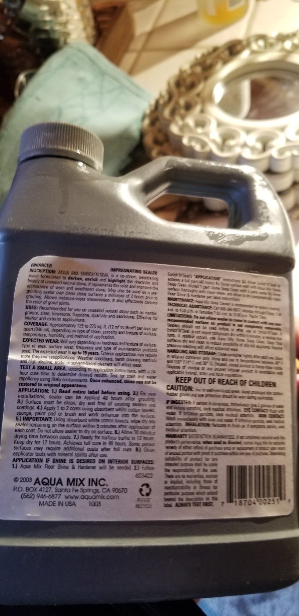

Enrich and seal is a 100% solids penetrant enhancing sealer.
Goes in, not on the stone.
Clearly states it right in diections

Agreed Over applied. If leaving it with the customer the label mentions to use Aqua Mix Stone Deep Clean to get it off.

It also said, once enhance, stone cannot be restore to original appearance...
