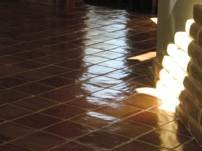

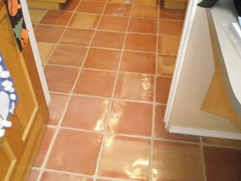

I gave a bid on stripping and re coating one just today.
What are you charging for the clean and stripping steps?
R
Ron Lippold

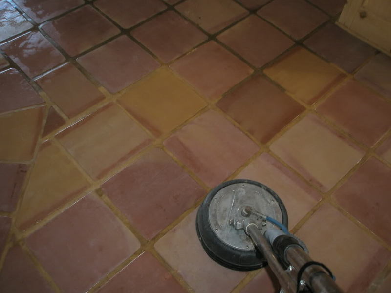

1 strip with harvards 710 rinse with straight water and finish with quantum concrete finish
I get a min of 450 to start a small kitchen and just cave a est for 1500 sq ft for 3500$$ it will be a short 2 days one for strip and one for 4 coats of finish
R
Ron Lippold
why? no one wants to do these. Its good money and with the concrete finish I have floors in art gallerys that have almost 2 years and the finish looks cherry
S
steve frasier
I was asked to put in a bid to do a strip on a floor like that once. The maid company said they waxed it with mop n glow once a week for the last year
never again if I hear those words
looks nice Ron, I have turbo washed a couple of aggrete rock entrances and always looking for something to put on them, I have been using a concrete finish from Johnson
can you remove that if you had to
