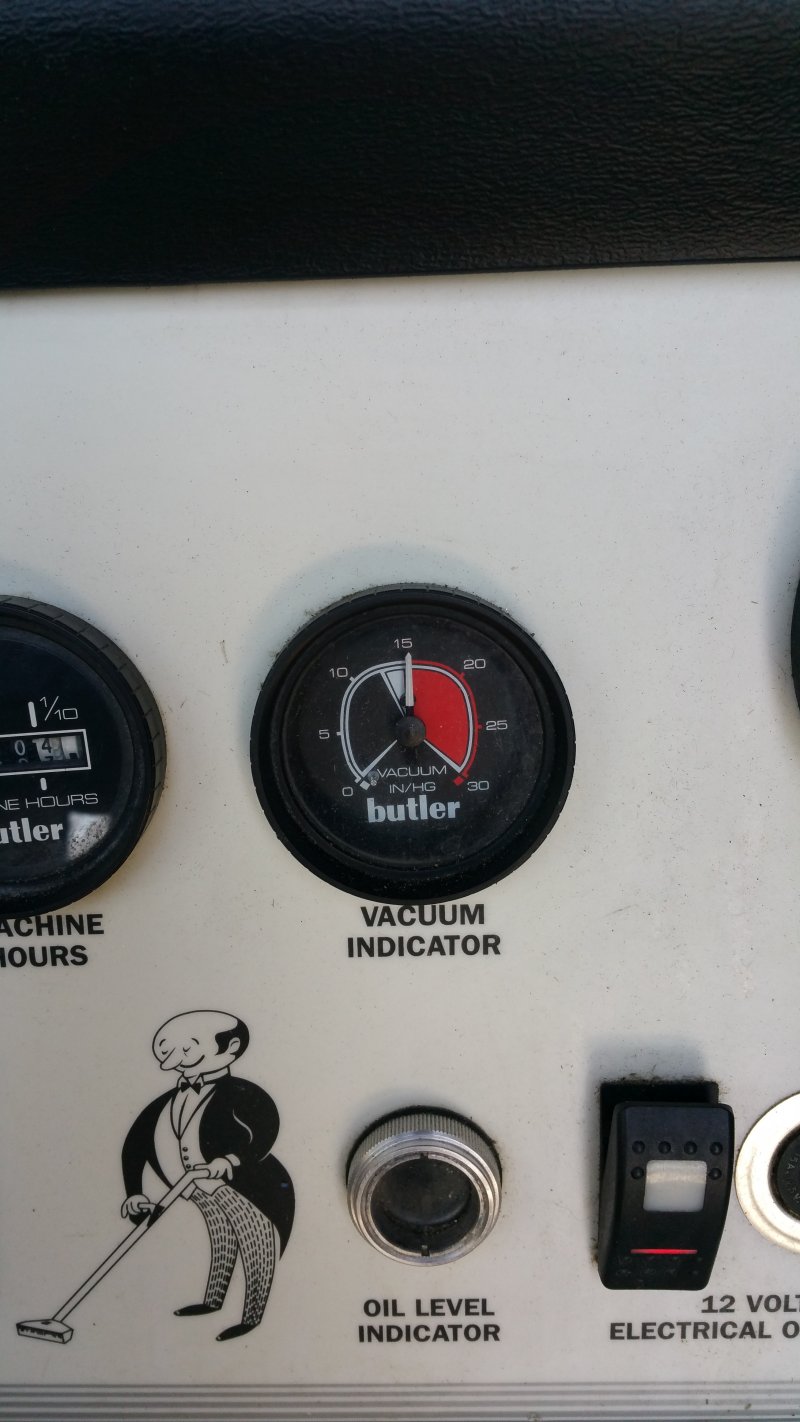

Or the Cleanco installed by TCS, my 47 is set at 14 just like the manual says.
I couldn't expect more out of that workhorse. I will consider another when it's time.
...or Butler
...or Sapphire
If you like the Sapphire, crank that sucker up to 14 or 15 and enjoy your purchase!

All of Saphires units are now suggested to be set at 13HG From the Rage to the 870. To my understanding they can all run up to 16 HG.

and the Chief is a 4m............@15"
still not 16
