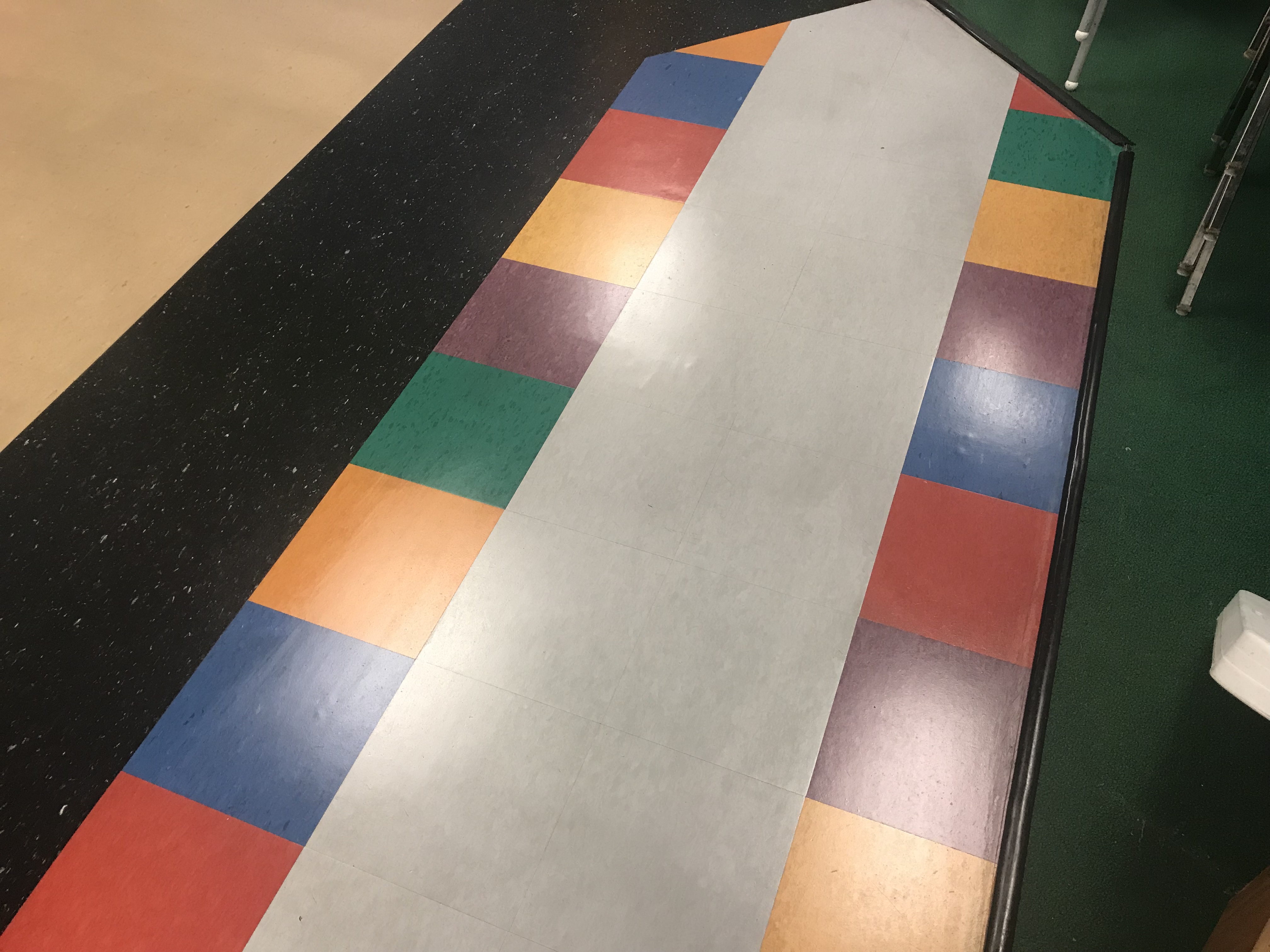

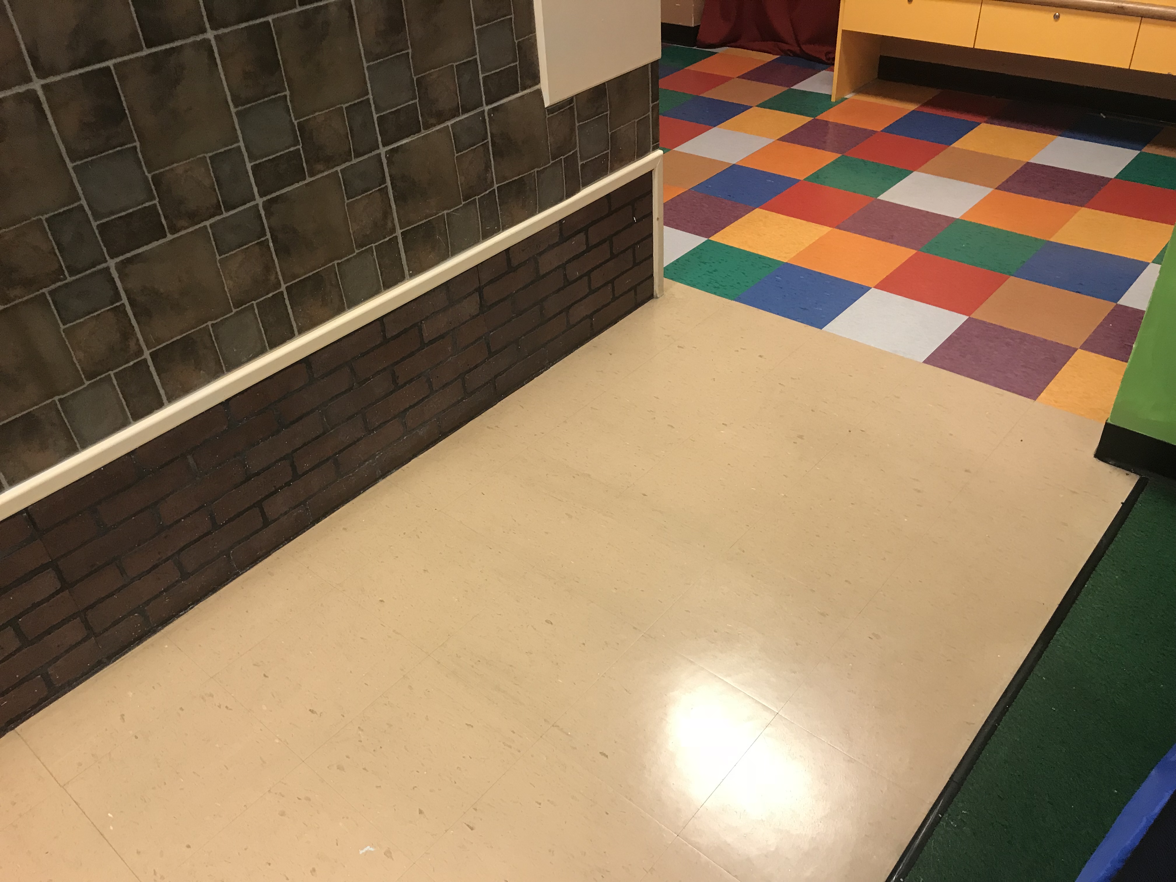

Thanks small town, so you think the marks came from wax? I’ve never had this problem before with putting my degreaser down for 10 mins with a mop, buff it, wet/dry vac up dirty water, apply wax. This is my first time using a solution tank so I thought it was the pad streaking the floor because the solution is being applied from the tank through the top of the pad vs the solution already on the floor with a mop.
So I ended up applying 3 coats of wax but it was difficult getting the streaks out. And please judge from the pics, i know first coat matters most but I felt some spots had a dark tone in the floor. It looks decent but I think I could have done better with a real strip job instead of scrubbing with black pad. Thats why my title is so, felt like my black pad did a deep scrub job only taking a few coats off.
