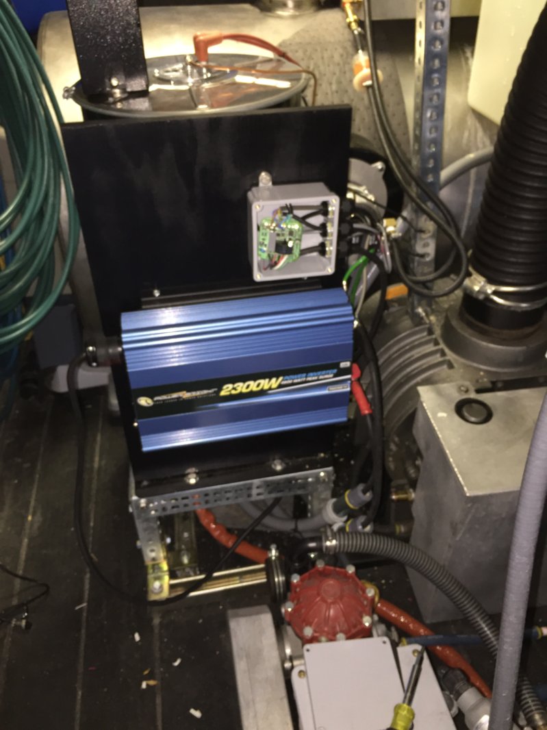

This diesel heater is off the Eldiablo, works great. I bought the inverter off amazon for $200, great time saver.

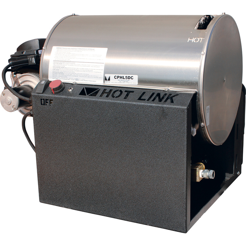

Is this what your referring to? HOT2GO BURNER
My engine exhaust exchanger is limping along due to a defect (bad welding job by manufacturer - thanks Hydramaster) and I've been considering an ad on like a LG or one of the Northern tools water heaters. It looks well built and has a small footprint. The possible downside is the diesel exhaust and the thing is #$@% HEAVY. I wonder how well they are constructed?
Now here is what looks like the SAME burner with a different name for $500 less. Making me wonder what if anything is different besides the brand name its being sold under. Hydrotek CPHL5DCH Hot Link
