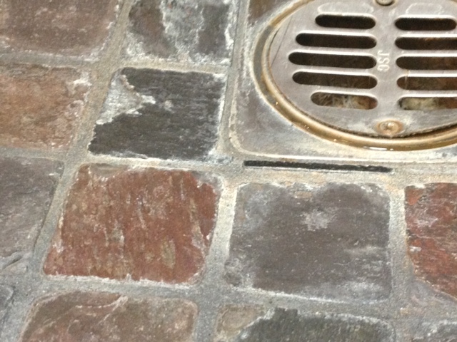

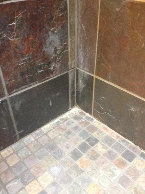

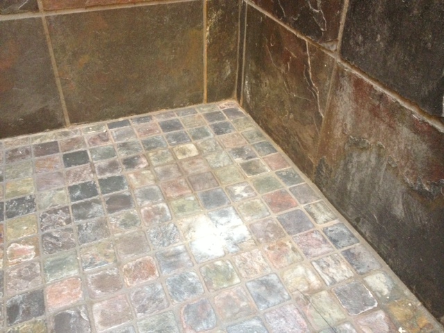

How would you pro's deal with this one?
Feb 5, 2013
527
Southern California
cameron demille
That's in surprisingly good shape. MB-3 soap scum remover and a good scrubbing should get it cleaned up, unless there is a coating on it. If there is, just strip it. Most of these showers don't last long.

Soap Scum is mainly composed of lipids which are fats. Historically bar soap was made from animal fats. The pH of MB3 is actually 12.5. You should be able to use an alkaline degreaser (although there is no substitute for MB3).
I like using a green pad or a 3M blue cleaner pad for scrubbing this material.
