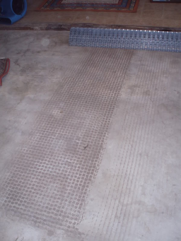

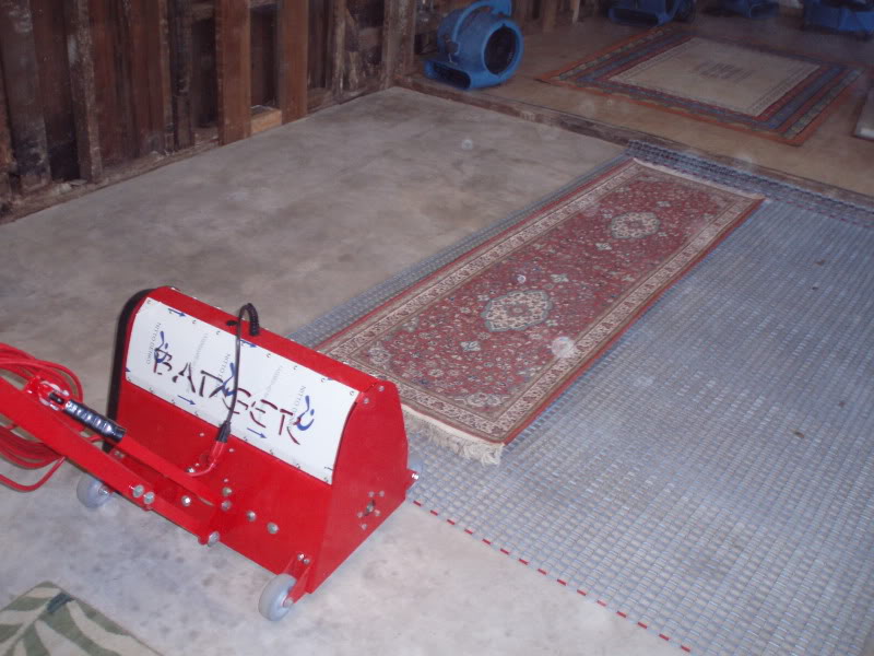

I used mine for the first time yesterday.
2 by 7 wool runner. Didn't really look that soiled at all.

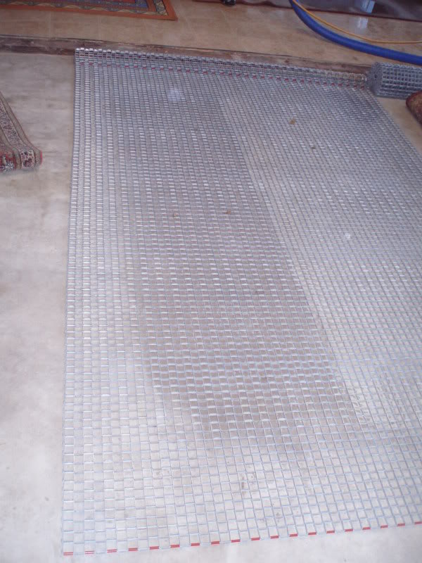

We Sanitaired it front and back then ran the Rug Badger over it for about 3 minutes.
So much dry soil came out the first time that I swept it up and did it again...

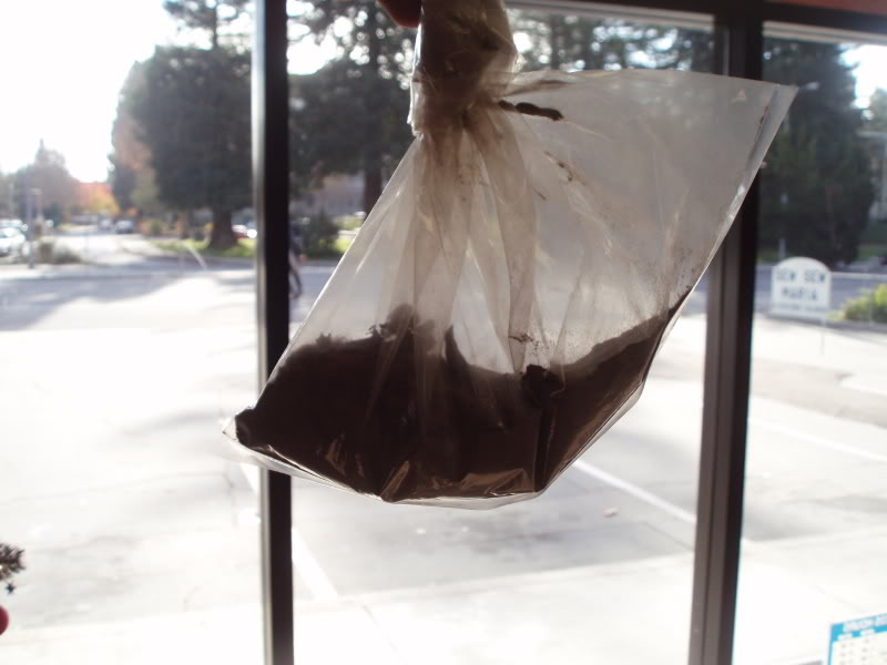

In the end this came out of a "clean rug"..

After you have cleaned it, and the rug is dry, run the Badger over it again.
You will be surprised at the fines that fall out.

You will get more once you hook up a vac to the vac port and you will find your shop cleaning area or what ever you call it will stay a lot cleaner also.

PPS (Sorry CL) show those bags of fines to your clients when they pick up their rugs. We got alot more rugs of theirs to clean because they didn't look dirty and they left them home.

Yea it's pretty amazing.
When we first got our we pulled a few rugs off the clean rack and hit them with the badger and showed the guys how despite being cleaned by us there was still soil trapped in the rug.
Love the badger!
