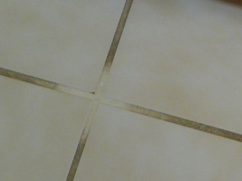

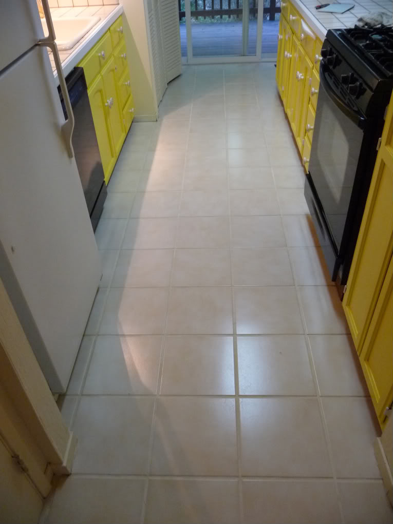

A wand and a Geckoe can clean lots of dirty grout and stone but you'll also find many that respond better to the heat chamber effect the Spinners create.
Deeply embedded soil will come out better and safer with a Spinner.
Yet watch this thing clean..
Test area from when we cleaned the carpet a week before..
Before rinsing
After..

Pretty dramatic results. Would you mind explaining your procedure on that job?
