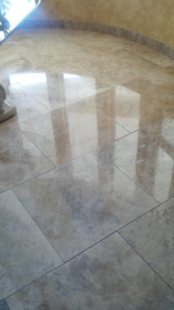

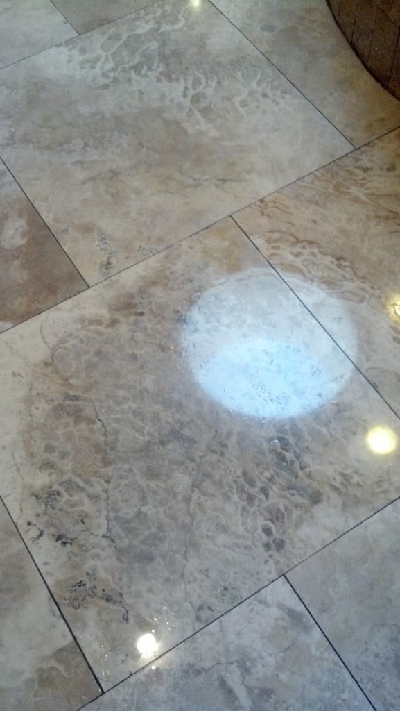

O yes I did. My skills are not top notch with the squeegee. I used to remove the haze from the sealer. The 11000 did nothing to the floor except get the haze off. And the grout line are black all over, go figure.
The grout is dirty all over, as is the stone. If the customer is happy that is what counts. There is always room for improvement. If I may suggest: using a grout brush before vacuuming the Diamond renew will clean the grout pretty well. Your customers will appreciate it. Looks like a lot of work for one man. Nice job.

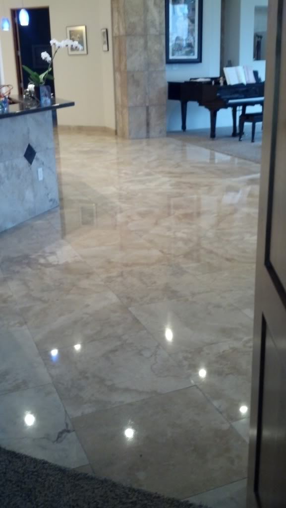

Yes. Like Ted mentioned, if you use a grout brush before vacuuming diamond renew, or any polishing compound, it should clean the the grout fairly well, but 5x will clean as you polish. It basically etches the grout clean. So when clients ask "what about cleaning" I say I am able to incorporate the cleaning process into the polishing process to save you money. Sold.

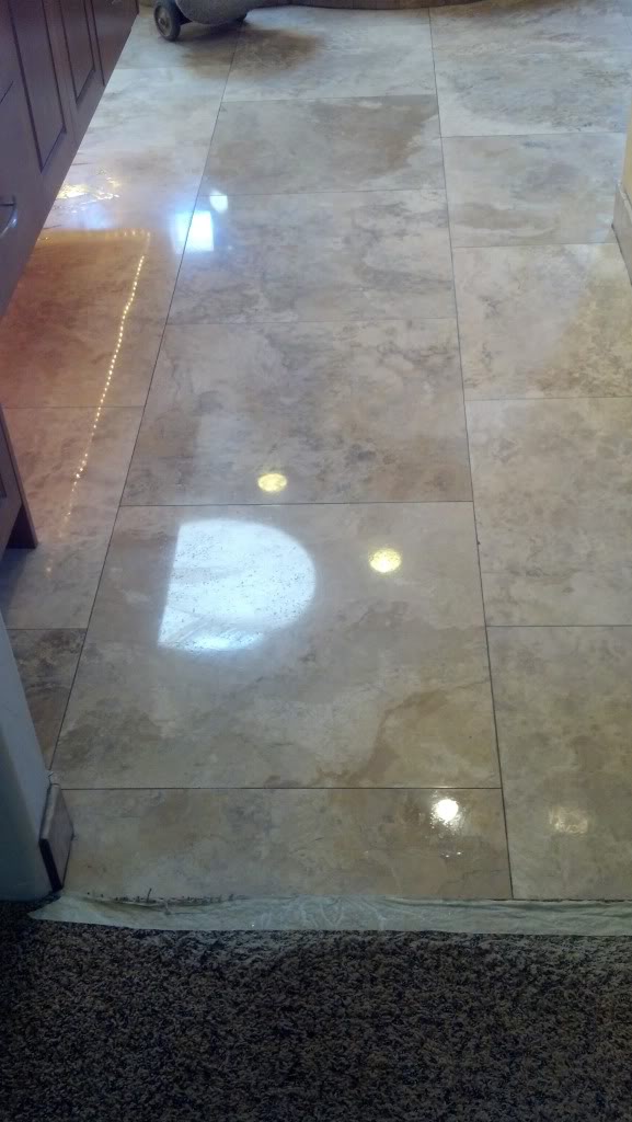

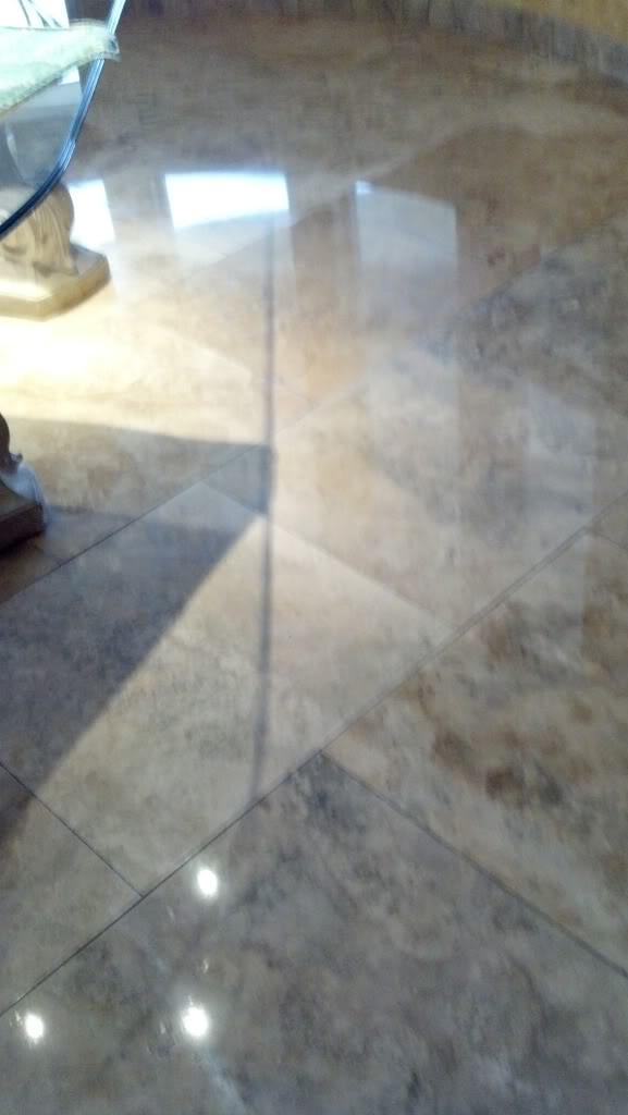

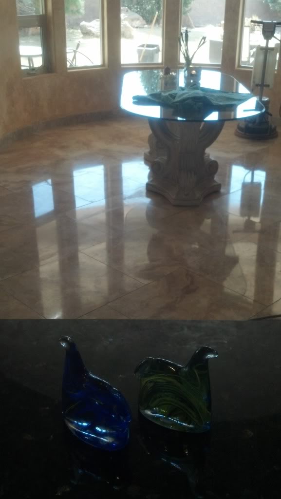

Here is before an after. The floor was diamond refinished, then polished with 5x. No grout scrubbing, no cleaner, just 5x with a white pad. Notice the grout looks new. The couple dark lines were just still wet, they dried out like the others.

Cameron I can assure you that after stripping I cleaned with Judson's o2 there was no change in the tile or grout, the floor was almost perfect, you have to remember our floors have lippage. We don't have any stone fags out here.

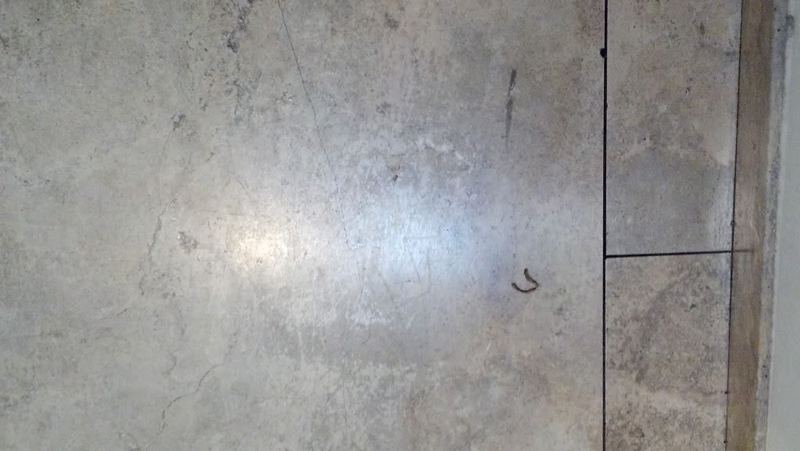

I find that you can seldom get away with just a polish. If it's a travertine and the customer wants a bit more shine then a polish after a clean alone would more then likely be ok.
However, if it's a marble floor and it is more then just slightly dull, a polish alone will more then likely orange peel the floor. Meaning the clarity would be lost or distorted. A polish alone will only go so far. For this, an abrasive to hone should be used first. Also, if there is etching, I find that just polishing does not remove most of them. If cheetahs are used for the honing, I would try #2 and #3, then go to powder polish. Even an 800 grit monkey followed by polishing would be better then just a polish in those cases.
Rob, it sounds like the haze was from the powder.
