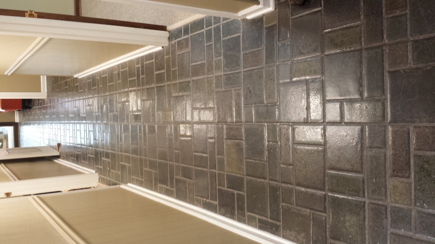

I looked at a tile floor that has obviously been stripped and recoated in the past. The last person to do it did a real poor job. The floor is real spotty and flaky looking. I recommended the floor be deep stripped which means it may take two or three strippings and then seal with a solvent based sealer with enhancer. There is 812 sq ft. I was thinking 3 dollars per foot to do the job, but I am not sure how much sealer I would need and if this price is too low. This is for a friend. Also there was an office that had carpet over the floor so under was in pristine condition. A guy that works at this place put some type of polyurethane on the floor. It looks great, but I know that is not a good solution. How would you price this job?
Sep 7, 2008
3,797
Edit the guy put down hard as nails floor finish. I have to say it looks great. They want it to shine and finish may be the only thing to do that.

It is not vct. If it was 75 cents per sq ft would be good. It is a ceramic tile that looks like brick and has grout. It would look great with finish, but then when it gets dirty it would need to be stripped again. That is why I was thinking the sealer would work the best.

Its not meant to have floor finish on it, so it would just flake and be spotty again.
Sealer would be my choice and yes $3 sqr ft sounds about right.
Hard as nails is not too strong, its betco so i would use their stripper extreme.
Might need to do some taping, can get real messy.

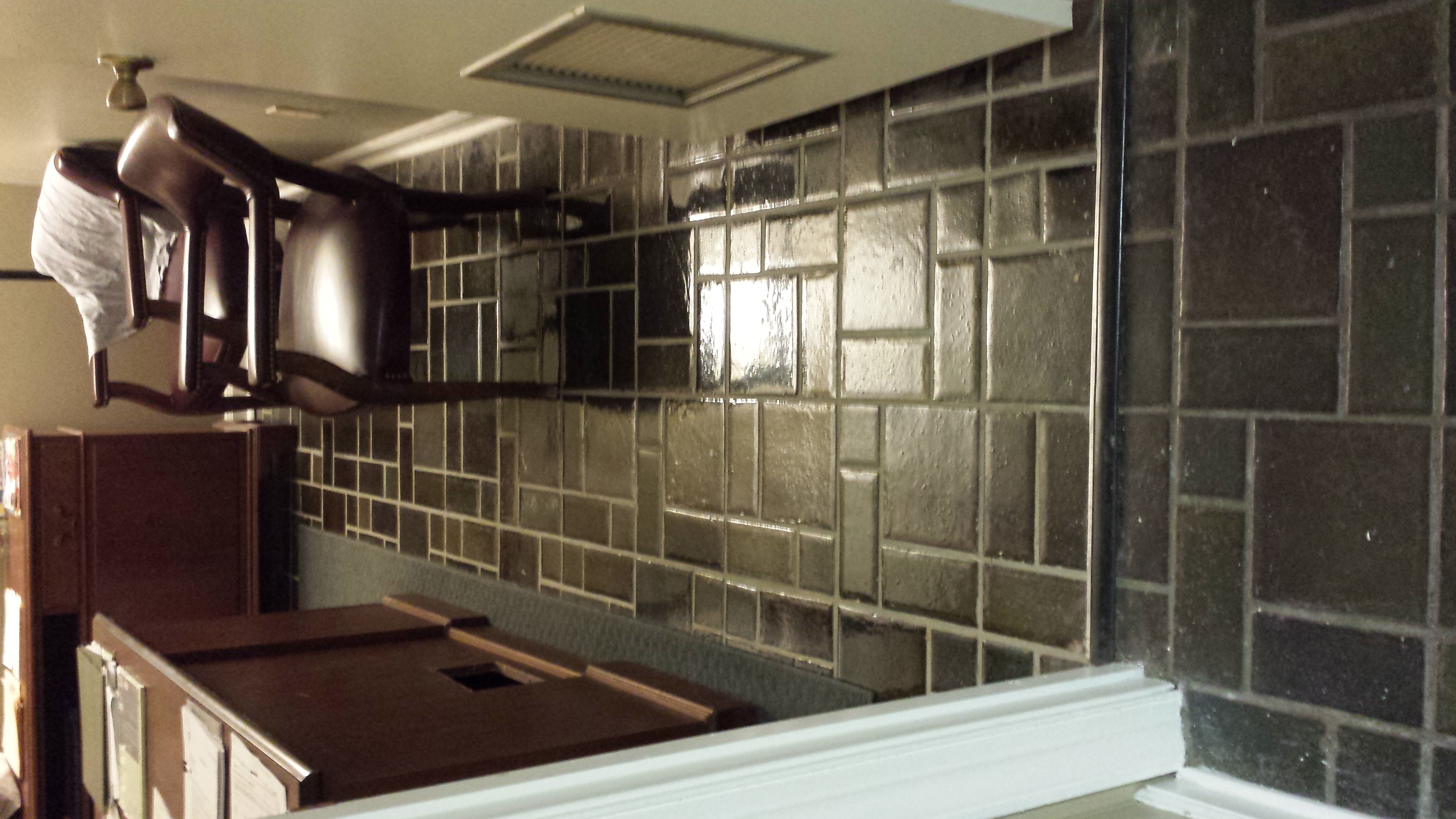

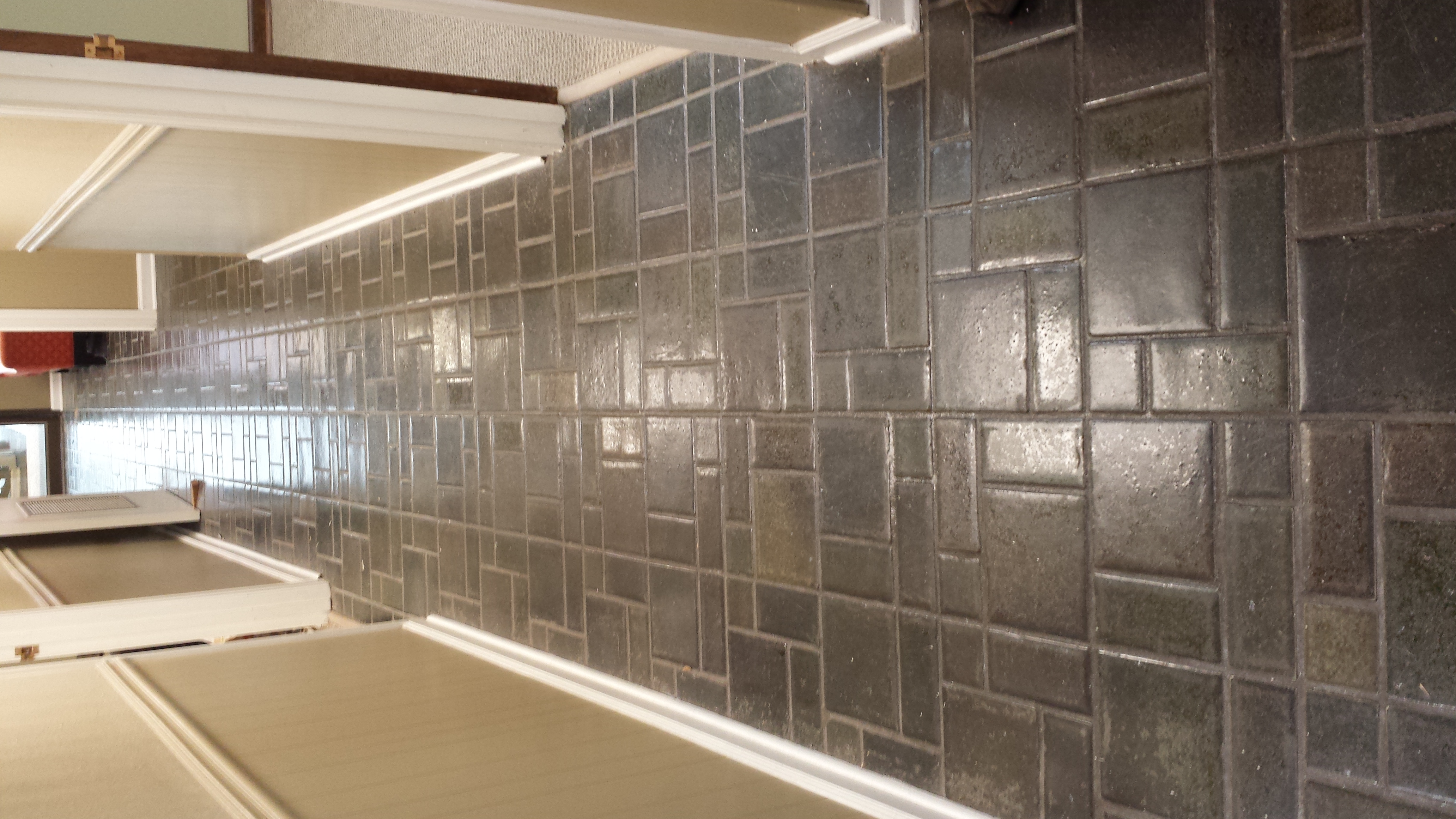

I guess I didn't do something right but that is the floor. As you can tell the floor has a lot of buildup and a hacked out attempt at stripping it years ago with finish applied to the top
The fact that you are talking about Enhancers for that floor tell me you should pass.
Go fishing instead.
Lol. Help a brother out.
116,001
Can't tell in the photos but the grout is shiny, right?
Any chance that is Glaze and Seal or it's equivalent on those tiles? Sure is lumpy and full of crud.
is it that slow there right now? is this your parents house? part of a much bigger job? hot home owner?
What testing have you done so far?
Sep 7, 2008
3,797
Yes but very spotty. It looks like it was stripped but poorly done years ago and then finish mopped on. In the first pic the office had carpet over it for years so it is in great shape. When they pulled the carpet up they mopped finish on it. Looks awesome with the finish on it. I haven't done any testing, but I can test clean. I am going to do a small area and see what happens. My opinion is the floor will be hard to strip. I guess that is why I need to do a test clean.

That's a job. Comes of the tile with the 175 and grit brush. The grout is a whole different story. I will no longer put coatings on tile other than vct. They just blame you later when it looks like crap and is scratched up. If they want shiny then buy shiny tile or get out your visa and buy some stone. Don't fall for it. Go fishing like mike said.

Thats ceramic or porcelain tile. Not made for gloss shine sealer.

Its a brick floor....and is VERY porus. which holds the shit like crazy And will be a bitch to strip....and thats putting it nicely...
Odds are it has either LOTS of coats of finish or a urethane or both..... It will make a aweful sloppy mess, and take about 5 days to do
Looking at the pic of the hall...it appears what ever was put on top, is not bonding with the bottom coat.....
which means 1 of 2 things
Crappy strip job and rinse, like you said
or
different products used for sealer.....and not bonding....
just walk

I would just grab a spray bottle, brush and go test a couple sqr's out.
Sometimes finish comes right off, usually it is a hard job but ya never know.

Doug it's not brick. I offered to do a test clean for 300 dollars in the entry way about 125 sq ft. My supplier was right on without even looking at the floor saying cost should be around 5 dollars per sq ft. I won't be doing the job though at least not anytime soon. I think the owner is going to attempt to do it himself with a mop bucket and a floor buffer. I know it will never look like the room that was covered in carpet for years unless they put a lot of man hours in the job themselves or pay a decent price to get it done.
