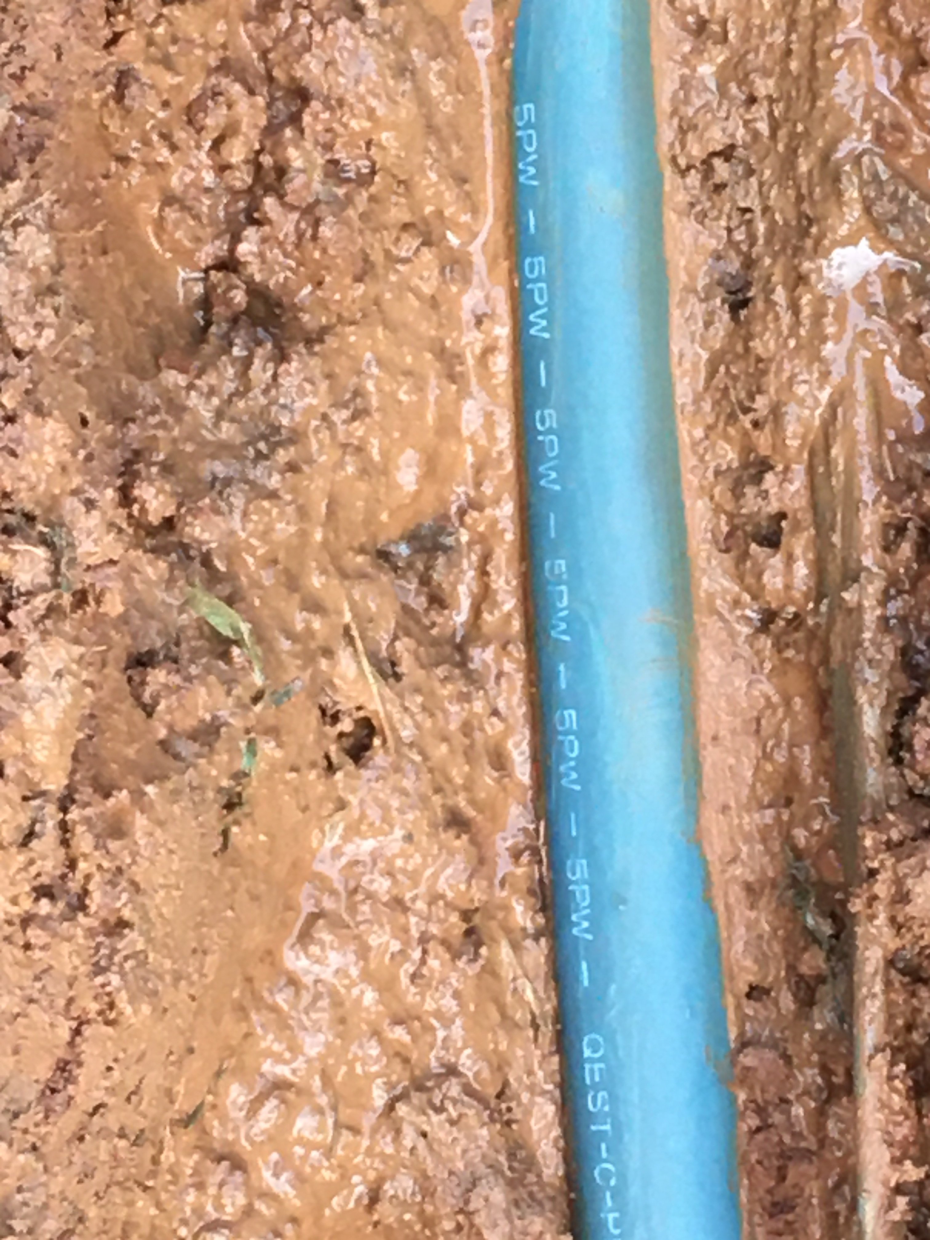

It's just coming straight out of the ground with no casing from what I can tell. Looks like whoever plumbed it did a shitty job. I'll try and take a picture and show you how it looks.

old gray polybutylene
there was a YUGE class action settlement over that crap in the early 90's(?)
One of our accounts owned a dozen new condos plumbed with it.
Right from the get-go they had pipe bursts.
Everyone on the street of the first phase (40 units) were popping pipes
The second and third phase 40+40 units got copper
we were out there a couple times a month to fix broken pipes and dry carpets til they replaced all the plumbing

What is Qest pipe?
Polybutylene (PB) was a plastic manufactured between 1978 and mid-1995 for use as piping in home plumbing systems. ... Pipes made from polybutylene were installed in up to 10 million homes in the Unites States during that period.
lta
14,275
What is Qest pipe?
lta
I was told that was pex. Maybe I was wrong
