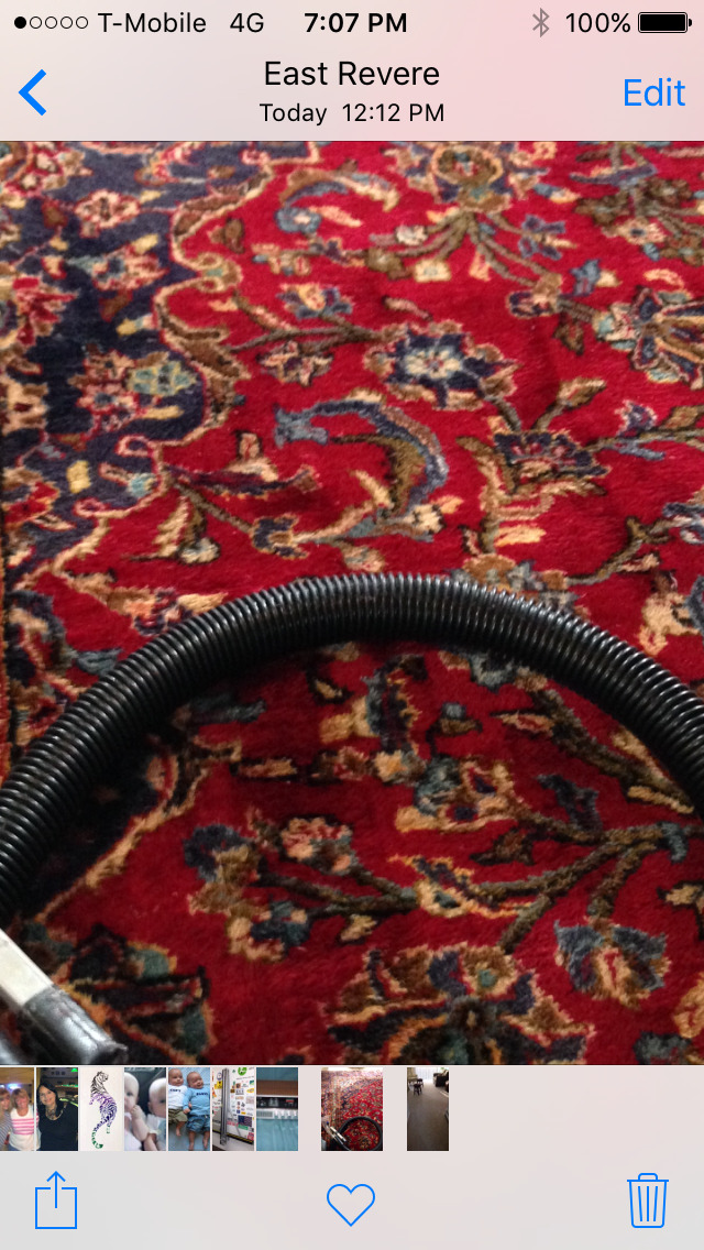

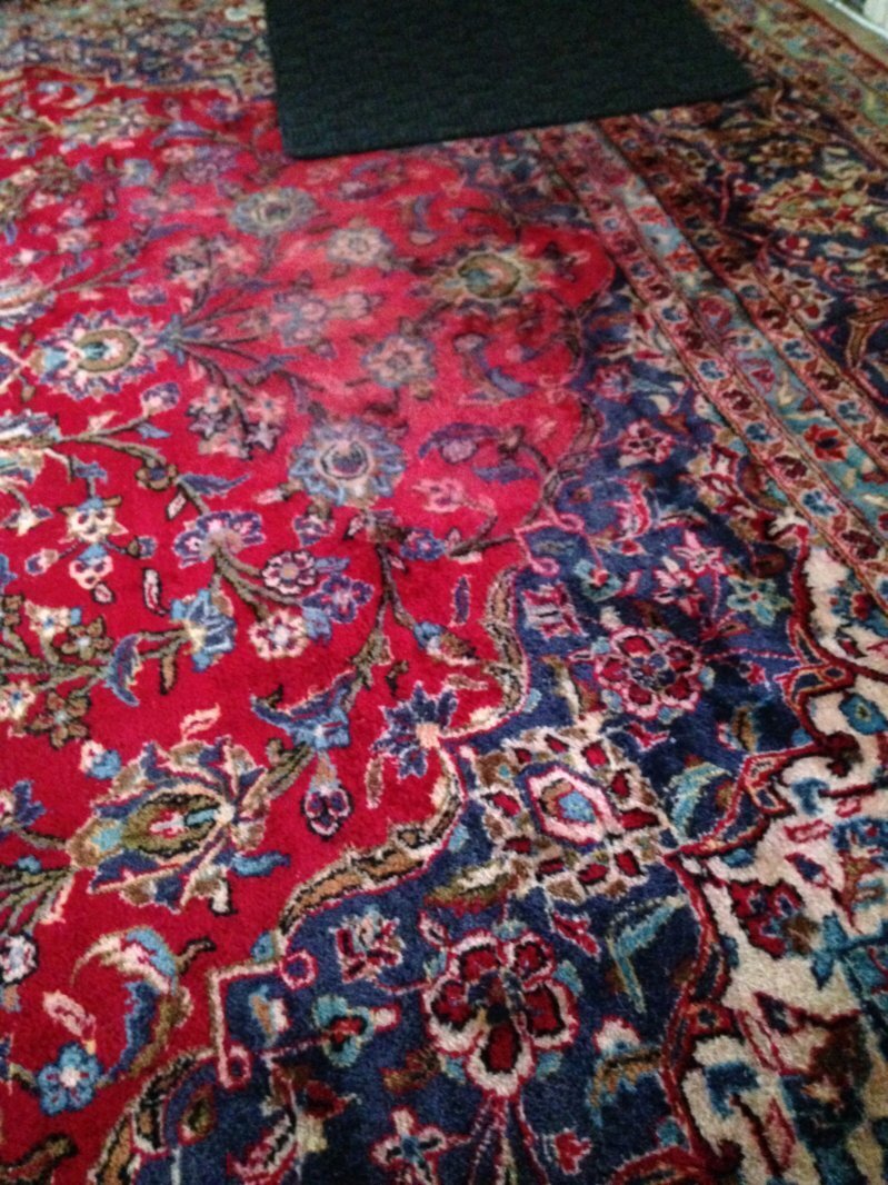

this was a wonderful rug!
The dog had his way with it,
I see the owner attempted to remove the problem and looks like some really bad fugitive color migration, I think I'm in over my head on this one. I would love to just use the
UrineLock™ - Bio Enzyme Odor Encapsulation gallon I won here on the raffle ;)
The color, the odor, the lady, what can I do

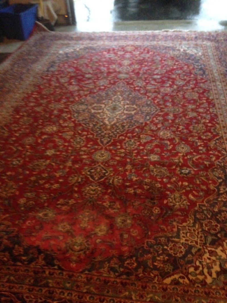

Here I cleaned it with all fiber low ph but its still got problems, some damage on the back. Can I use the edic to inject the bio-enzyme? Can this be repaired? Is it worth it?

There is nothing more you can do. It needs to go to a professional shop for repairs. Up to the owner if it is worth it. Check in your neighborhood if anyone does rug repairs.

What is it worth and are you willing to take responsibility for it? I wouldn't tough it unless the owner has signed off of it as salvage. The urine could have freed up dyes that will migrate when you start cleaning.
Proceed slowly test an area before jumping in fully.

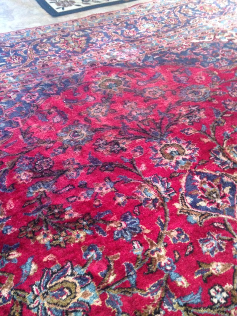

Its getting better, I think I'm going to order some magic dye and stain, I searched and searched for some without $20 shipping, crap it can't cost that much for a small jar, $47
Jondon wants $350 for 12 jars I don't need that much.

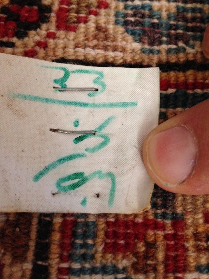

Here is where it's at now, the huge washout is now a small bleeding

The urine caused the migration. This is not a rug to try and fix yourself, even with Magic. It will remove all the colors with out effort if your not careful, and those are some very small areas to be attempting dye correction on for the first time. There are safer ways to strip the colors out of this rug but only by people who are doing this day in and day out. You should skip this trial and error on their rug and take it to BonTon there in Boston and have them correct it. Its not a cheap option, but its cheaper than getting stuck with the cost of replacing that rug. If the customer is blaming you, this will make you shine, rather than causing additional bleaching or damage.

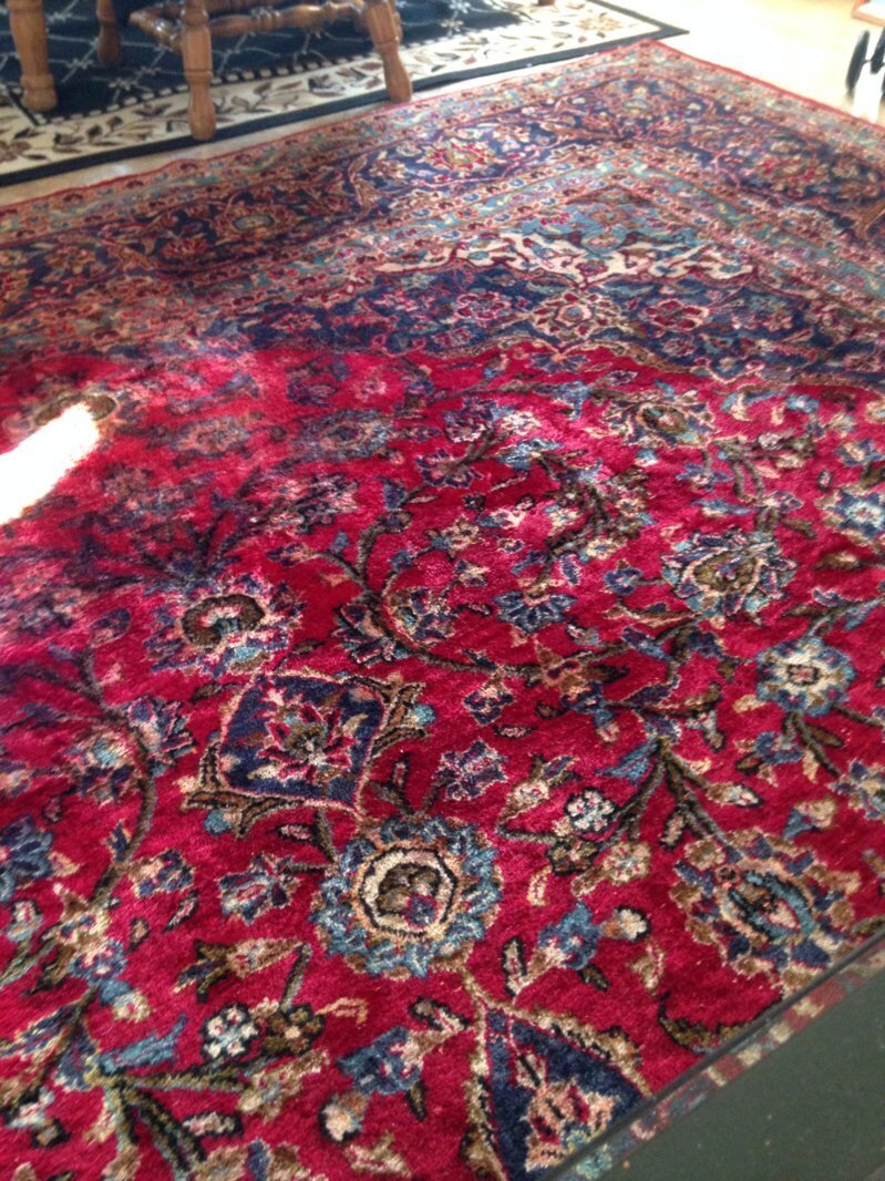

Did the best I could, I see some spots worn thin. How is that repared? Do they weave in new fibers. Or just live with it?

If you can find a rug expert, they weave in new wool. It's becoming a lost art but there are still some people around who know what they are doing.

Depends on the value of the rug. Reweaving can be quite costly, so the typical hand-knotted rug isn't worth repairing this way unless the damage is minor. Although some people are high on hand-coloring to hide wear, others believe it's an unethical practice used only to dupe future rug buyers. As a cleaner, watch out for hand-coloring, as it can easily bleed out and "ruin" a rug.

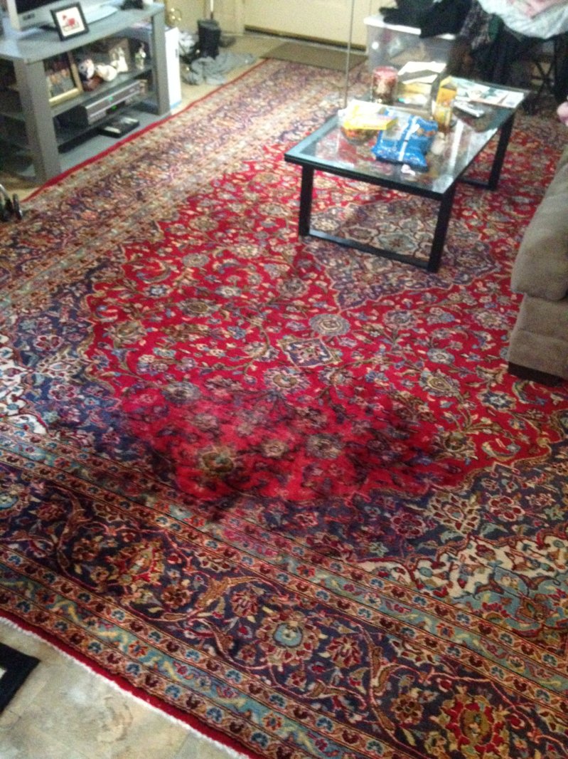

This is the washout, the wool seems crispy, but looks like I got the stink out.
