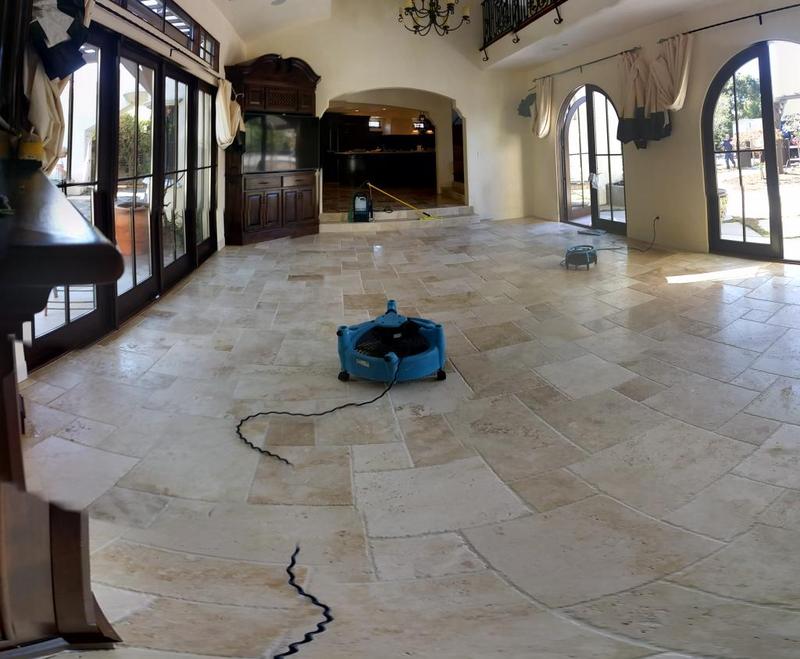

in 3 hours we swept, Flex'd, Turbo'd, Airpath'd, Cobb'd, Airpath'd again and collected a check for $1240..
"just" one buck a foot for clean and seal.
Work smart and fast.

Is it just my screen, or does the airpath cord seem to melt into the floor (which looks superb, by the way)?
I think Scott W's infinite loop thread is causing the space-time continuum to unravel....

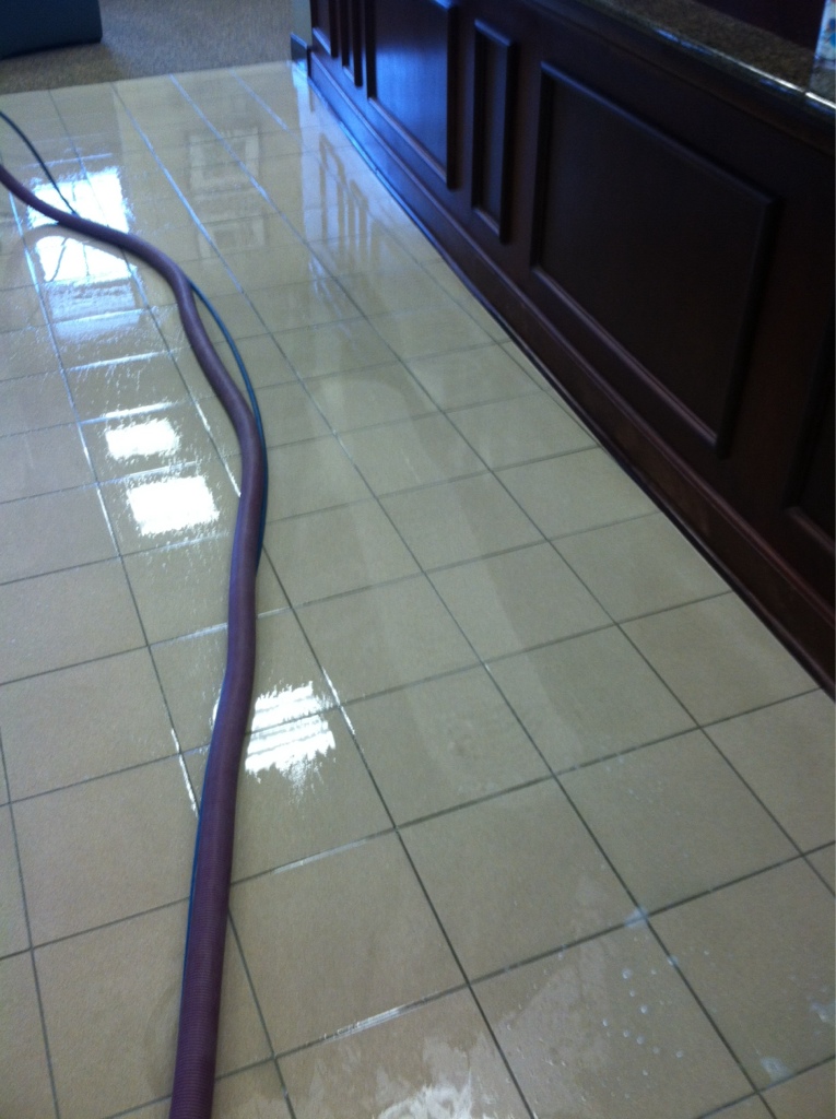

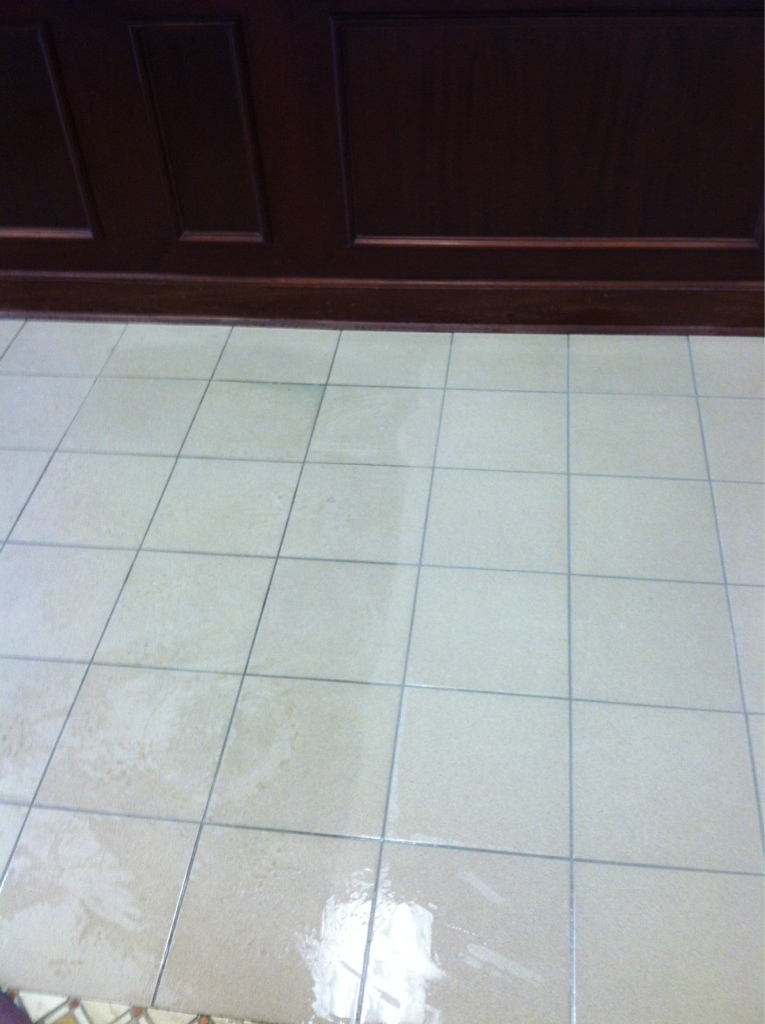

This is a shot of a bank lobby we cleaned this morning. Cobb's PowerMax mixed at 2 oz per gallon in super hot water. Mopped on, a few minutes dwell and then the turbo at 850 psi. No scrubbing.

Some grout just needs to be agitated no matter what nuclear jizz you put on it
Raise your pressure above 1000 or crank the heat and you'll risk cracking joints
