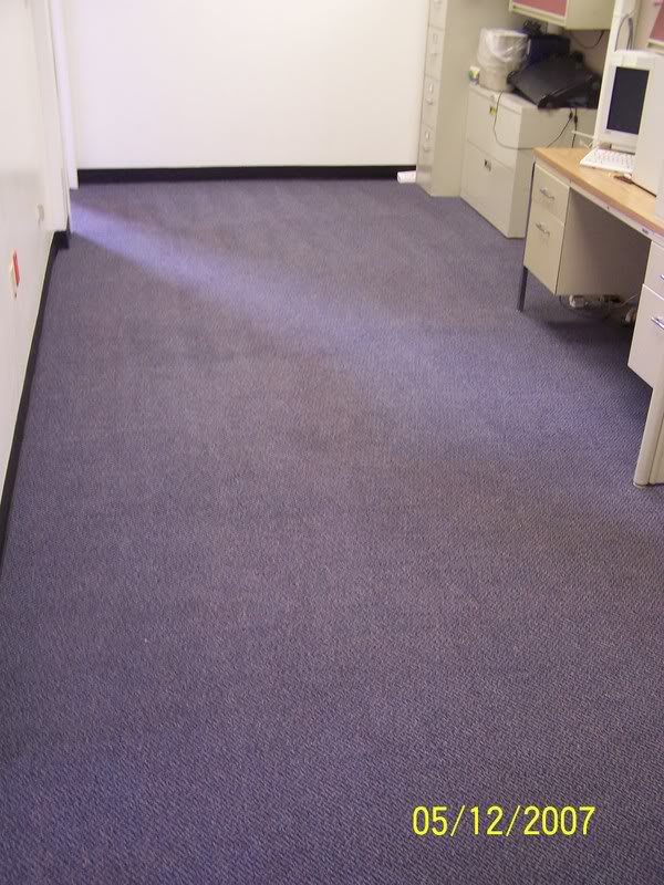

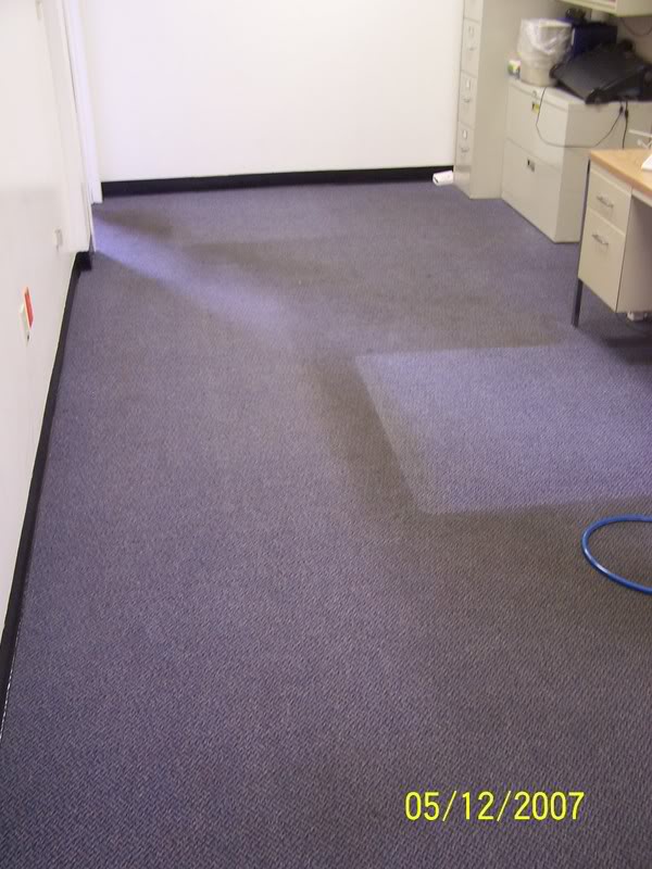

To say an OP machine is useless is ridiculous. I run a good sized TM and have had to drag out the old OP machine a couple of times. The results were FAR superior to either system on its own.
I've used OP and HWE as stand alone systems. Both have their place, but when the carpet is an absolute disaster, it's the only way to get it done. Solid agitation and a great flushing will get more soil out of the carpet ... period.
This was after using Chemeister's grease aggressor with my Thermal Wave.
This was after running the OP over it and just extracting.

I have to agree with Dan
I have a couple of dental offices that I clean the vct floors and carpets every 4 months. I OP cleaned both of them for the first time in the 3+ years I have been doing them. Both carpet are olefin and have a slight sculptured pattern to both of them, one of them is carpet tiles made from recycled pop bottles
Got a call from both office managers saying they never looked so good, I think I will clean them this way all the time
I have a few accounts that I clean quarterly. I know that when I OP clean them it takes a 2 month before the traffic pattern starts to show in the hallways, 1 month after HWE
I think some of you would be surprised to find what is still there in commercial carpet after you HWE clean it no matter how good it looks, even your rat nasty residentials

Dan a degreaser would not be my choice for an office :shock: You have ground in dirt.
Second if you would have prescrubed with a rotary or an op you would have gotten better results with the hwe.
I think it is completely ridiculous to always post the pictures of spray and suck then spray suck and scrub. I wish someone would just once post a pic of a pad scrub followed by a high flow high recovery extraction right smack ass in the middle of the pad scrubbed area. Let it dry and you will see the difference. Of course combination methods will out perform single methods.

Actually, that was grease in the carpet. That door in the back went into an enormous mechanical room that had grease all over the floor. The first pic was pre-spray and extraction. The second was after running OP over it and then extracting.
Unfortunately, I don't have pics to show you what you're talking about. I'll try and get some next time.
