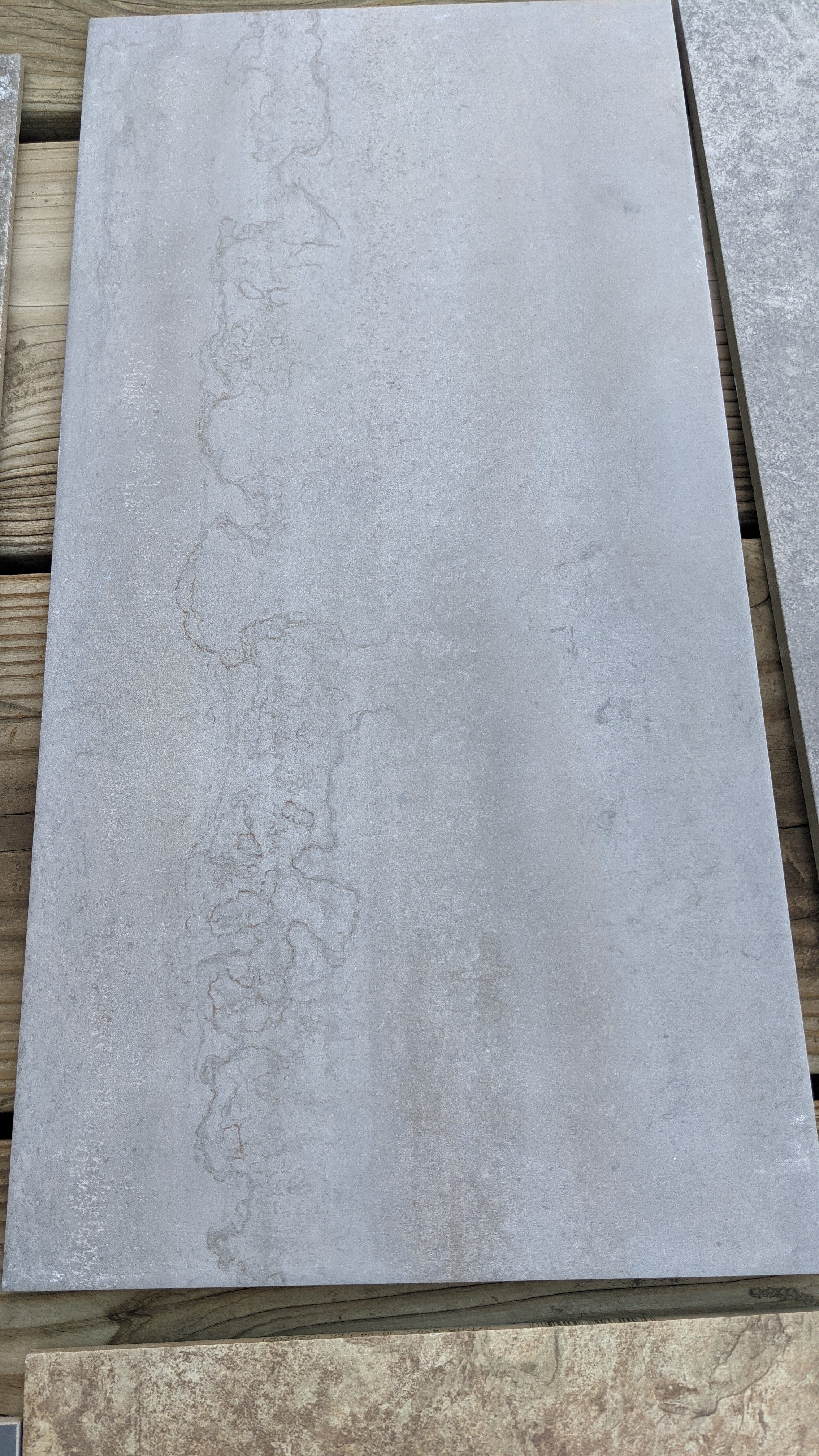

I agree with Mike's answers-Just adding we wanted to find something that would solve the issue of getting a technician off a job when a porcelain tile cleaning job went bad. The products that will be in the kit will be a two step process for honed porcelain and a three step process for polished porcelain. As Mike explained one step used even by hand can repair blemishes while the other steps can remove some lite wear and produce a polish. I agree with you Tom there is more to learn here for sure.

I understand polished porcelain. Honed porcelain is something I have not heard of before your post. Can you explain honed porcelain?
If this phenomenon starts by removing a weak coating then why not fully strip it and apply a better coating that is translucent?

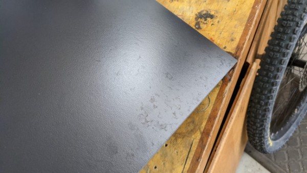

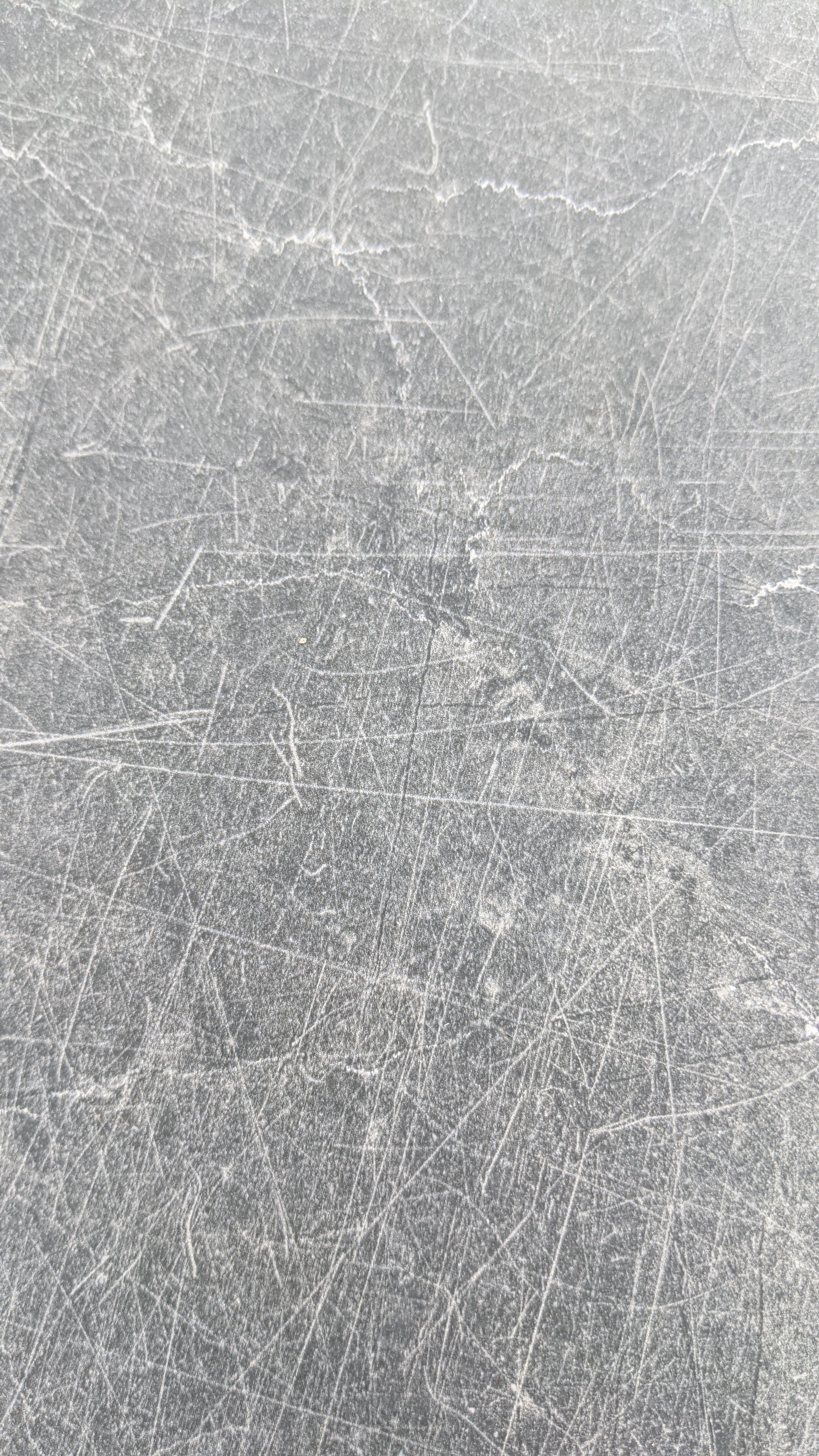

As mentioned, MBStone has created a fix for removing the splotches and light scratches from most every type of modern porcelain.
Small splotches can be removed by hand with just a hogs hair or white pad and a dap of crème, larger areas can be taken care of with a Makita or 175.
It's shocking at how little time is needed to erase the damage. If over worked, you can actually start to remove the glaze AND the photograph.
You and your customers NEED to understand that you are not restoring the glaze or making it more durable, you are simply feathering out the damage so that it's not seen by the human eye.

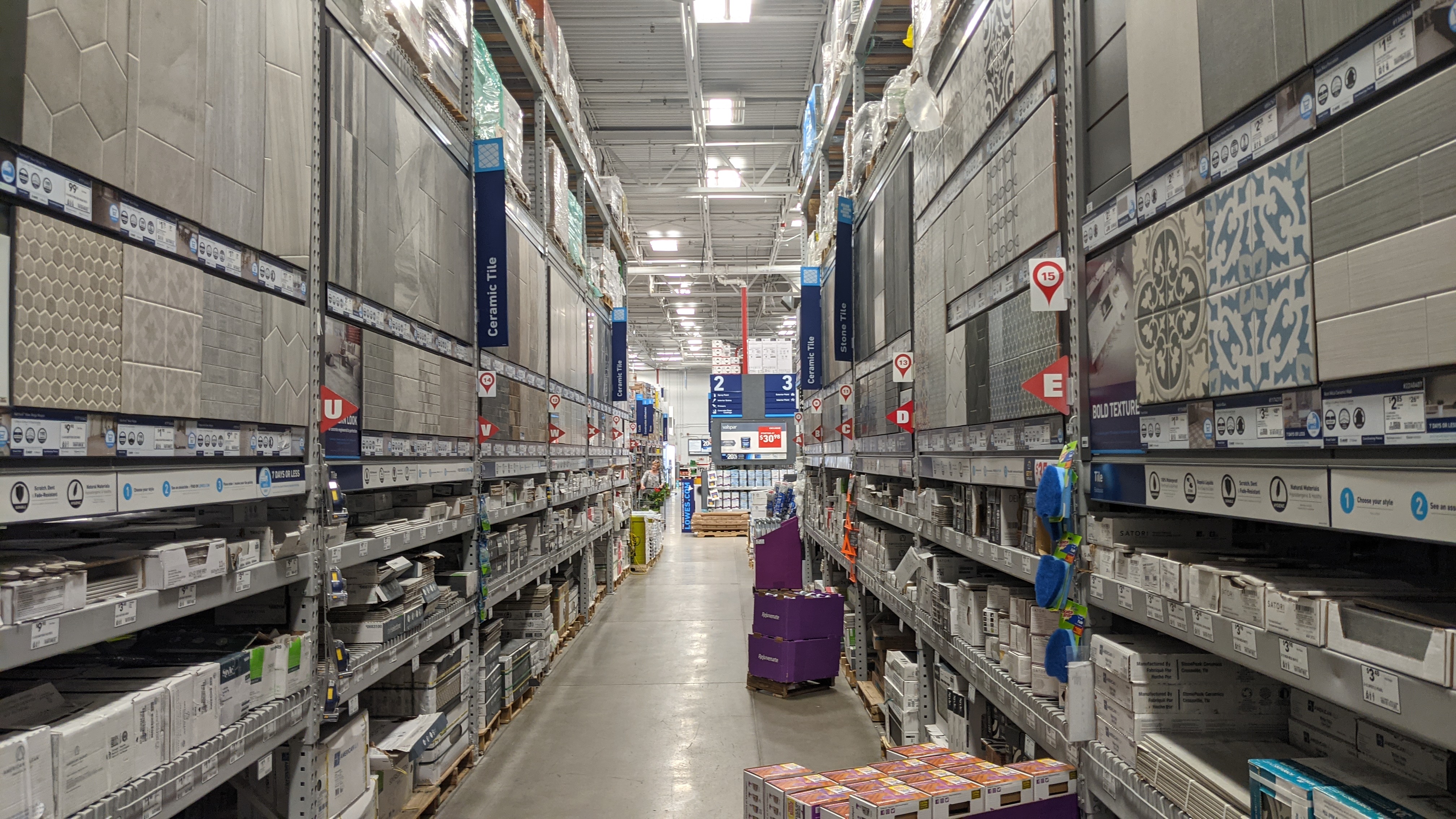

The impact of crap viscose area rugs exists, but as the items are easily disposable, and its a relatively small part of the floor covering industry, probably inconsequential in the world of "big numbers"
But the impact of crap flooring that isn't easily maintainable and isn't easily thrown in a trash dumpster by the owner could have a big impact, especially in the era of social media.
