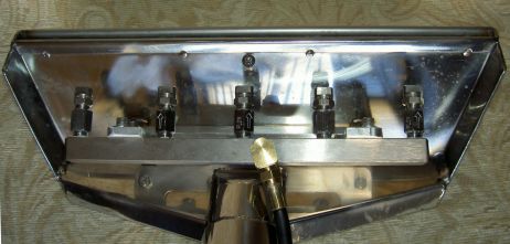

Question ? if a 13.5" Ti. wands needs 7 jets why is Cobb using 4 jets on a 14 wand? I remember Cobb suggesting 5 jets with a 14 wand. Now using 4??
Larry Cobb
5,795
Larry Cobb
Magician;
We have both a 14" 4-Jet and a 2" Tube 5-Jet (shown wo GG):
You can have it your way !
Both of them have more uniform angle-jet spacing than the Titanium.
Larry
