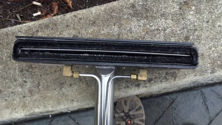

PMF custom made with S bend, extra long and 2 inch adaptor

Potential problem I see with that wand is the head width. I need one that I can get into corners behind toilets and in tight places in small bathrooms and laundry rooms. I don't want a two inch hose connector either. I want to use a 1.5 inch whip. Way too much twisting around corners and tight places with the tile cleaning I do.

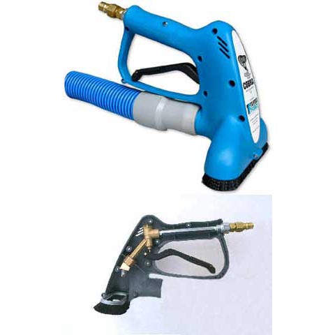

I own the Turbo, hand turbo, cobra, and Gecko with both narrow and wide attachments.....and after 10 years of cleaning tile I use the turbo and literally lift side of it up to get baseboard and edge. If need be in tight areas like the shitter I'll use the cobra. Other than that everything else stays in the truck....for past 6 years or so.

Yes and really all you have to do is scrub with a brush that will get in corners and under the baseboards, and then just tilt the tool and then let the vacuum pull the water back up. For toilets just scrub the area good with grout brush, flood the area with water, and then suck the water up with vac hose. If you want to go all out, wipe the area dry with a towel.
