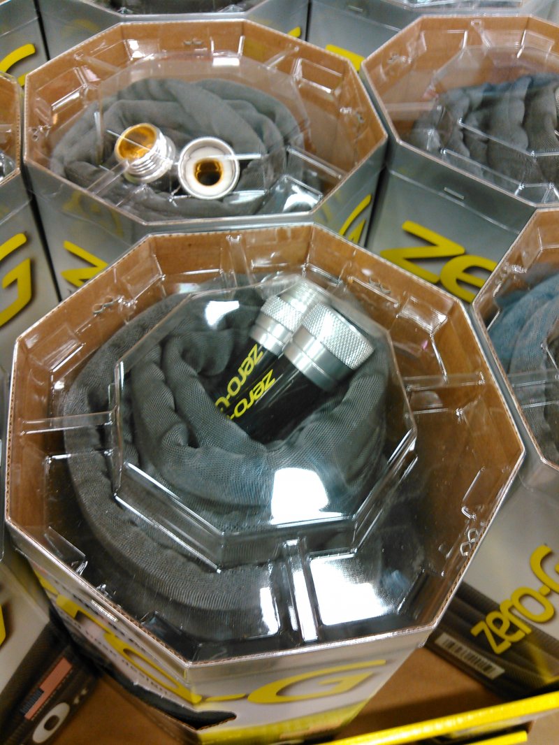

I saw a new hose at Lowe's I want to try. It's a fiber mesh over the vinyl. It collapses for space saving. Looks like a good hose.
