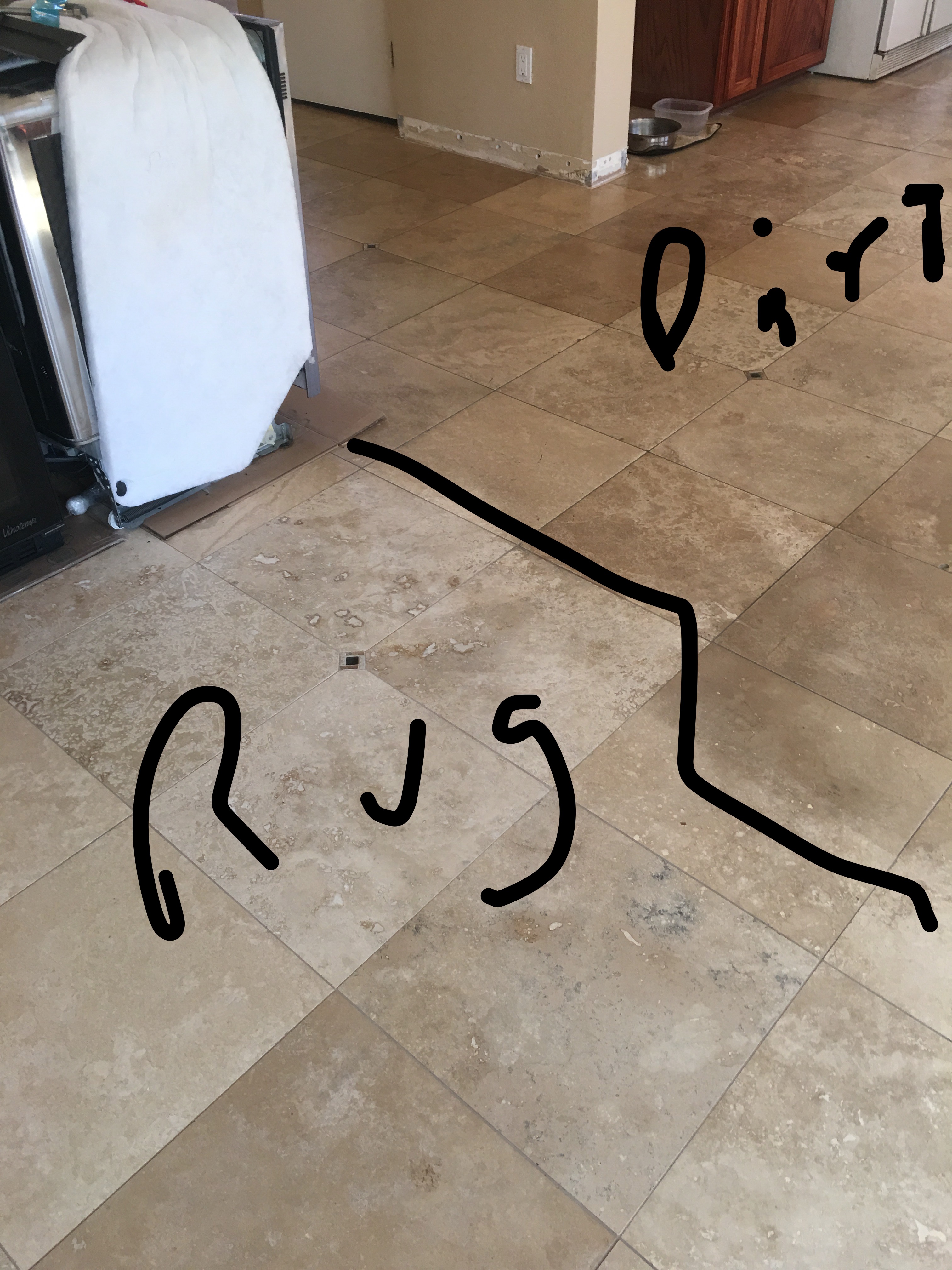

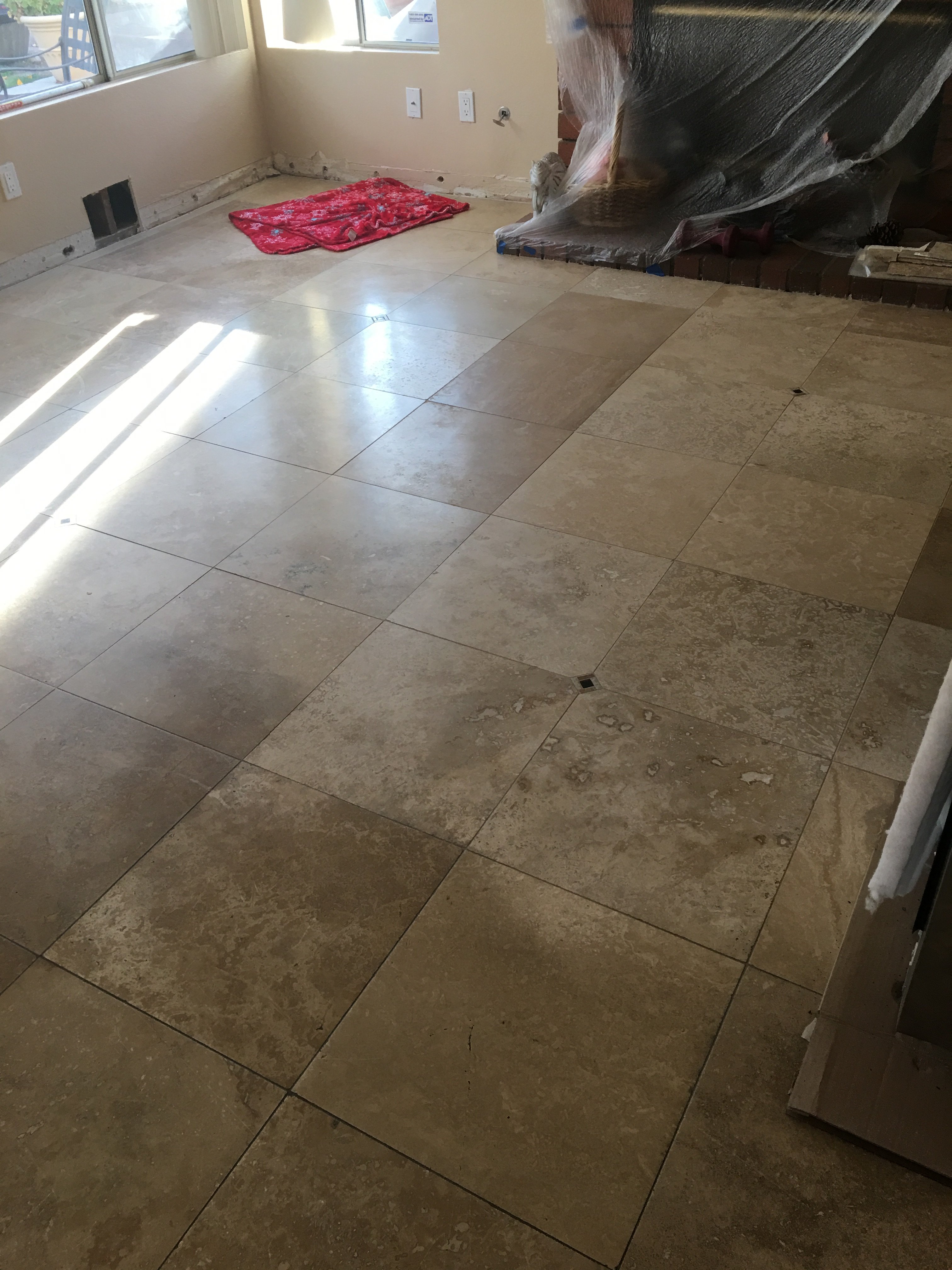

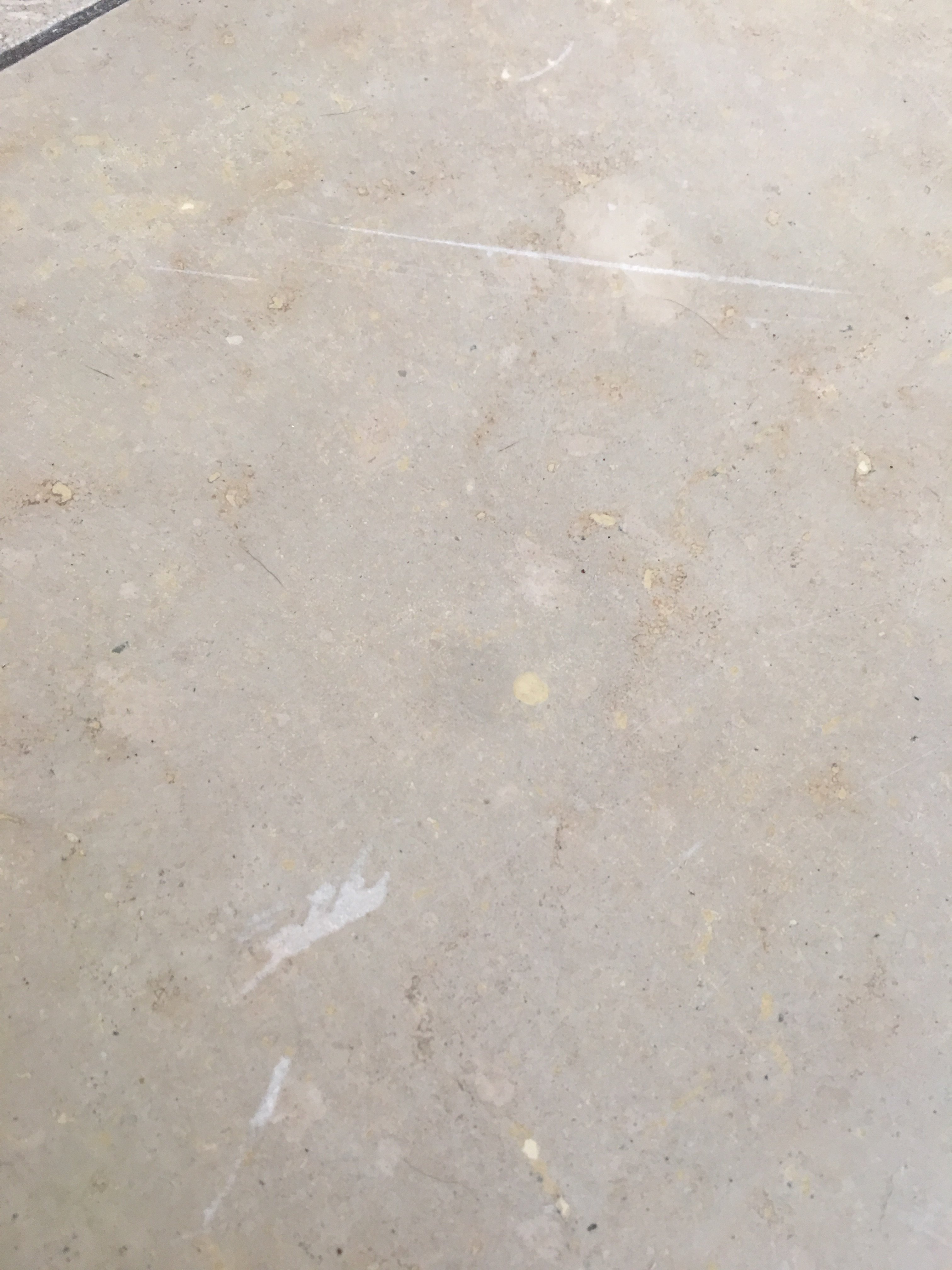

Lady calls and had a flood, everything is dry.
She got a contractor to come in a quote her for new floors, but she wants to try and save money.
The lighter darker area is where a rug was
There also a topical on the flooring to.

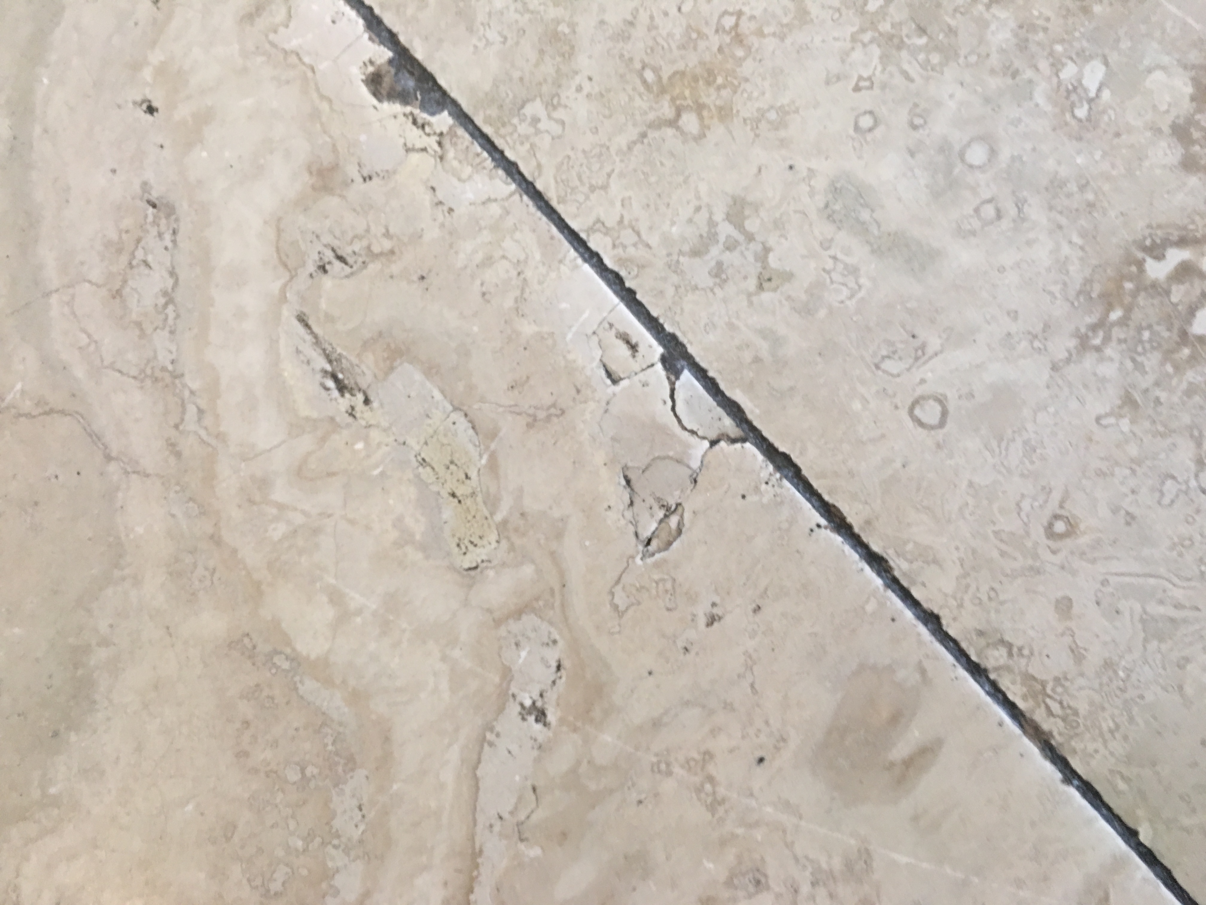

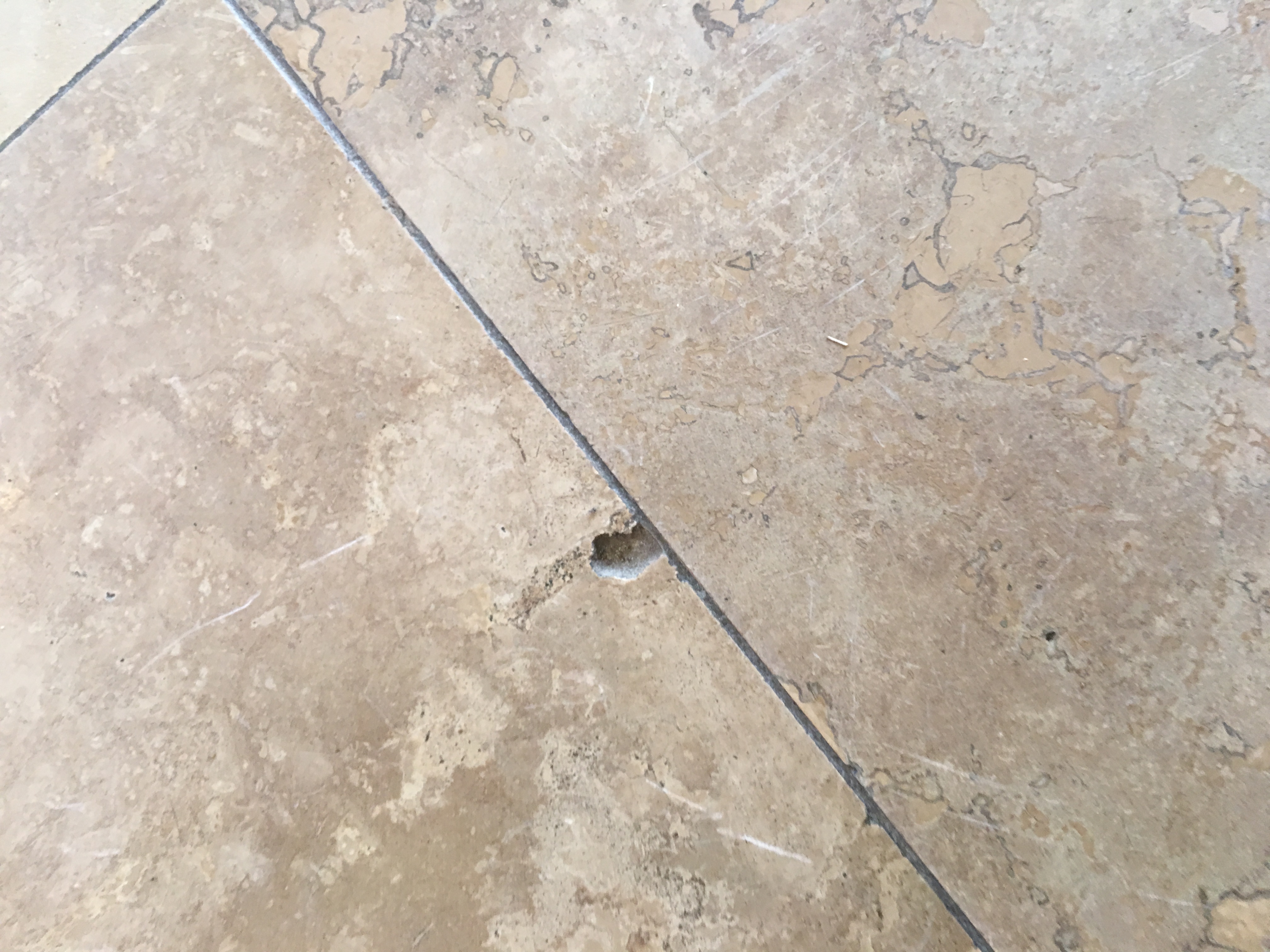

This last picture is where a scratched with
My finger nail and topical peaked off.

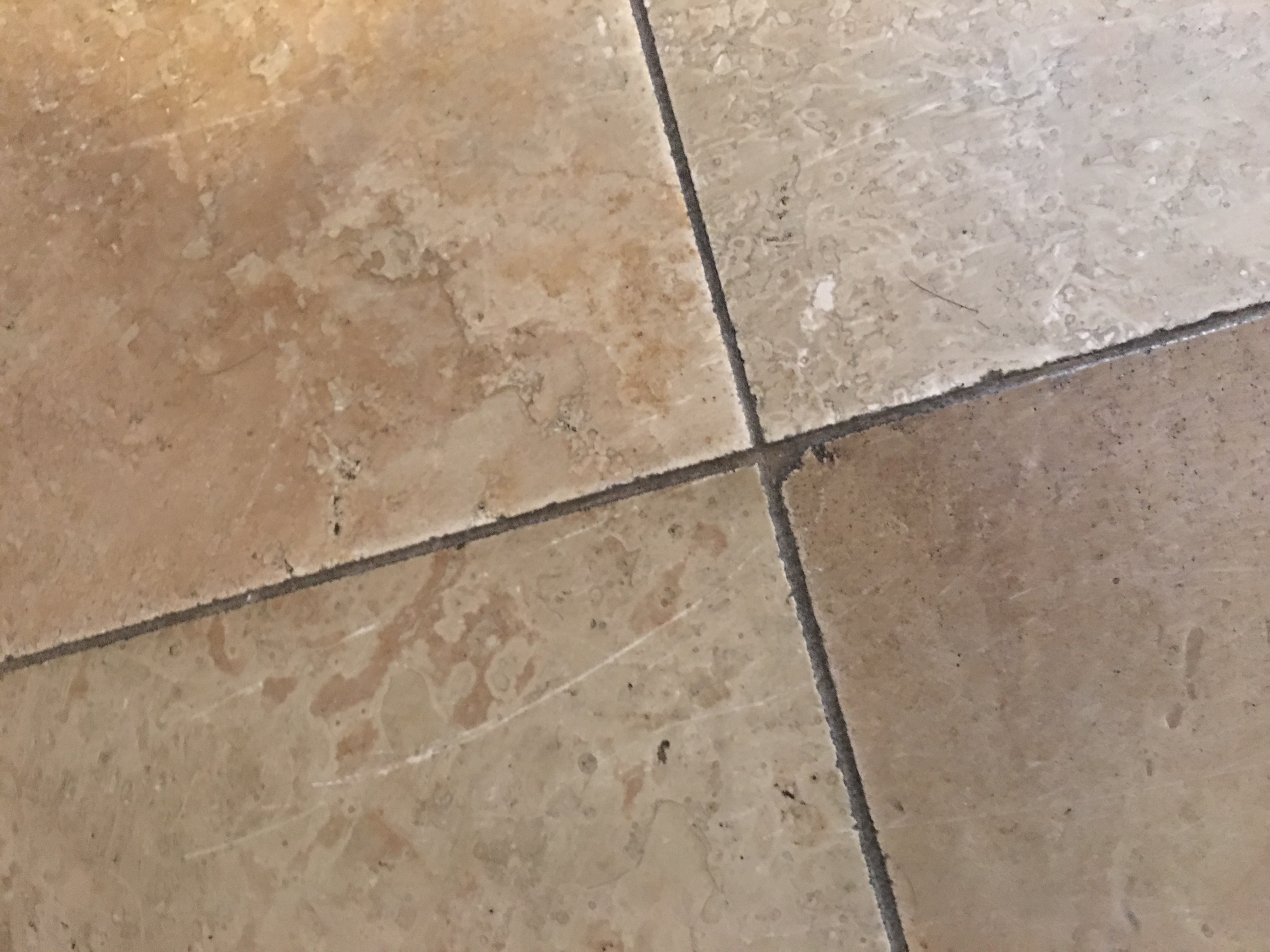

11,302
California
The floor needs repairs and repairs and has scratches that are deeper then the topical.

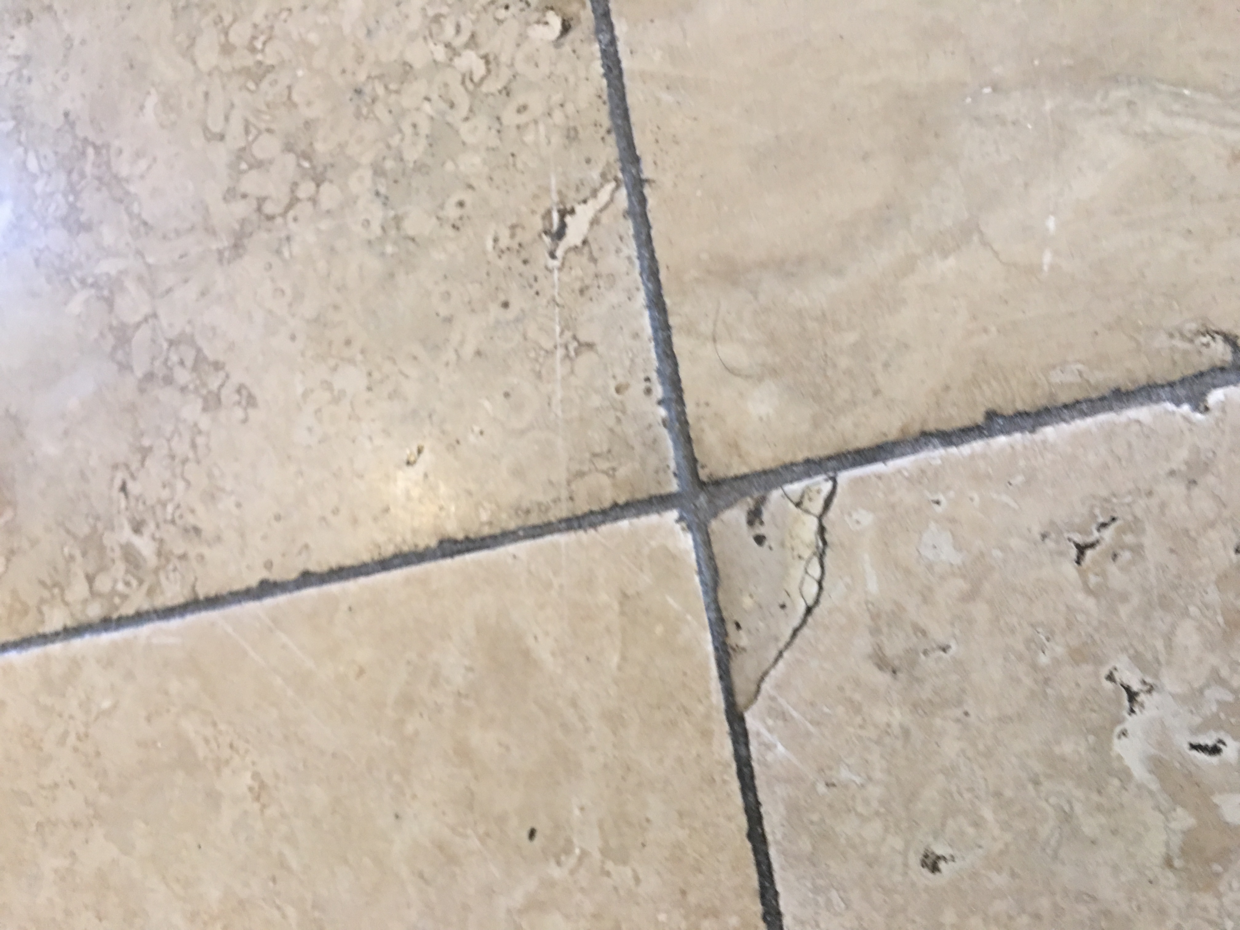

I believe she wants it clean and honed and polished about 600 sq ft. It would need traverfill in some areas.
Not sure about all the chips and cracks.

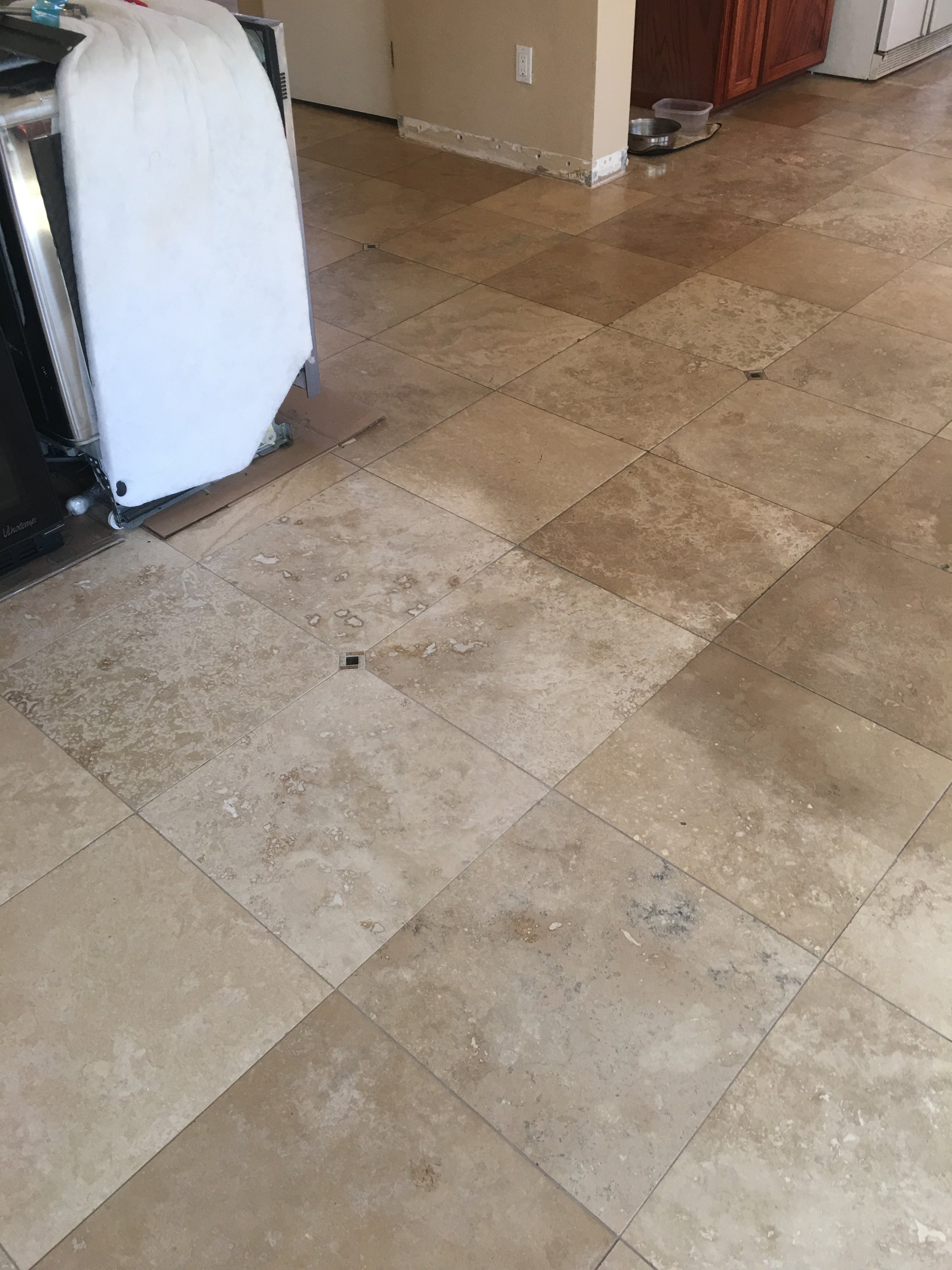

11,302
California
The whitish area are peel one of those I scratched with my thumb and it peeled off.

I'd love to have this job. Seariously. Lots of money to be made there. If it's peeling off with your fingernail...some heavy alkaline solution and a turbo and brushring might be enough to get it off. You might have to do it twice. Then see what the stone looks like under there. Then hone and polish. Ypu'll be doing even better if you can figure out how much they quoted for replacement.
