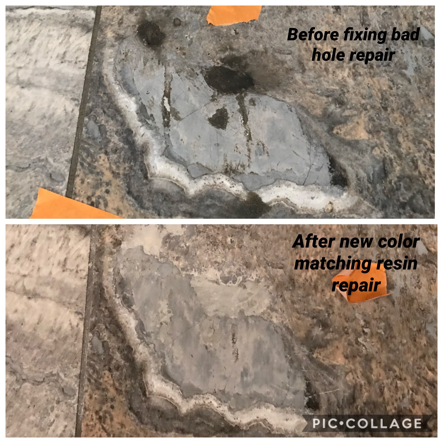

A previous stone company tried to repair holes in this Turkish Travertine. The customer was extremely disappointed with their attempt at filling the holes. I removed the old sanded silicone grout repair (dark brown spots) and filled with them with Tennax polyester resin and added colored tint to better match the surrounding stone.
Learning how to do quality repairs will set you apart from your competition.
This travertine is no longer available as the quarry has shut down / run out of stone.....so the customer was relieved and extremely happy with the repairs.
