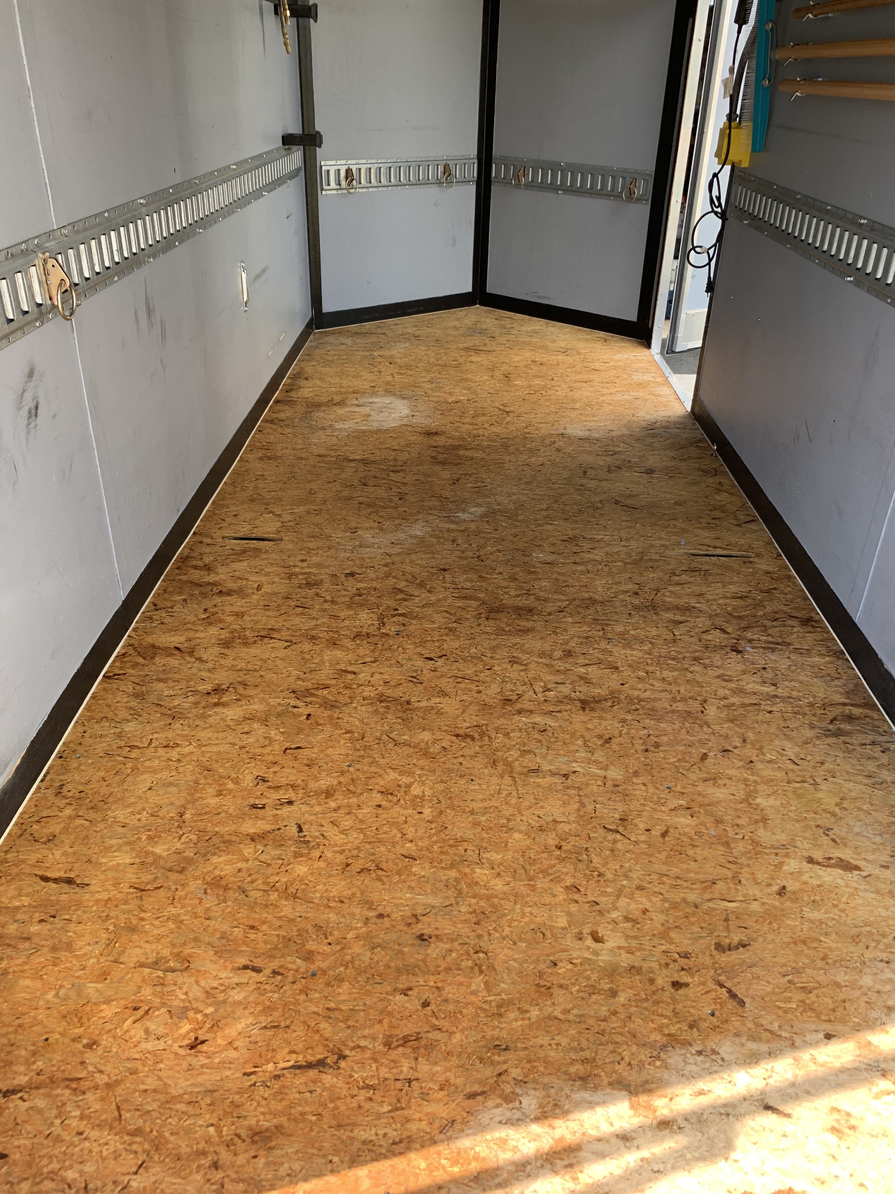

Good afternoon cleaners, I’m looking for some help. I’m mounting a truck mount in a 5x12 enclosed trailer. I can’t afford a van yet, so this is my option. My question is, what layout has worked best for you, and things you’d change. My machine will sit centered facing the rear. If you have pictures of your set up I’d be grateful. Thank you for the help.

I’m pulling it with a Toyota 4Runner and I have painted the floor, that was an old pic. So It would be better to mount the machine coming out the side door and hoses out the back? The problem is that the door is pretty far forward and that will put a ton of tung weight.

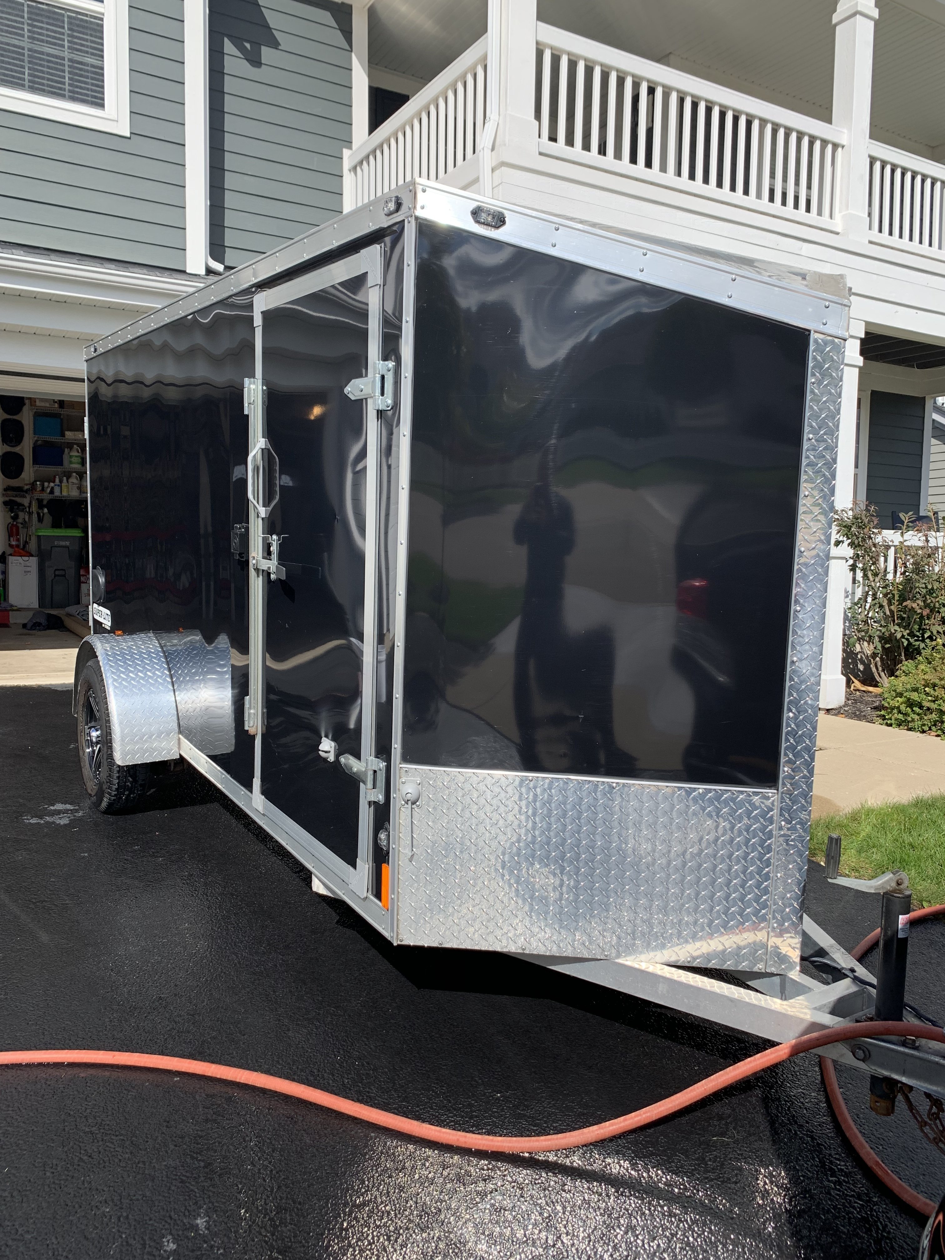

This is my trailer setup. I wish my machine was mounted out the side door and that I had a rear ramp instead of barn doors. Not sure what your climate is but insulate it if it's cold in your area. I also like this setup for my exhaust. I can leave it run with the doors closed if it's super cold but when I have it shut down I can just close up the exhaust hole and not worry about cold air going up the exhaust and freezing my heat exchanger. I hope this will give you some ideas! Nothing more exciting than finally pulling the trigger and getting your setup put together!
