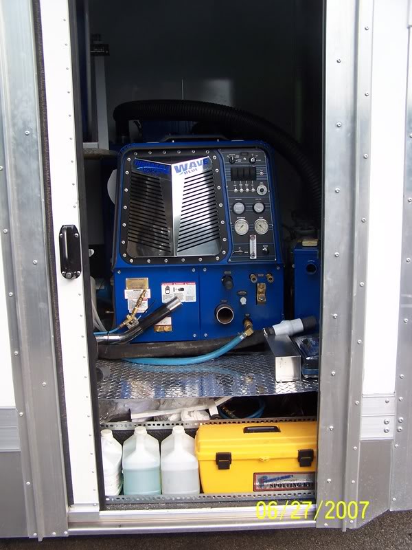

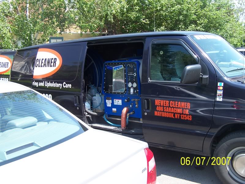

I looked at Billy's econoline and I liked the way he had the hose reel and the tm out the side door. I like that it will leave the back completely open. I have a project now for christmas break. Billy did you like it that way?????

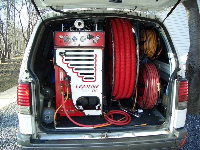

Doug Cox said:
In what world are you going to fit a TM AND a hose real next to each in the rear of a van. I want to see that happen.
Rear for me, and to answer your question, it can happen.

Thanks we used it that way first without the sub mount water tank then with a side mount water tank & finally with the custom designed & made sub mount water tank.
It has been great to work out of I designed it the way I did so that I could have as much usable space as possible. I also wanted to cary allot of hose, equipment etc.
One note it isn't a standard E250 it has had suspension work done due to an unscrupulous salesman telling me it was more than enough before I knew anything about vans.
If you have any questions or need any help with it just let me know or feel free to give me a call. If you decide to go this way you will like it allot. Very easy to work out of for a van setup.
