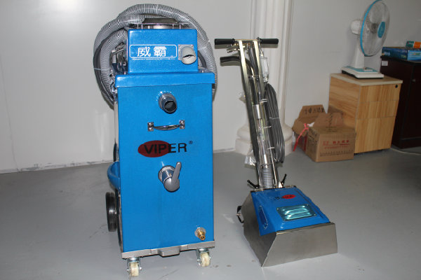

Wish they still made this machine... the Vanmar is the closest I could find. The Floor tool plugs into the main cleaning unit... not the wall. Which was my original point... they should have a place to plug in a floor tool like a 360i. No swirls and the floor with this tool. Built like a tank... notice the big, thick clear tube running up the handle. Great!
cleans great...but it's a drag tool... :neutral:

Bob, you can't believe what you see in a manufacturers video. That particular machine appears to have only 1 vacuum motor. Will it work? Yes, of course. Will it work good enough to give you acceptable drying times? Probably not. Talk to guys using the same tool on their truck mounts and then compare to what you will get on a 1 vac portable. That Vibra Vac in the picture is still being sold in China. They have a 2 vac motor version using 2 inch plumbing just like the old ones. Although the drag tool may be slower than a wand, it will, imo, clean as well or better than a rotary tool. I used to have the old 12 inch single handle version until it rusted out. The new one is 16 inches and stainless steel. I am really tempted to buy just the powerwand.
My old one was 16 inches and the other one I owned was a 12 inch. I only used the 16 inch (Employees used 12 inch)and it was pretty productive with a helper running back and forth carrying clean water buckets and emptying the dirty water. I really liked the form factor...essentially two hand trucks. Easy to maneuver and take up stairs.
Since I only break a portable out when I have a condo on the upper floor of a high rise or some ridiculously long run for a small job I really would love to find one. The VanMar floor tool is an exact copy except color. They didn't even know they knocked off the original Vibra Vac Rug Doctor. Would love to get one from China in the metal flake glitter blue and chrome. Would thing the Floor tool with different jets and valve would work with truck mounts too.
Maybe someone should engineer a RE that worked with a portable as SS claims in video. Would be a good machine.
28,268
for a modern Vibra Vac, check out icecompanies.com To use it with a tm, you would have to modify the valves and hoses for high pressure and heat but it could be done. Look at the way the jets shear across the carpet. I remember mine was so easy to tilt up on the rear wheels and push forward and when pulling it back you would just put a slight upward pressure, just enough to keep the head sealed on the carpet. With that brush swinging a 2,800 times a minute, you know it's digging up dirt. The original rotovac 360 had a 1 1/2 inch tube and would work not too bad on even a basic portable but all the new ones have 2 inch plumbing. It doesn't make sense to attach a 1 1/2 inch hose to it. The dual motor old rotovac dhx would also work on a basic portable. I'm not sure if they still make those. I have several portables, some basic and some that are high performance. I had to use my basic 2-2stage portable the other day because of a lack of power available and even with just a 4 flow wand, I feel that I am overwetting the carpets. I spent a lot of time doing dry passes. When I use my high performance portable, I clean just like my tm except, I have to fill and empty it.
