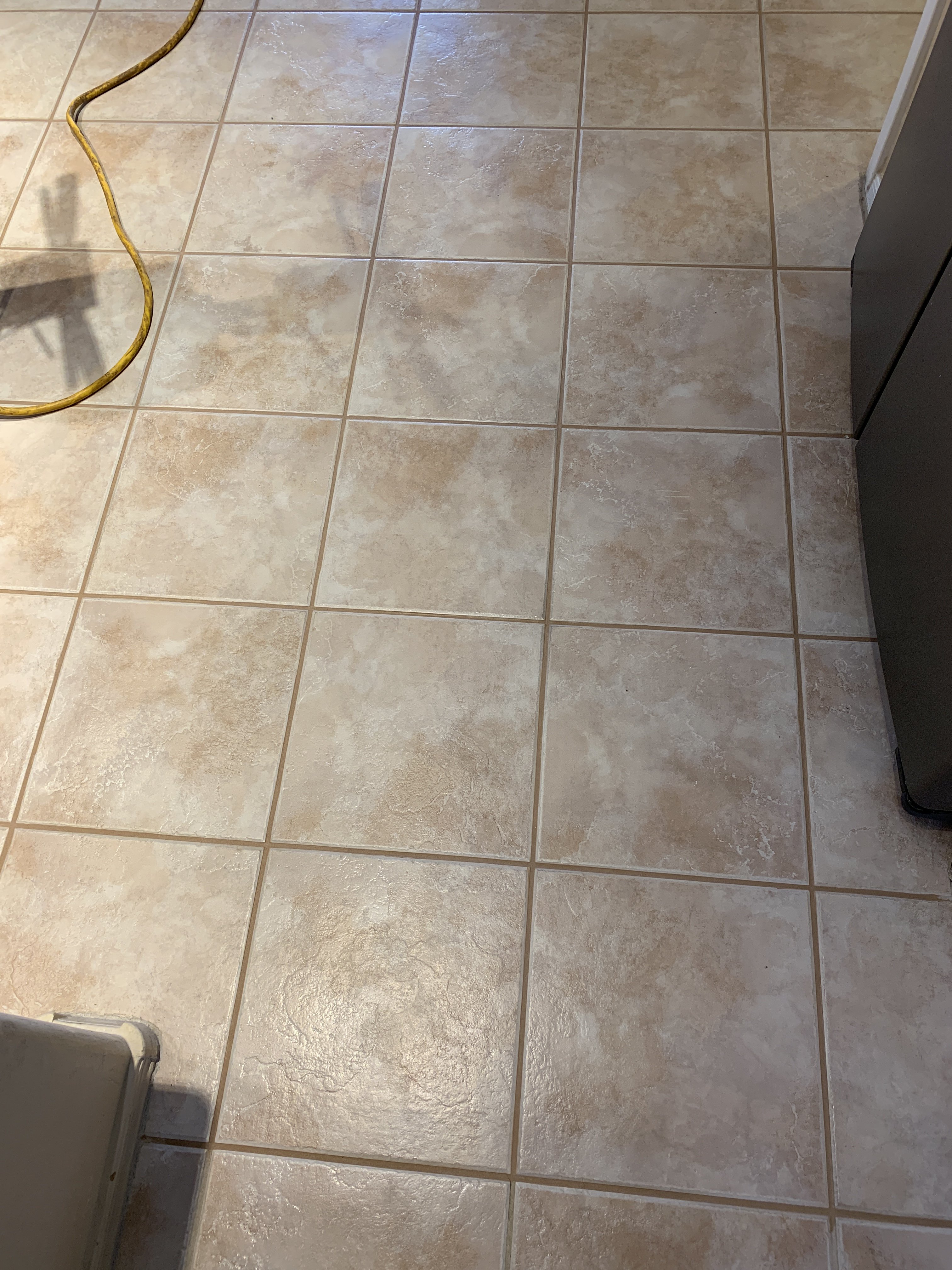

Just tried these turbo seal. Made color sealing much easier, anyone that has color seal jobs coming up I recommend buying.

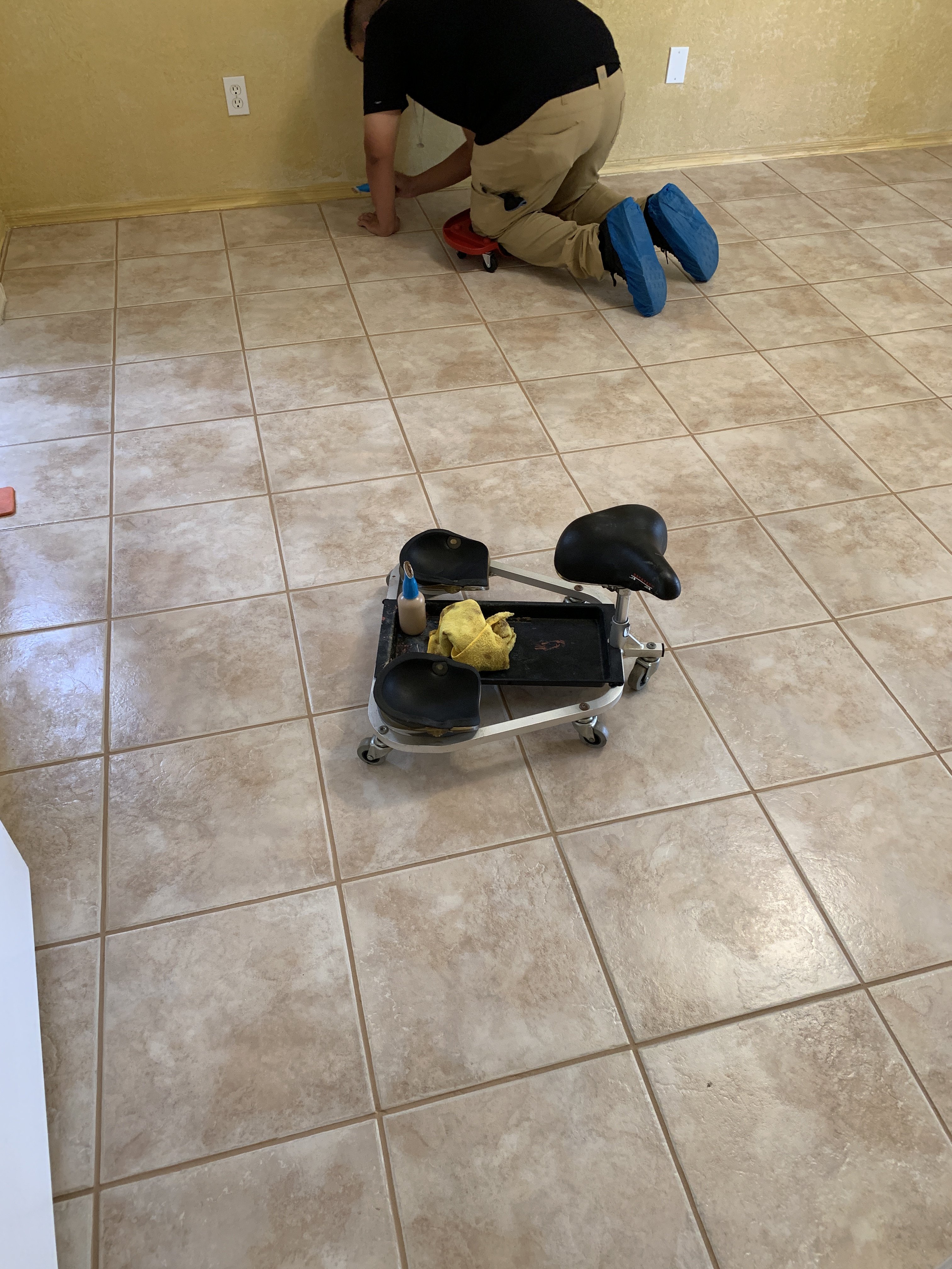

We use Turbo-seal ONLY. It is the best color seal and their applicator makes color sealing a breeze compared to other methods. Plus, there is no wasted product when using the turbo-seal brush & bottle applicator. Turbo-Seal has absolutely transformed my business!!
