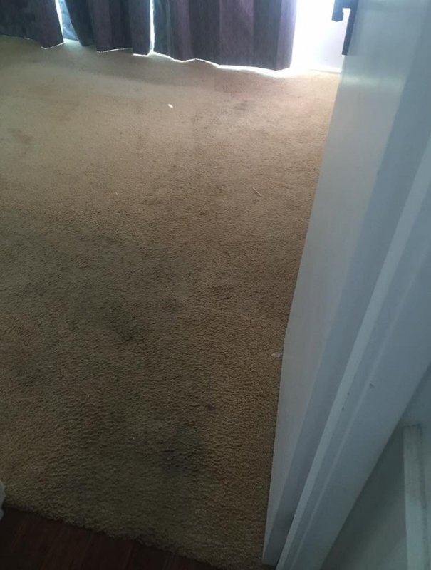

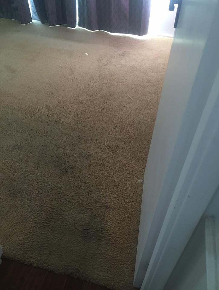

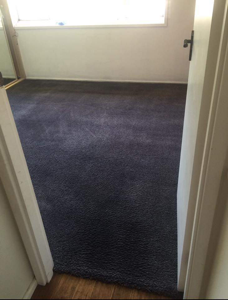

Check out this ugly carpet that one of my trainees just made look beautiful. Very proud of him.

If the carpet is very dirty then we will pre-clean it. Most of the time this is not necessary as our process will clean and dye the carpet in one step.
The carpet can be immediately cleaned by any any method with no color loss whatsoever.

We have a cleaning agent added to the dye solution. The dye is applied, carpet is then agitated, and followed up with extraction which removes any soiling that's in the carpet. Carpet is left clean with a brand-new color that's guaranteed permanent and colorfast for the life of the carpet.

It looks like the first pic but purple now. I think there is definitely a place for fixing bleach spots, etc., but that whole room looks like crap. I've seen your work on other posts and I have been impressed on most. These pics, not so much.

It's not my work. It's someone in Australia. This is one of his first jobs. All things considered, he did a very good job. More importantly, his customer was happy. That's all that matters.

Good grief - the dyes didn't strike evenly at all. Blotchy as heck. Do you use heat as a component to set the dye (hint- it sets more evenly at over 130)? Beauty is in the eye of the beholder I guess. Yes I'm a critic, but don't show a turd and claim it's an O'Henry.:eekk::stir:

Come on guys, be fair.
There was more light in second picture and some of the color variation is light reflection due to nap reversal.
