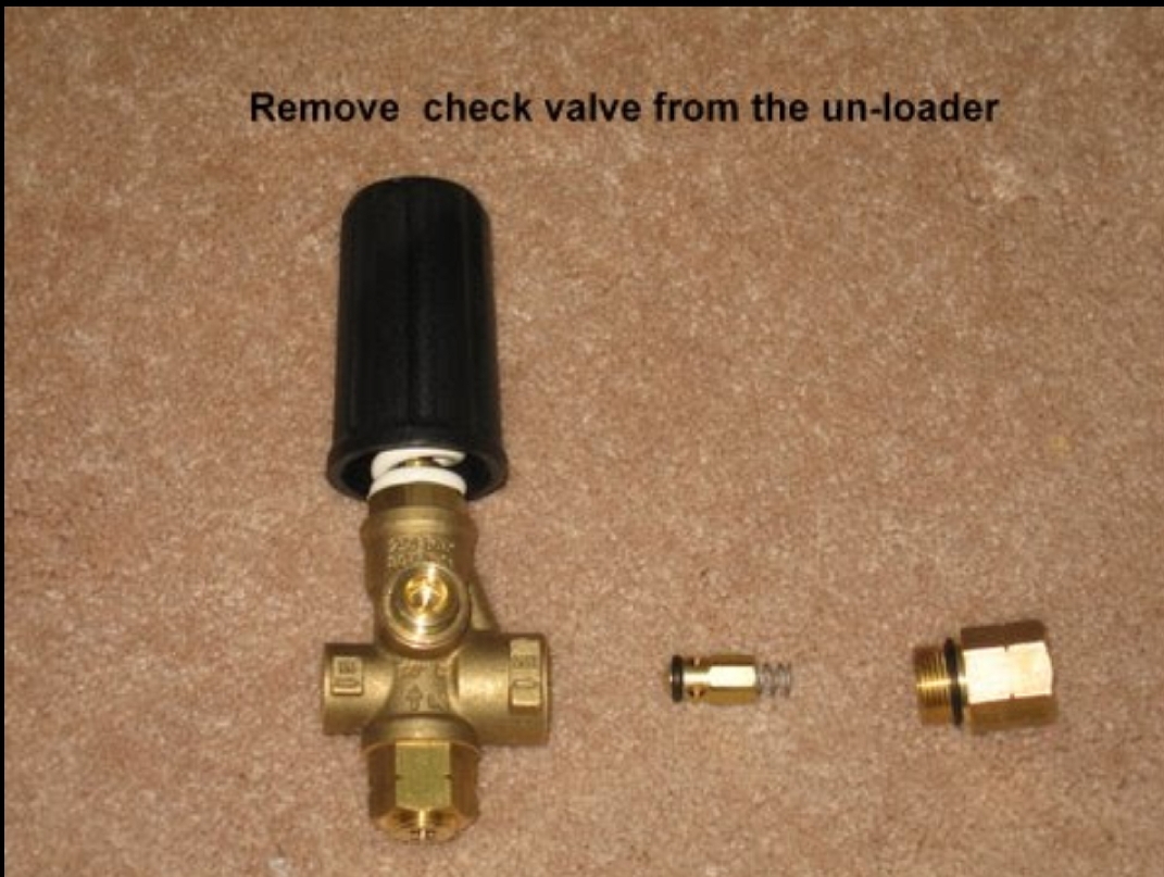

Im replacing the pump and pressure regulator on my back up unit. Spitfire 23 with a 45 roots. Do I need to take the check valve out of the new unloader?
Jim Martin
10,878
Arizona
Jim Martin
Yes...if it is being used as a unloader.... Check the old one and see if it has been removed.. Then you know for sure..
