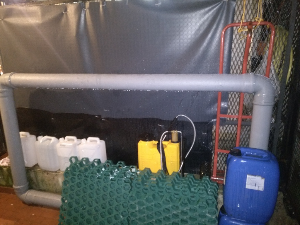

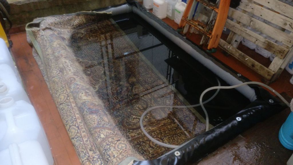

Work in Progress.................
Sergio
Mar 26, 2017
154
Italy
Sergio
At this moment I have soaked the carpet with acid water. How long do I leave him soaked?
After the soaking, what am I going to do?
Thanks!!!
