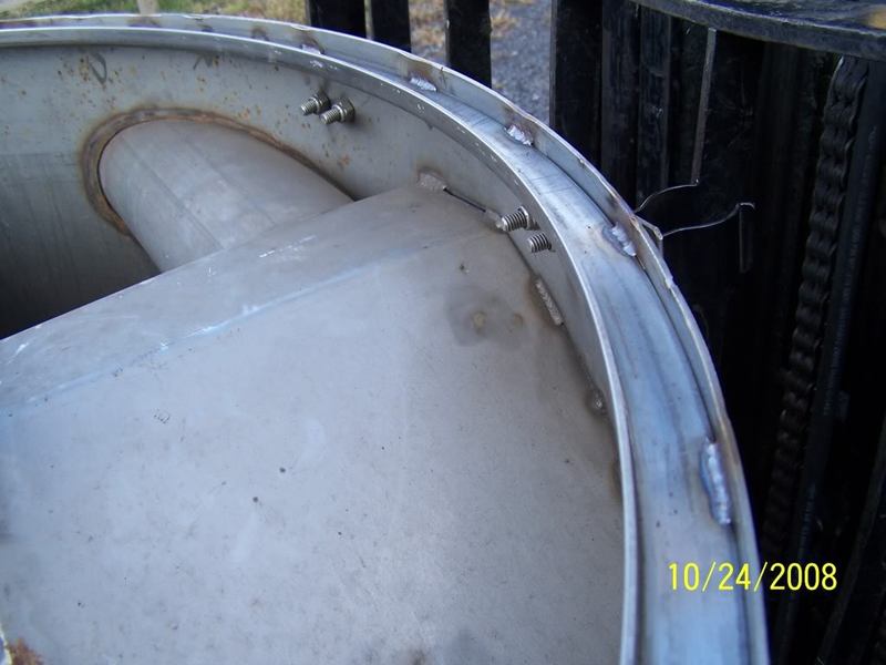

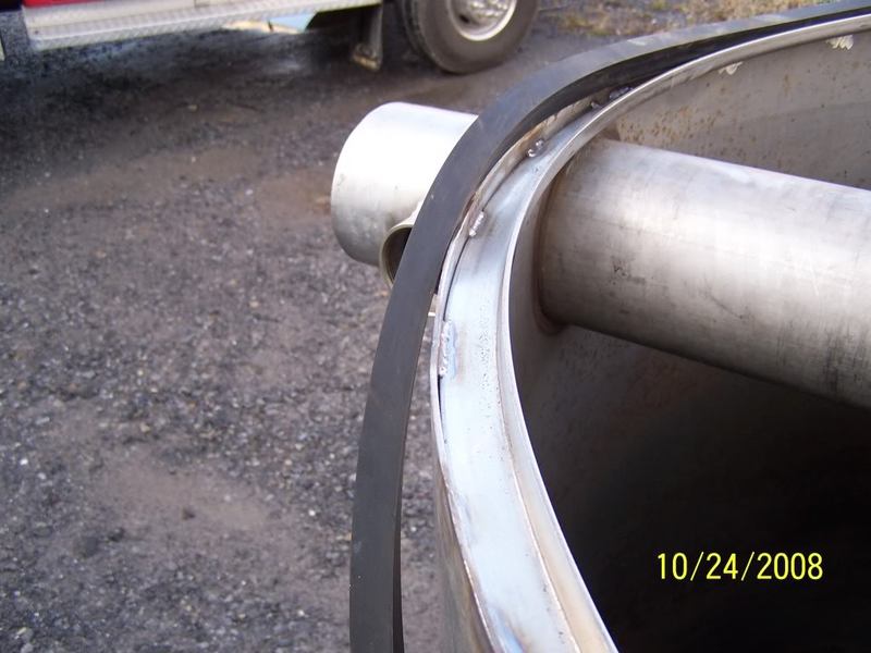

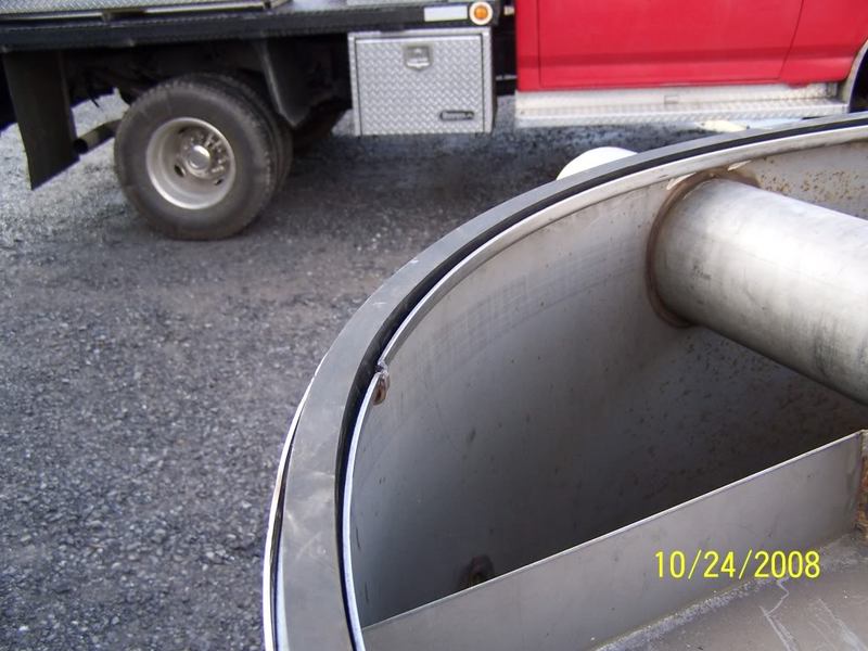

Mike, there is a new gasket design from vortex. I have been using a new tank with a new extruded neoprene gasket that was made last month. I think it will solve the gasket problem once and for all. I installed a tank this morning that my welder retrofitted with the new system. I will post photos if you could help me with Photobucket. :wink:

Mike, look at the pictures I posted about half way down the posts.

Ron's tank mod is awesome, If you have a decent fabricator in your area, it would be worth having that L channel bent and welded in, that closed cell dense rubber is gonna outlast everything I've seen to date, there is nothiing to cut, the flat of the lid mates against the flat of the channel/gasket.
Did Ron say that BLUEline was doing this NOW? Then you could order the ring and have it welded in locally, like my Reel Splitter.

Yes Ron helped us with the perfect fix.
ronbeatty
Nov 16, 2006
1,439
Ron Beatty
I talked to Chuck on Friday, He told me that he would have the rings and gaskets in stock for existing customer as an upgrade. This repair will take about 4 hours to complete. Once it is done it won't have to be done again. :lol: And by the way Adam and all the people at Blueline really stand behind everything they sell. !!!!!!!!!!

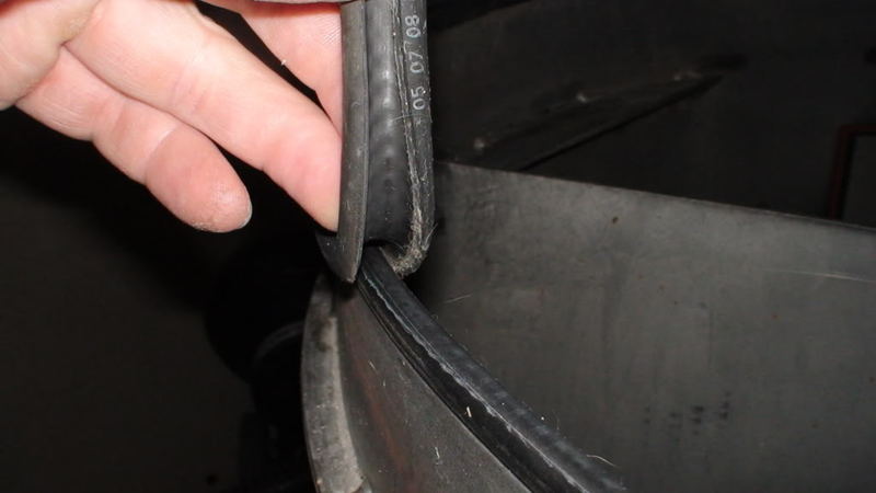

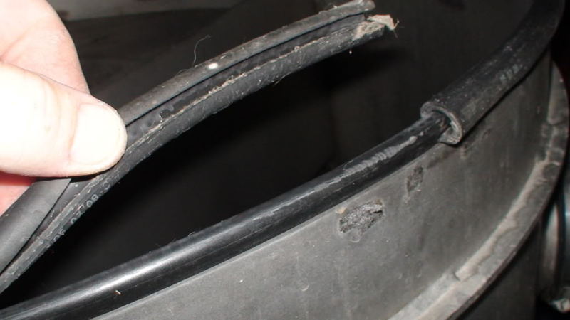

gasaxe

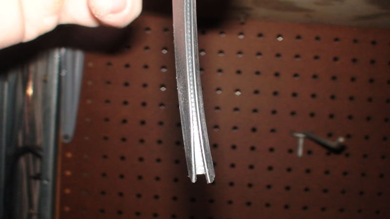

here is a inexpensive easy solution. Not as long term as welding the ring as
shown above, but does work well. I got the black trim plastic from a autobody supply
house. The black hose is 1/4" fuel line slit to fit over the plastic piece. The plastic
helps to keep the rubber fuel hose from being cut through from the
weight/compression from vaccum that the lid places on it.
Ive got a easy way to slit the fuel hose if your interested in doing it this way.
you can cut yourself in a bad way if your not carefull.
50,010

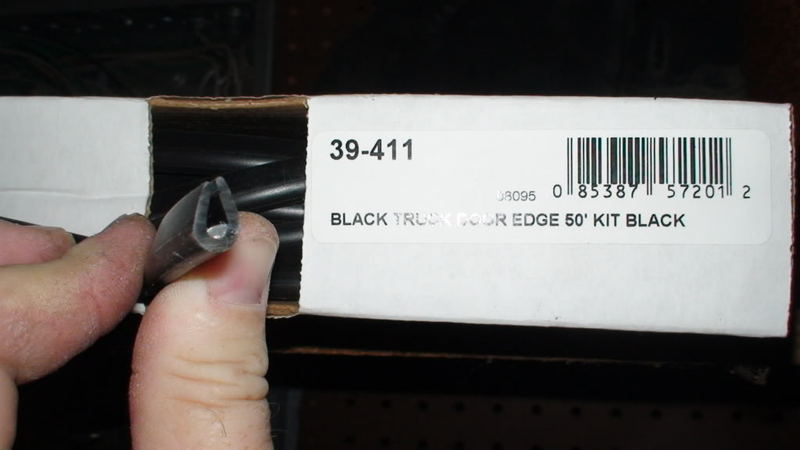

That is pretty much what I purchased from Duane. Only difference is, Duane's stuff has a metal clip inside the holds the shape and clips onto the tank edge.
D
Duane Oxley
The metal reinforcement is pretty necessary, if you're going around 90- degree turns (like the corners of a rectangular tank), to stay in position.
You have to trim out a piece about an inch long on the inside of the part that goes around the corner. And from there, it fits well and stays in place.
Duane
