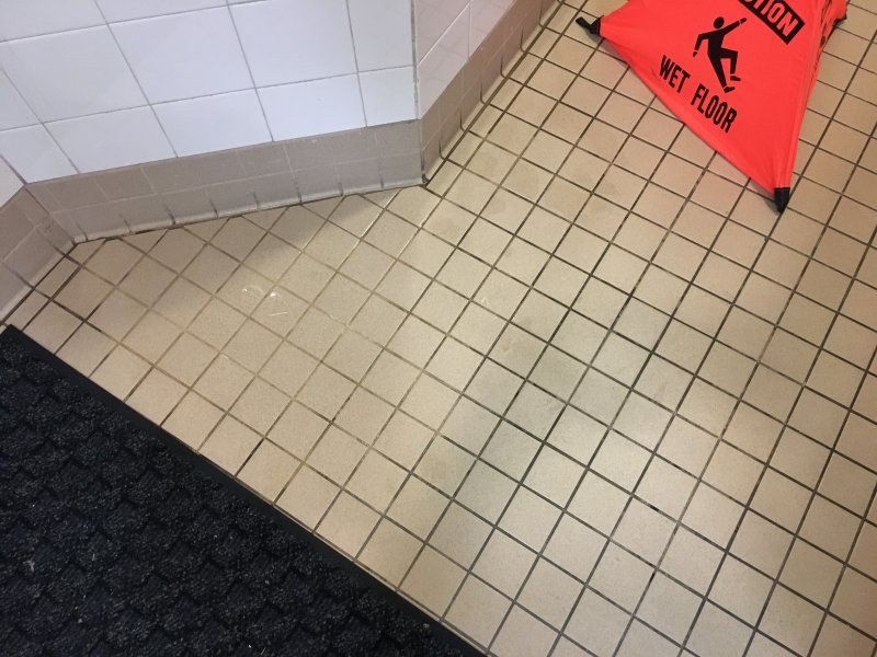

1200sq ft of this and I'll be squirting some ultraseal on it after

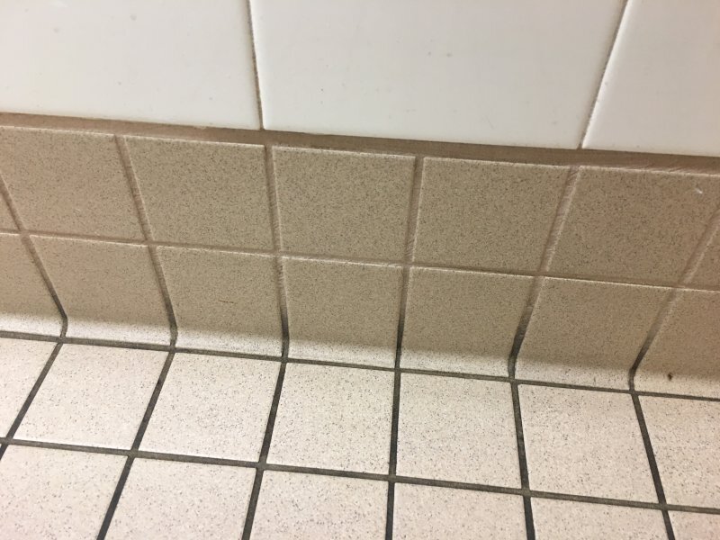

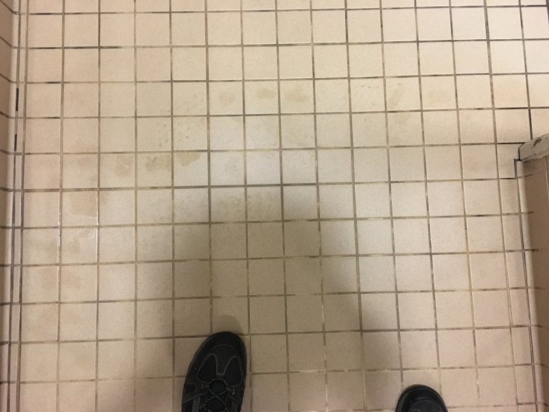

Here's a few tested spots. I only treated it with Saiger's juice, and a little acid after. I didn't let the acid dwell too long, so maybe...
They know it'll be blotchy, so I'm not gonna stress over it

Who's got a deal on a SX-12? I'm not doing this with my crappy tile wand at 11pm. I'm burned out on doing big areas with that thing.
@scottw Any one of your suppliers running a sale?

Any 12 ph powder at 3 ounces per
3 ounces vct stripper
2 ounces 40 volume or Oxy Clean
Long dwell, scrub like mad, dwell some more..
1200 with your new spinner
Cobb's Acid
Scrub again
Spin again
Force dry
UltraSeal.

How long should I let the acid dwell?
