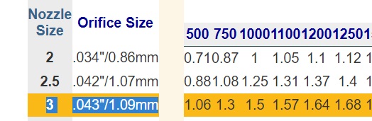

Don’t listen to those meatheads above. Just follow the chart to the specs on your water pump on how much gpm it can put out
Reactions: FyreLyter
14,275
I need you all to help me understand "flow" as it relates to carpet wands. I understand that higher flow results in more water, but how much. When you say "my wand is 9 flow" what do you mean?
Can you tell use what machine you’re using on that wand?
(corrected for friction loss by Dan G)
