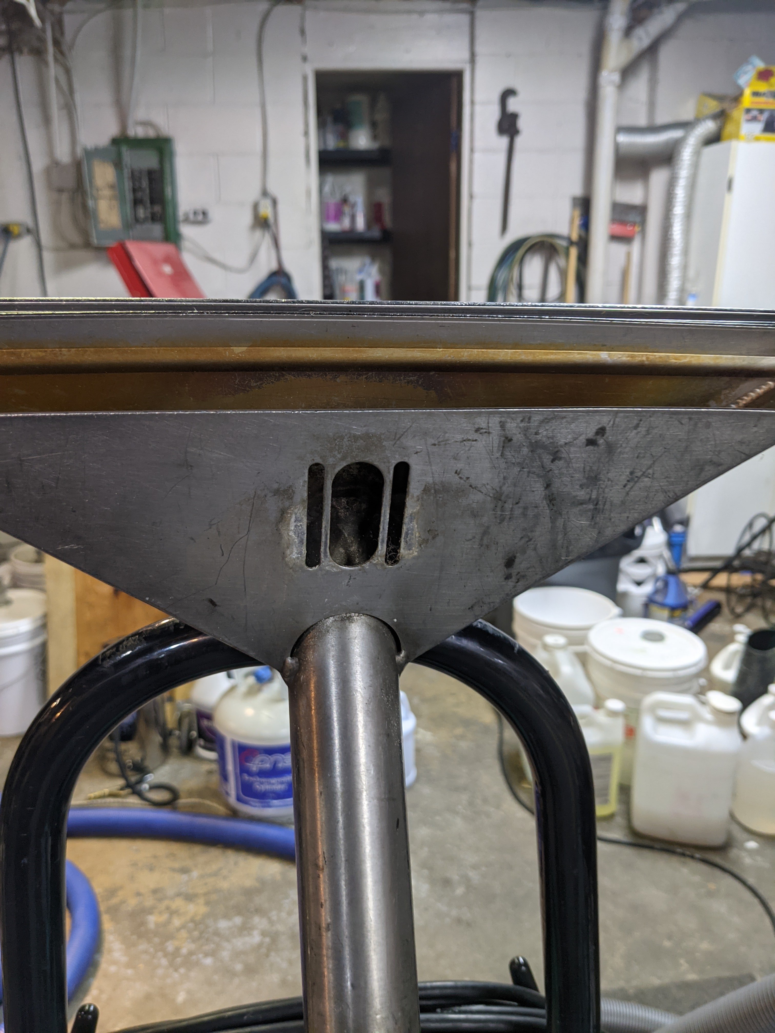

I still have a couple. I like the concept but they wouldn't pick up very well in the middle depending on the power of the unit and the style of the carpet. Very heavy wand. Probably an internal fit glide would help.

I'm not sure how it correlates to a t or v jet but I remember it putting out what seemed a lot of water. There is some adjustment on the steamway wand to raise or lower the jet. Probably easier to find a jet locally but I could mail you this one. It is brass so probably worn out.

the slotted thingie on the wand head allows adjustment up or down jet height if needed
(for angle of spray)

With the back shield on the steamway wand you cant see the spray pattern.
