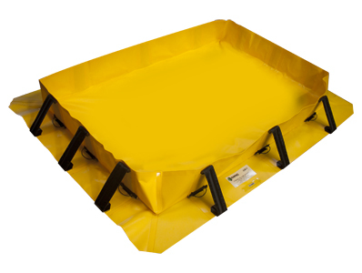

Interesting concept for a break down wash pit for rugs:
http://www.enpac.com/portable-containment/stinger-yellow-jacket-berms/

Those would work but are a little difficult to get all the water to the sump pump. You will have to manually extract the water before you put it away. You could build a plywood bed underneath with a metal flange under which you could put a bottle jack. Flood the rug, let soak, then jack up slightly so the water runs off to sump pump and even Rinse with hose. For my shop, I need a 16 x 12.

They actually have some different sizes available. There is a 12 x12 that would work for the majority of rugs I get. I wonder if they could custom make me one. I'll have to give them a call.

For a temporary water pit on concrete, Robert Mann has shared his idea before to many. He buys Uline poly tubes. He fills them with water and ties then off in a knot. He curls them around to make a curb. The weight traps the water inside the curb for one to soak a rug. Uline sells these tubes inexpensively for what they do quickly.
Masterblend sells a rubber pit with air inflatable curbs. They have one for sale from the ICE show that we used as a demo.
