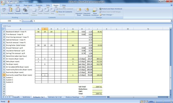

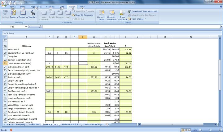

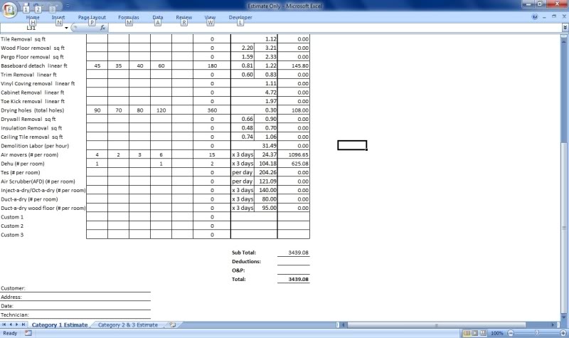

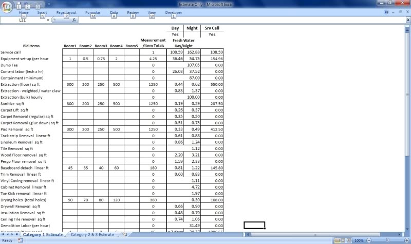

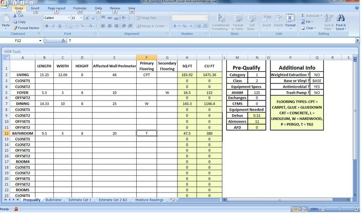

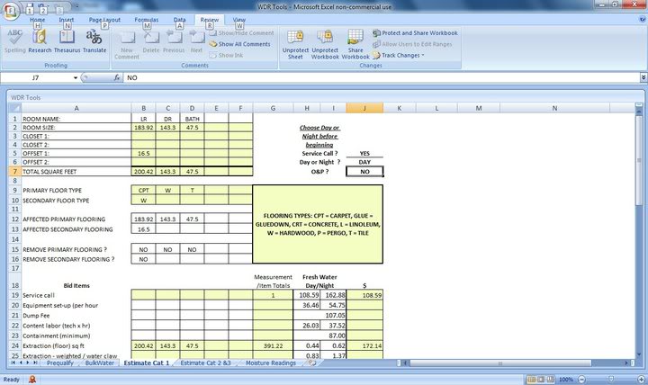

I created this working excel spreadsheet, and I'm still designing it. But, I can take this estimate form shown above and make it not calculate the automated stuff I've designed, and allow you to place in all of the quantities manually and it will calculate the total. There is some space below it to add in custom line items if need-be. I've sized it correctly to print off on normal paper.
There are plans to for the whole workbook to be sold/distributed so I won't give you the whole thing, but this is an early stage of what it looks like.
Enter the basic information
It auto calculates some stuff, still some information that needs to manually put in like total sq ft affected.
Beings calculating the estimate
Allows you to offer a discount, add over head and profit if you need to or 10 and 10 as some call it, and produces a total WITHOUT tax.
Shoot me a private message or an email stevenhoodlebrink at gmail.com if you're interested in having just the estimate form.
