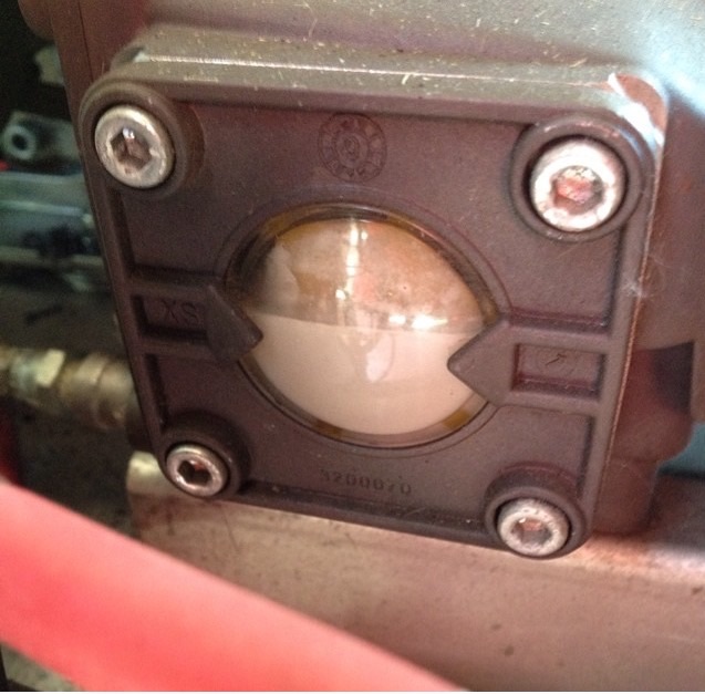

Did it look like this?
dealtimeman
Everyday is Saturday.
Sep 20, 2008
10,878
Michael
While I am no rocket scientist, I don't think that looks good.
