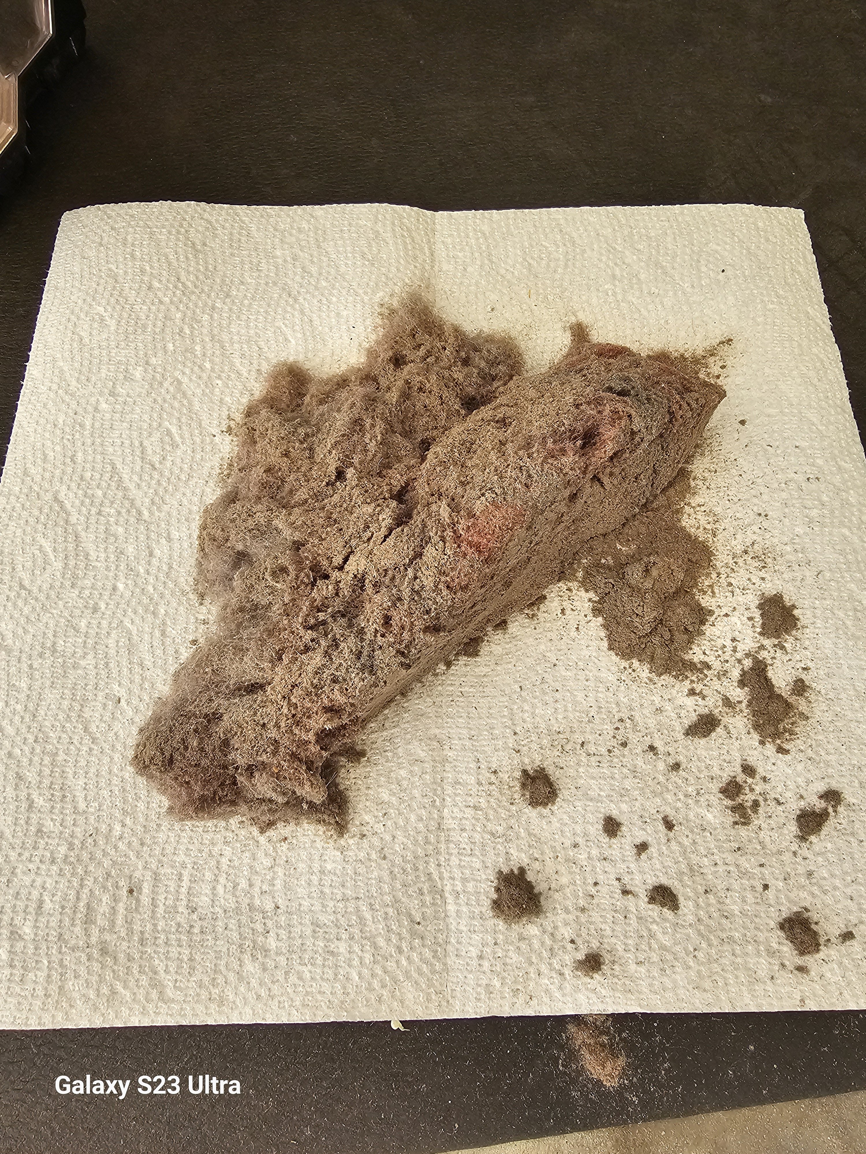

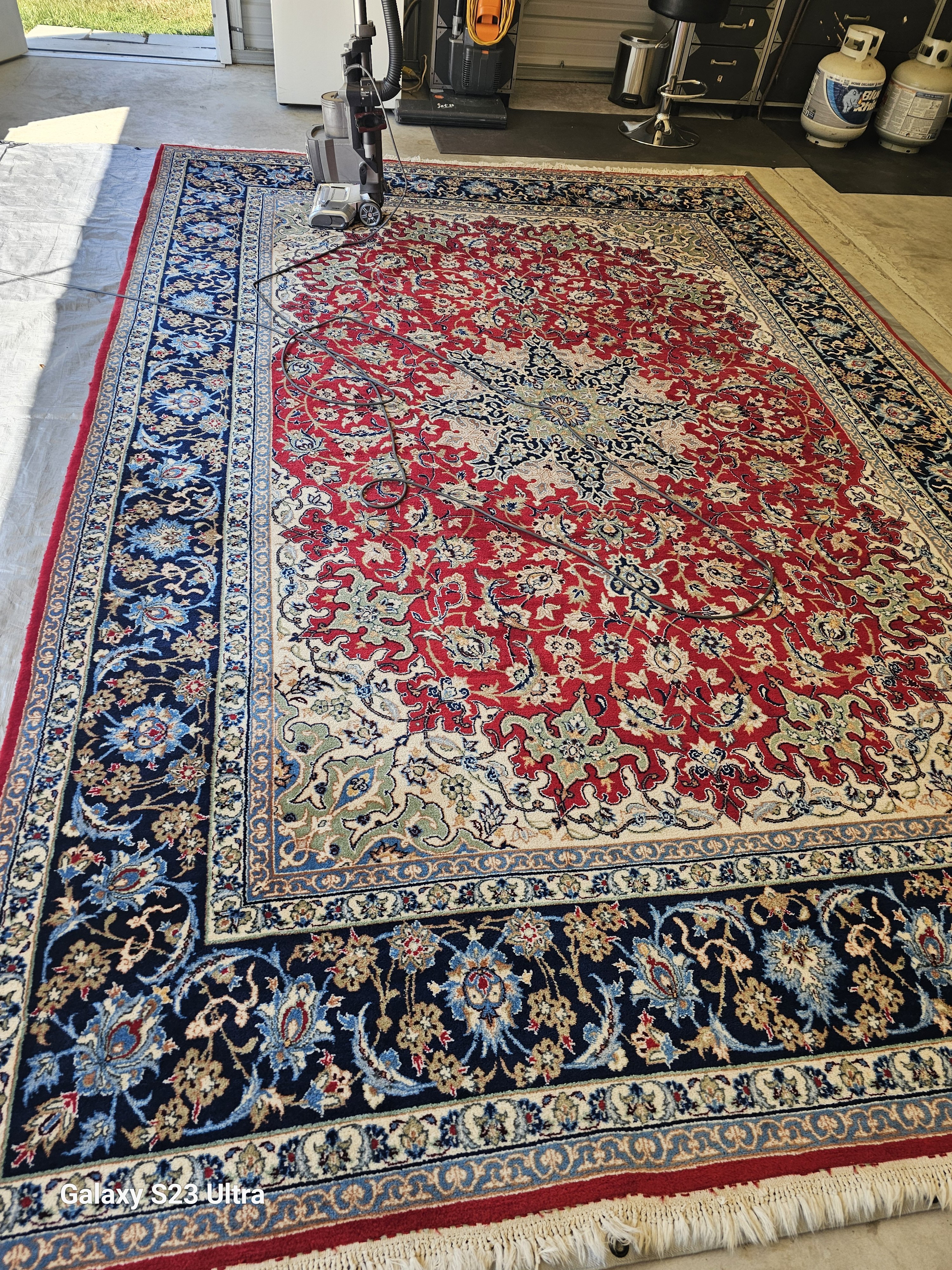

Picked up this rug today because customer said it was getting this stuff put of it and it causing her chikd allergy issues.
What is it and how do I remedy it?
I got this pike from vacuuming with a shark in two directions. 20240916_123430.jpg20240916_123446.jpg

Flip it onto its face, and vacuum really slowly both directions with the brush roll engaged. Then carefully peel it back, and sweep up the dust/dirt.
Flip it back over so it’s right side up, vacuum the face slowly both directions again….
I do that to the rugs at this daycare center and I swear I could get a full kid's sandbox out of all the vacuuming I do

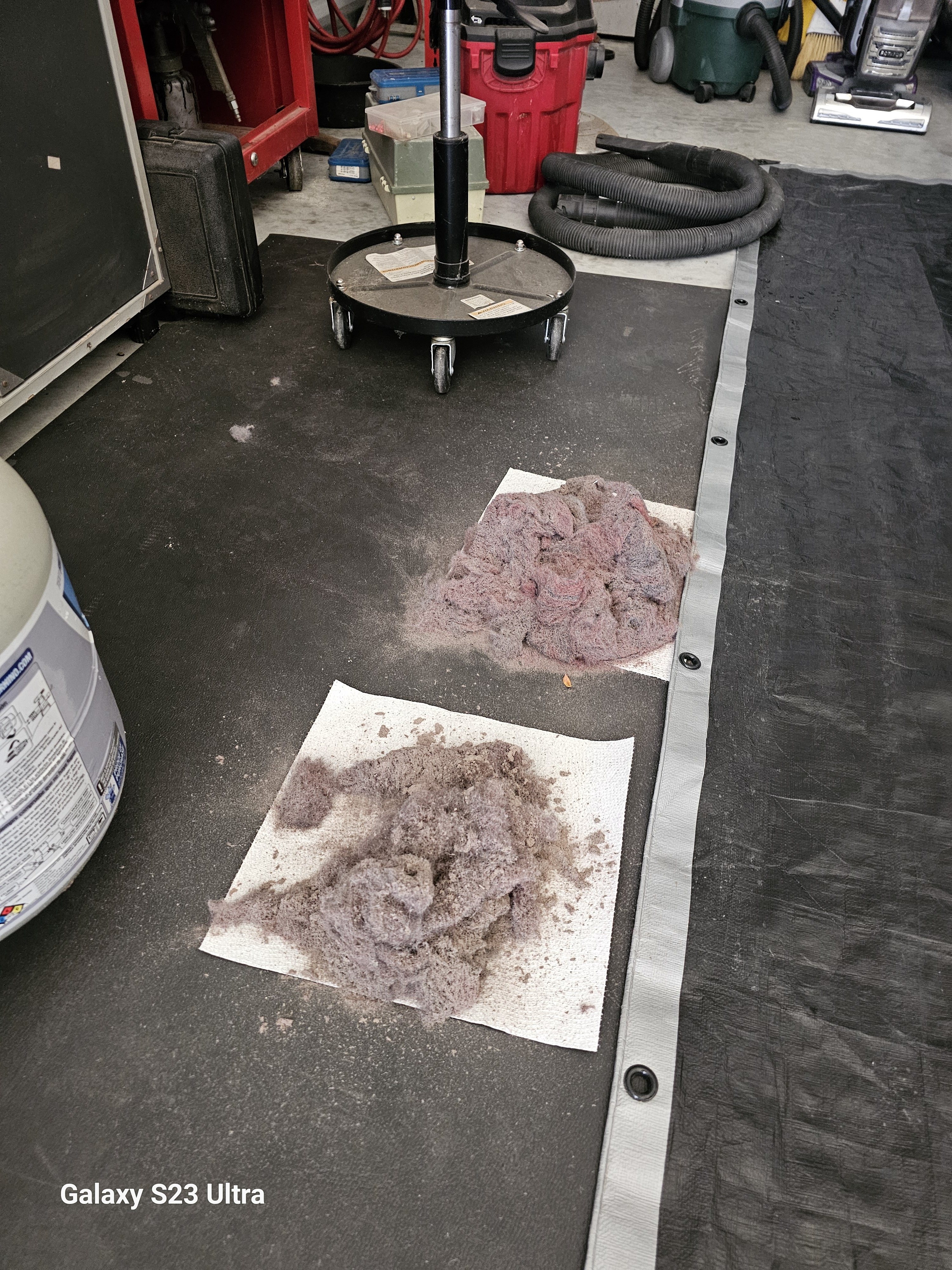

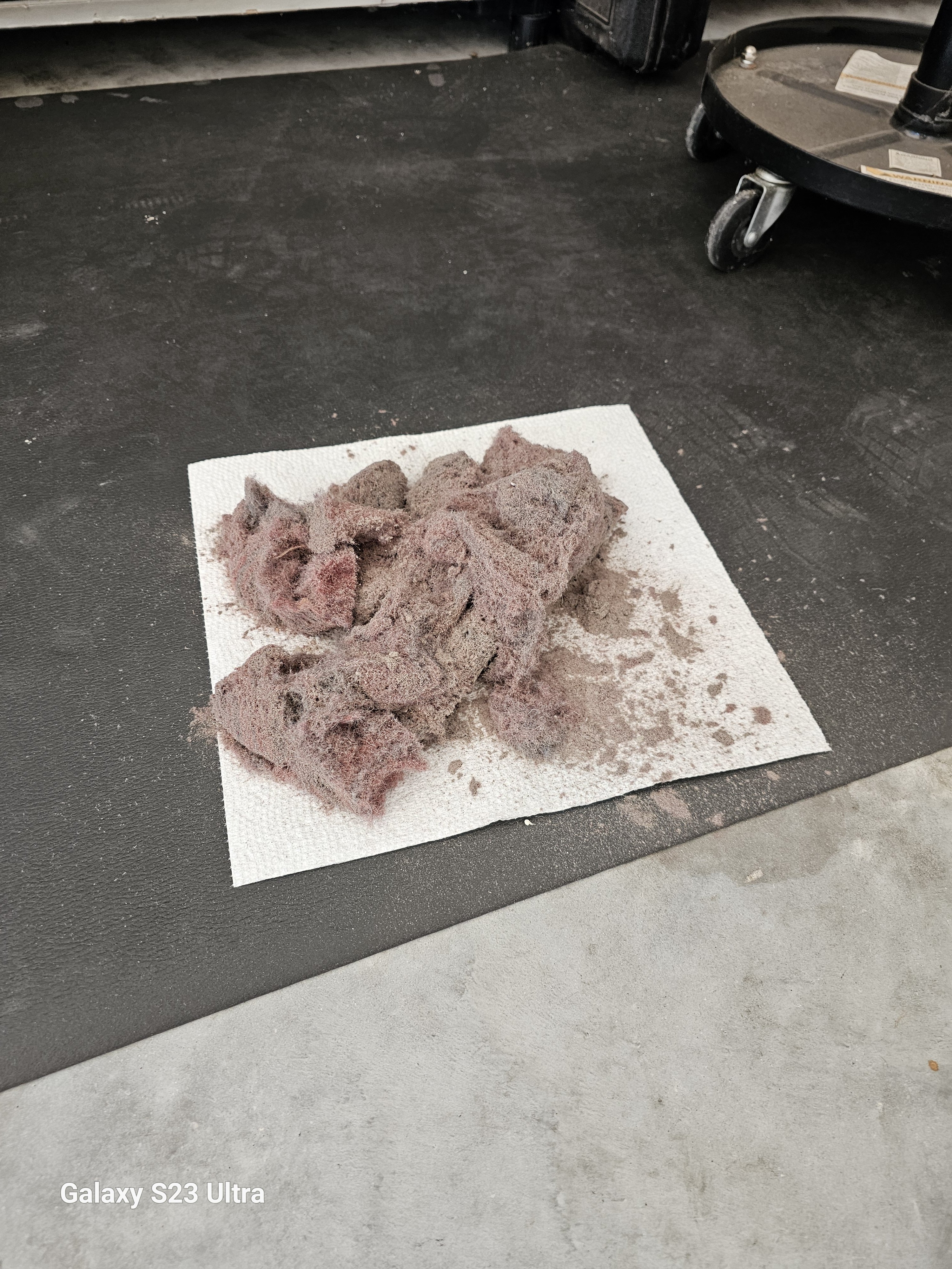

The smaller pile came out of a 3x4 lol.
I guess this is what happens when you don't vacuum.
Nothing came through the rug. I flipped them and the otger side was clean on both of them. 20240916_162317.jpg
