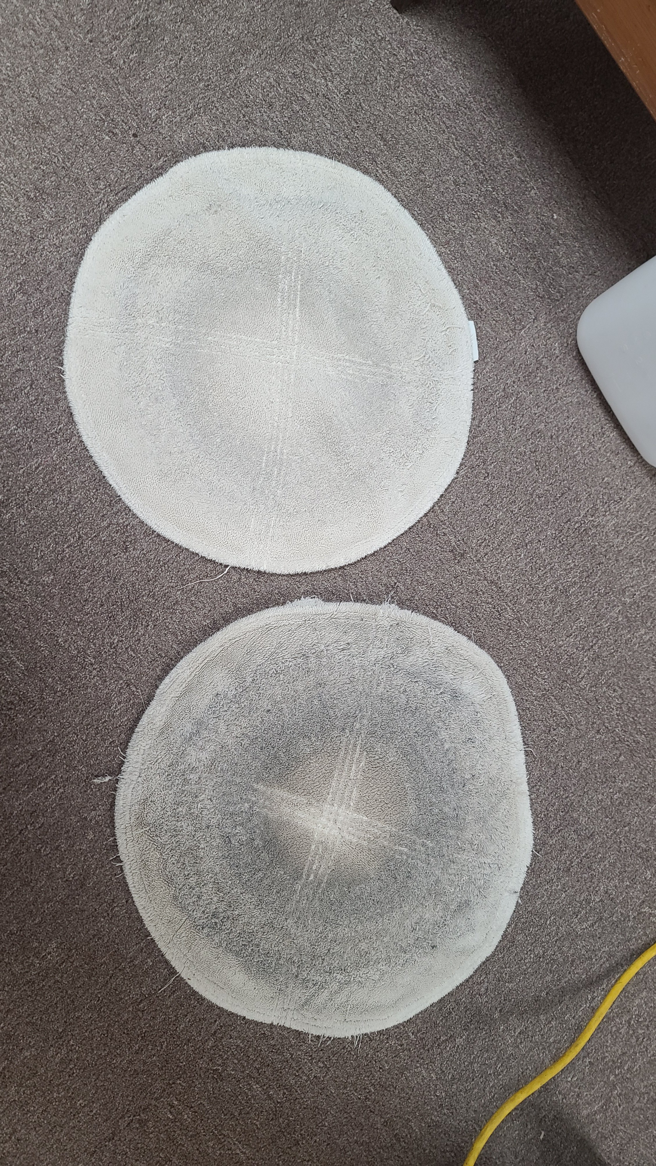

I typically use microfiber wash, but some of them just don't clean up well anymore, do you bleach these?

I soak all my used microfibre and cotton bonnets in a solution of 1 cup borax mixed W/1/2 cup liquid laundry detergent in a 5 gallon pail of hot water overnight. The next morning, I throw them in the shop washing machine. When I get back to the shop at the end of the day, I lay flat to dry. ALL of my bonnets still look new…

I got the best results soaking pads with borax and an enzyme prespay as the detergent. The enzymes gave me at least a 50% boost in soil removal over liquid laundry detergent. My experience is that soaking 4 or more hours makes a significant difference in the results.

We’ve got an old school washer and dryer @ the shop. Top loader, center agitate. When I put them in, I fill the machine with hot water, add a scoop of oxy boost, approximately a cup of detergent, let it fill, agitate for 5 minutes, stop the process while we do our morning preparation work (fill water in the van, fill spotters, chems, wash van, etc). When we leave, I turn the cycle back on. At the end of the work day, I pull everything out, put towels in the dryer, and lay the bonnets flat to dry.
The system works perfectly for us.
I like to have ‘a place for everything, and everything in its place’…
That includes having things clean, neat, and tidy….
