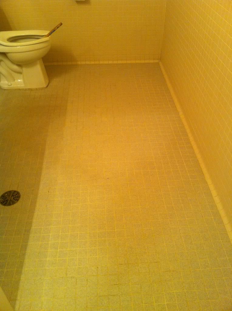

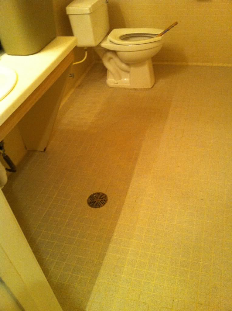

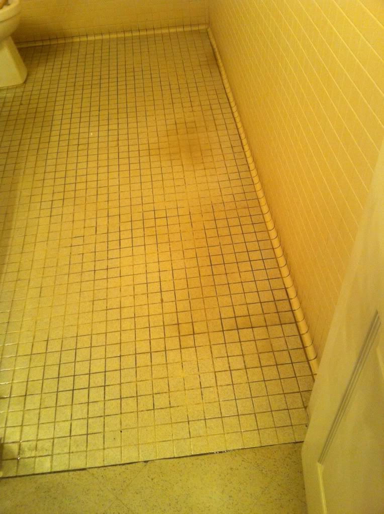

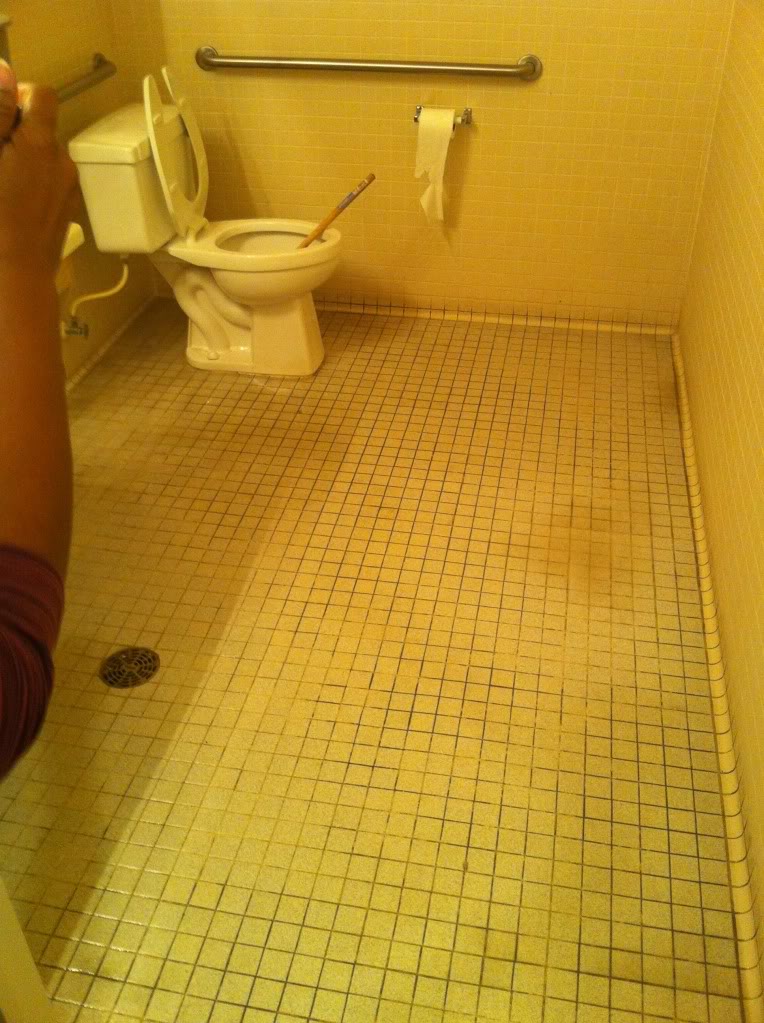

heres one i just did sunday. just oxyblaster with floor stirpper. was a minimum job so no acid step.
this was after applying stripper/oxyblaster
after turbohy
i think with an acid would of came out perfect.
