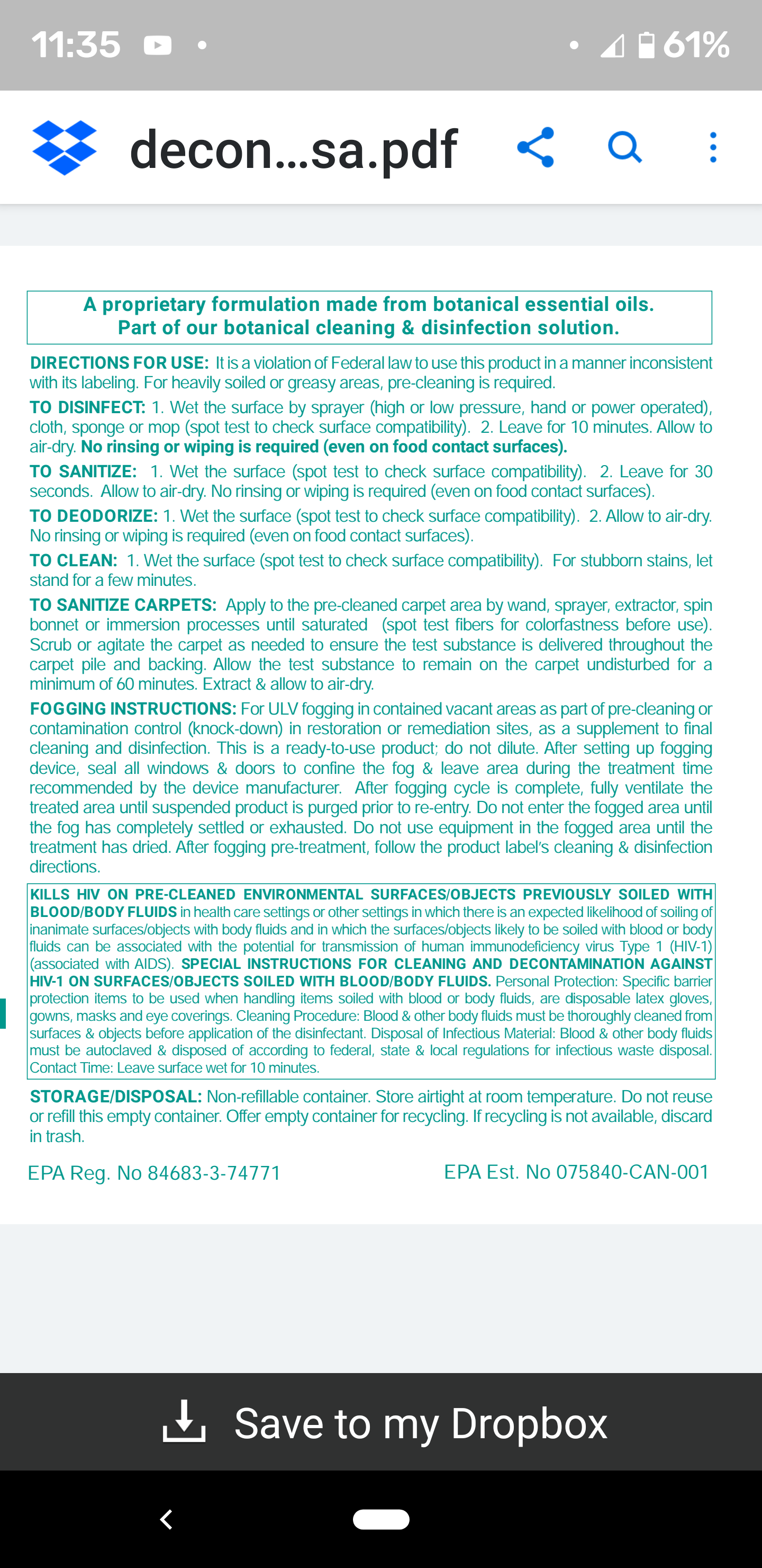

Assuming that you have nothing else to do, what will you charge for an hour of your time to let a sanitizer work?
117,295
I clean the carpet then I flood the carpet with gallons of product, let it sit an hour and then clean again. So $45.00 a gallon 1500 square feet carpet = 7 gallons $315.00 2 cleans and $315.00 so what do you charge? $1.50 a square foot then rent them 4 fans and a dehu $200 a day
