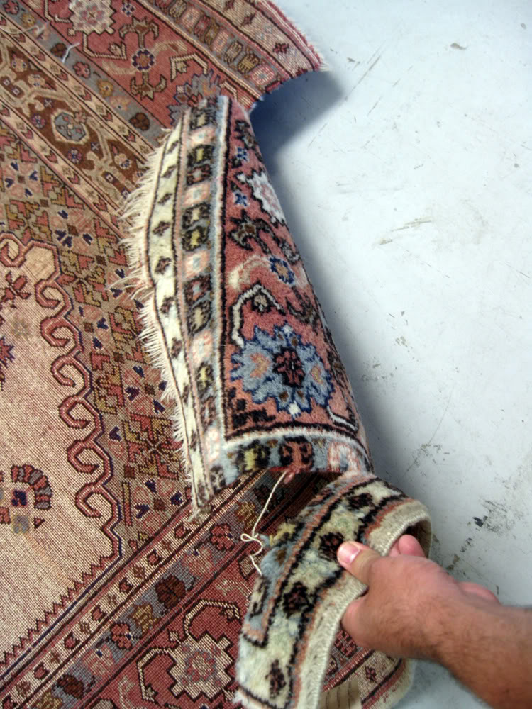

I think we all know here that it's the PERSON who makes the job great more than the equipment. You can have a good piece of equipment, like the Badger, in the wrong hands on the wrong rug, and SHAZAM - rug disaster.
This rug came in from a competitor (big franchise down the street from us - trained by IICRC trainers...) - and the comment was made when we asked "what in the hell happened?" - Answer - "It was badgered."
So my mother will fix it... but we won't be able to keep them from doing it again. They've got a pit, a Badger, and some very incomplete training - so I'm sure we will see them a lot more in the coming months.

I will certainly make it stronger point (with my clients) to use TYVEK on the back of rugs that are suspect and even use it on less sensitive rugs as then the fringes or edges cannot get scuffed up or worse. I will even take it a step farther and put a warning label on the RugBadger that it be used with a big piece of TYVEK placed between the back of the rug and the underside of the RugBadger.
This will ensure that the vibro-straps cannot hurt a rug and at the same time still allow you to get all the energy into the back of the rug to remove the soils that your clients are paying you to remove!

looks to me like someone sucked the rug in to the badger because they were careless around the fringe.. seen it happen with vacuum cleaner too.
Lisa, I hope you or your mother makes some money on this repair.
A planet far far away
I think Sweeney is right, some careless tech was probably the one processing the rug, damaged it and went told his boss the Rug Badger did it.
The Badger is an aggressive machine, if the rug is delicate maybe it shouldn't be Badgered? However that rug looks like it was damaged not because it was delicate but because someone wasn't thinking.
We've had a badger for years and never damaged a rug yet. It does take some common sense to run one, something this guy was definitely lacking in.

the damage is somewhat perplexing to me and not as simple as running a badger of the end honestly it looks cut to me
Yep - they are perfectly clean cuts. All along one end, as it got pulled up into the unit.
What's good is that with no real loss of knots, it will be relatively easy to make the repairs disappear.
