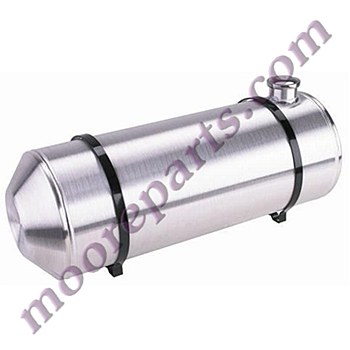

Mounting the tanks on the tongue is the way we do it here. We use Spun Aluminum tanks. A little welding and they mount up easy.

Shawn Forsythe said:
Putting the kero tank inside is something I wouldn't see a problem with, but I don't know I would want to put the Gasoline tank inside. First, the logistics in filling a gas tank on the inside is dubious at best. But the bigger problem is gas fume venting. Most every fuel tank is vented to prevent pressure build-up due to temp variances.
I would use a marine tank securely mounted to the tongue.
Marine Tank? These are what we use

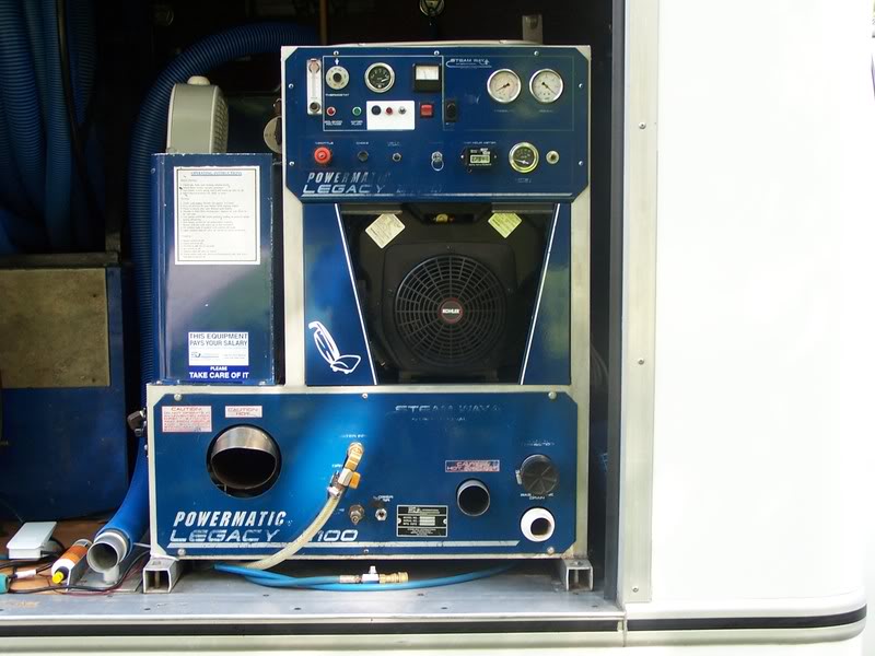

My box truck is a 6 x 10. I have my Powermatic, reels, shelves, really all kinds of things in there.
For many years I used the marine tanks that come with the Powermatic for both gas and kerosene. My son in law still uses this system inside his truck.

going by memory, the unit weighs 930 pounds empty.
foot print is 35" x 60"
you won't need a big trailer.
You will need one that can carry some weight.
I'd suggest a minimum of 3000 pound payload capacity.
Your pick-up will handle that.
boat tanks will be fine inside the trailer.

Mike buy the machine! They are very heavy 900 lbs. Instead of a trailer go with an extended van.
Mine is mounted at the side for more room in the back.
If it really has that many hours it is a freakin steal. You will love the heat. They are easy to work on as well. I do all repairs on my older unit.
Your truck will be fine to pull but I would get dual axle and brakes. Machine and equip with 100 gal tank will be heavy.
Even if you set it in the garage for a while you'll have a great backup. Move the vacuum port to the tank lid and you can run 4 to the door with decent vac.
