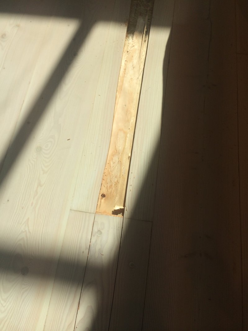

Been brought onto a job to help try and save a wood floor in a new restaurant construction. Plumbing company is responsible as one of their new installs in kitchen broke and ran water all weekend into the wood floor area. No walls or structure are affected it's just the wood floor which is in an open room and is approximately 2400 square feet.
It's tongue and groove Douglas fir
Then 1" 1/8 advantec brand plywood subfloor
Then poly vapor barrier
Then floor level
Then concrete subfloor

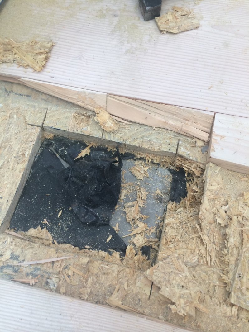

We removed one small section to confirm and take a look. The nails for the subfloor have punctured holes in the vapor barrier and allowed water to run under it.
Can we save this?
My thought was to drill small holes (go into the knots on the wood) all the way to the floor leveler
Or should we just attach rescue mats and let the holes from the nails be the release points? Or is this not gonna work?
Have rescue mats and heated air plus the usual drying equip

Tres, With a floor construction such as this; much would depend on how much water
(level of saturation) and type (catagory?). It would be difficult if not impossible to get any airflow between the OSB (not plywood) and vapor barrier.The same may be true for the OSB and Doug fir flooring unless there are flutes in the flooring material. Another consideration (problem) would be the possibility of water/moisture trapped under the vapor barrier (if perforated) against the slab. All these things considered make this a tough drying situation if not impossible. If the moisture level is not excessive a "Salvage Effort" only effort might be considered ( floor mat system, dessicant, tenting) It's unfortunate but you don't want this one to come back and bite you if you accept responsibility to dry it.

Cat 1
Unsure amount of water but it's substantial
There is water trapped at all levels including underneath the vapor barrier because of the nail holes (the specs on subfloor from manufacturer were for it to be glued down)
I am not liable for nor have promised a result. Merely an attempt and all paperwork is in order.
This place is set to open in 18 days and it's probably a 200k floor. Some special wood and there is only 50 feet left so they are willing to as much as possible to save it.
Current setup:
We have opened two ten foot long sections all the way to the concrete subfloor
Drying mats placed in between the two openings
Drilled holes in the floor beneath the mats all the way through the vapor barrier. Hoping to push air down through all levels and behind vapor barrier
Tented with heat
Do not have dessicants
Any ideas or suggestions are welcome thanks in advance
