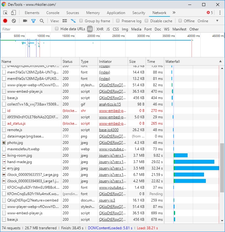

as for the slow loading the slider pics take the longest....they are huge but I don't know why this would just now be an issue unless a now nonworking plugin was compressing/resizing

the page load problems seem to be from the large slider pics
