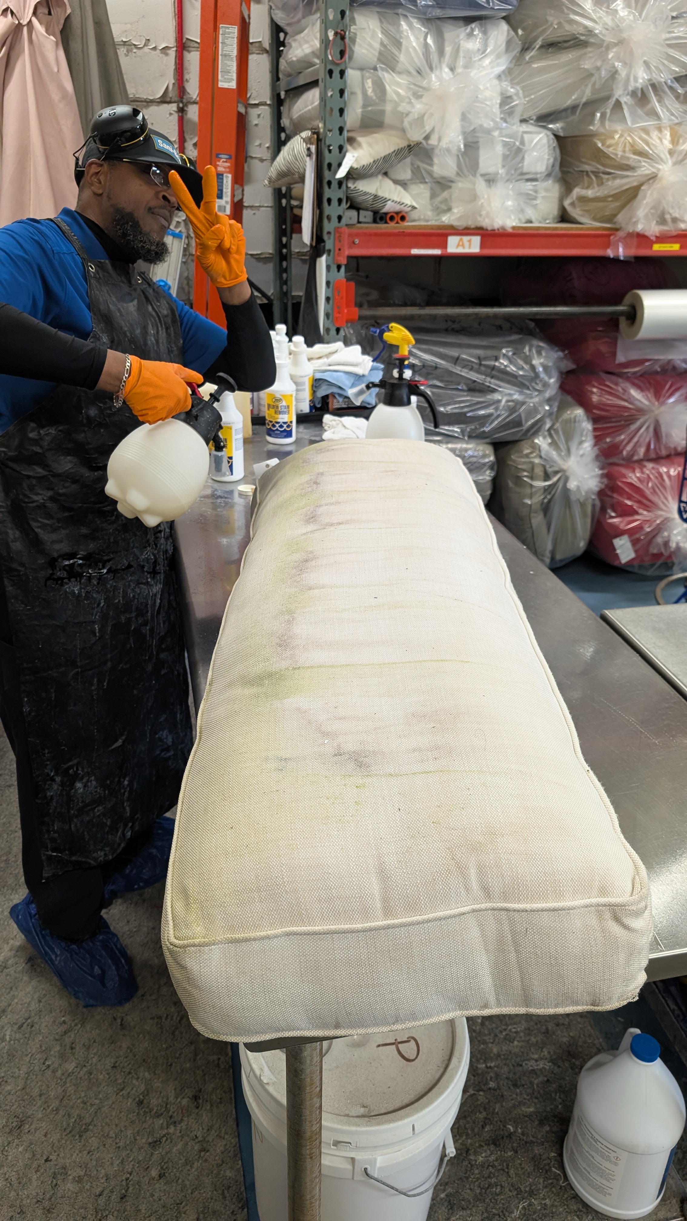

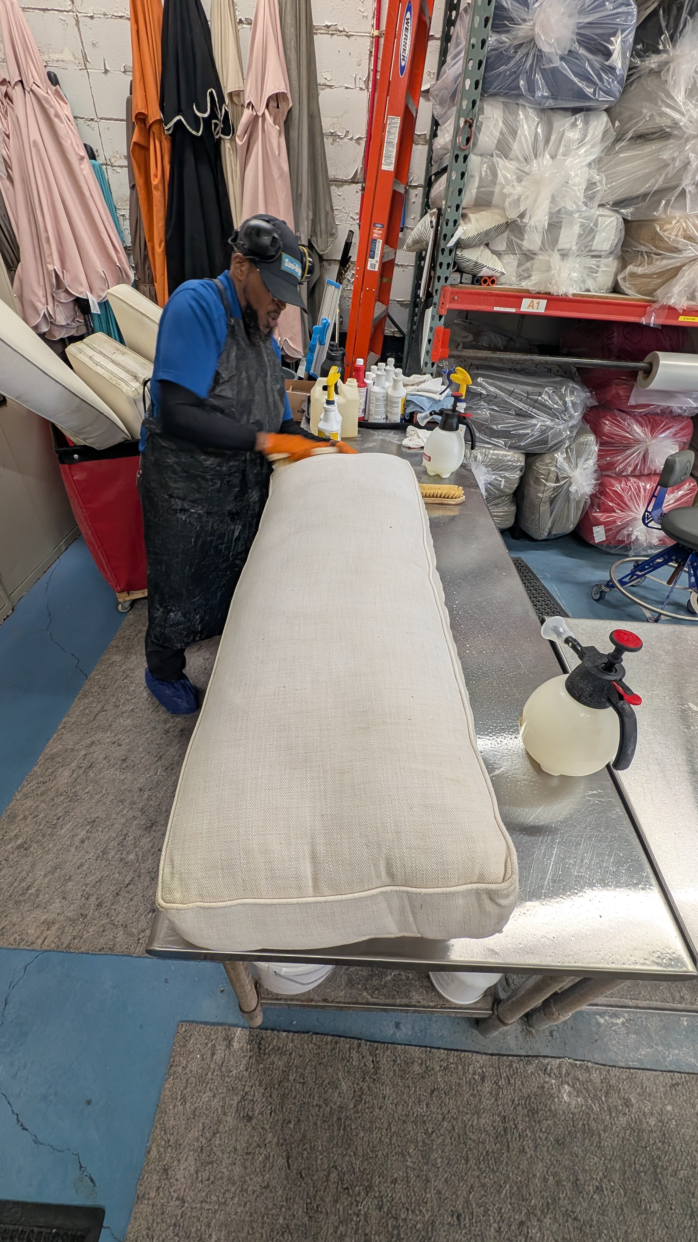

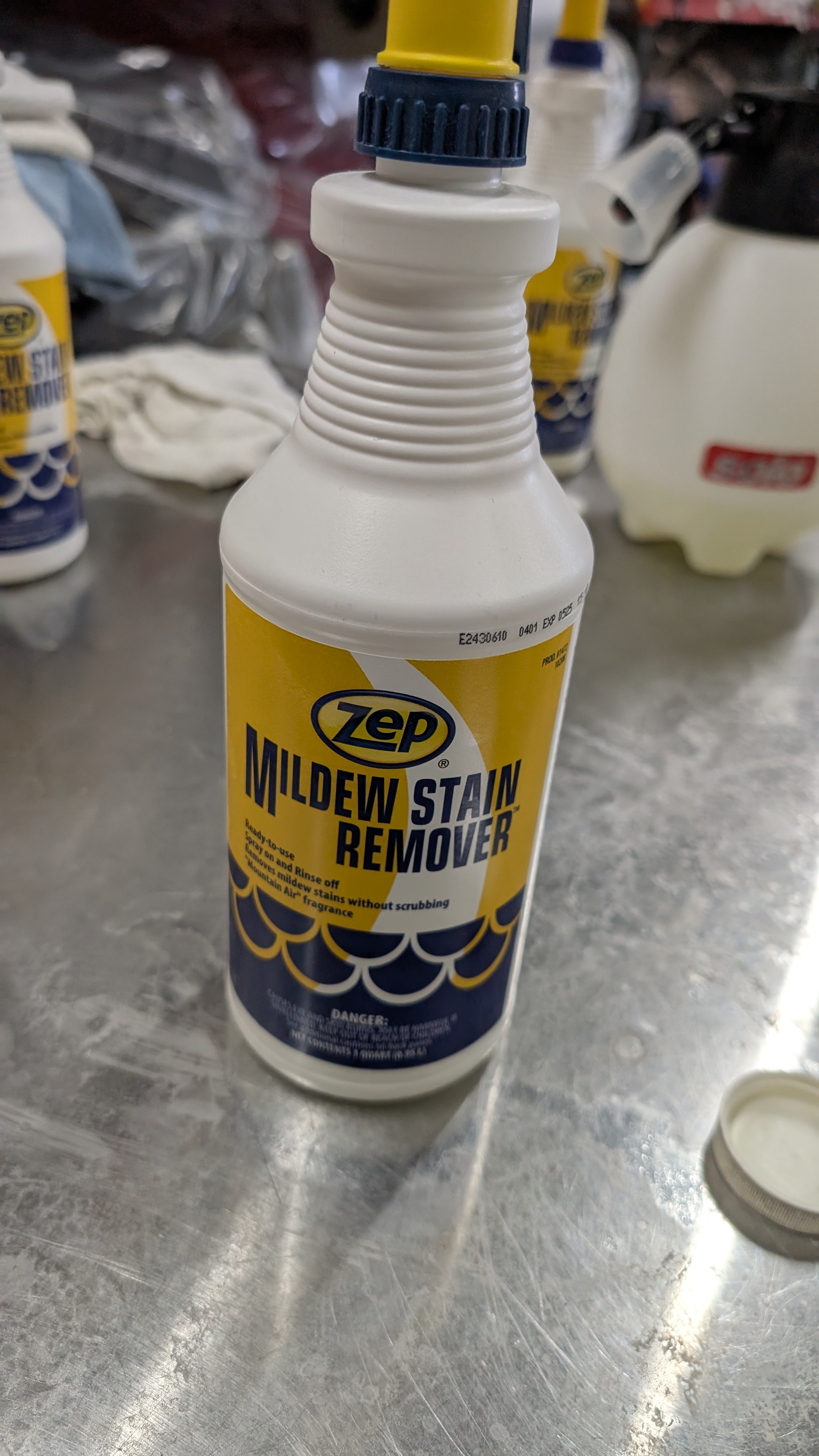

Zep mildew stain remover. Miracle in a can
115,962
Pre vacuum
Pre rinse
Apply enzyme cleaner
Rinse
Apply Zep
scrub
Dwell
Rinse
Repeat Zep if needed
Rinse
Dry
PXL_20250122_201213361.jpgPXL_20250122_201204045.jpgPXL_20250122_201646809.jpgPXL_20250122_201822807.jpg

Is anyone looking at the potential long term effect of chlorine on the cotton threads that are often used to stitch these together?
I'd be surprised if cotton was in outdoor cushions. Why in the world would any company do that?
And is that Zep a chlorine or peroxide based mildew chemical?
