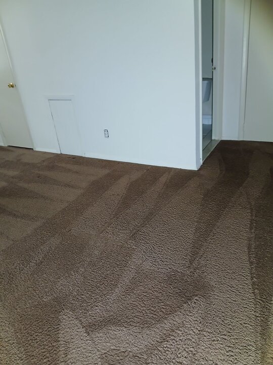

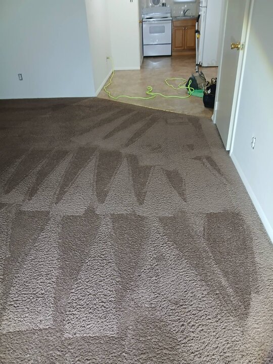

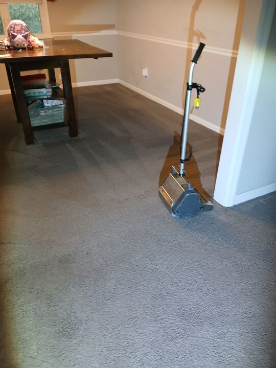

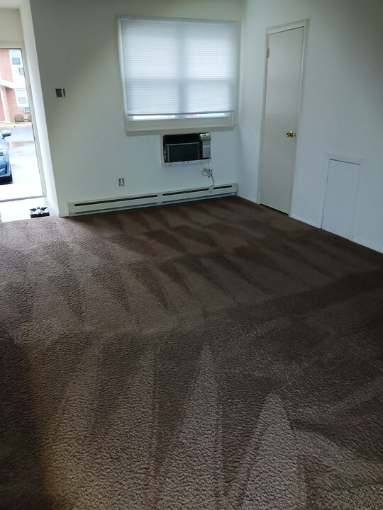

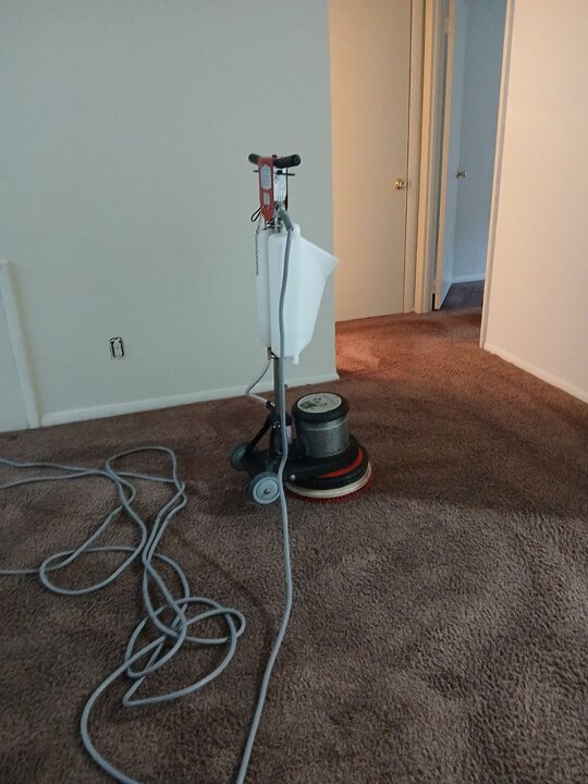

The first time using my 175-300 putting down solution from my tank was a total success
I just used 175 never used the 300
I used 14'' Red Pad on 14'' Driver to scrub and extracted with 17'' Ironman Bonnets. I used both sides of the bonnets
10'' CRB to groom
I used 5 oz of Carpet Details No Peroxide
I love VLM !!!

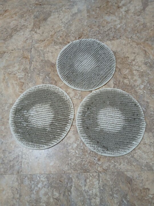

WOW!!!
Look at those pads!!!
But where does the dirt go????????? LOL
