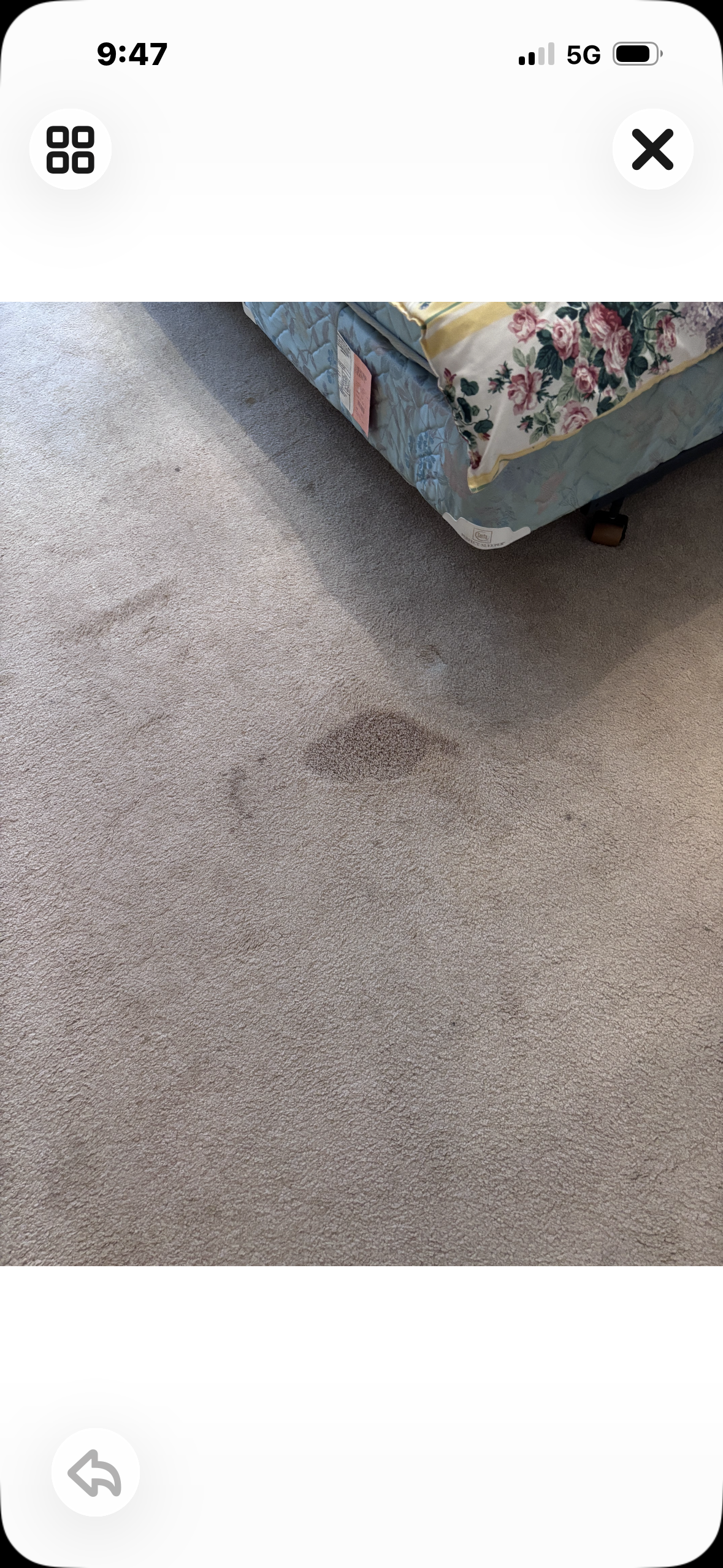

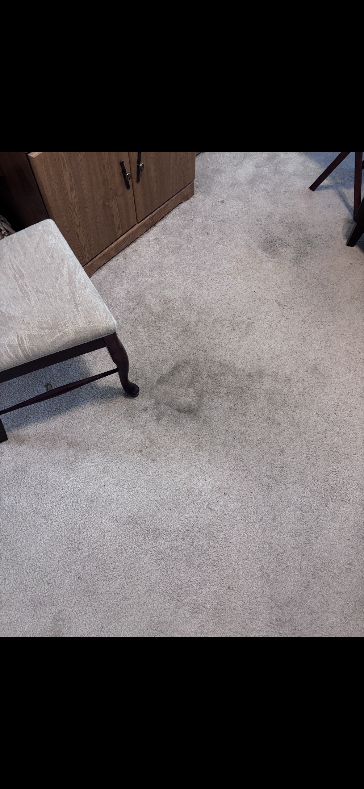

I still haven't tried Saigers Encaps because I'm very happy with the results I get with VacAway and Releasit
Now that the snow has melted and my phone is ringing again I might have to give Saigers a try
I would have used either VacAway Commercial Magic with Detonator (Peroxide) or DS2 and Punch on a job like that with a fiber pad on Phoenix first to scrub or my Whittaker Trio then a Microfiber Bonnet to extract
But Mark uses Saigers 2x with Oxy with a Microfiber Bonnet to scrub and then Cotton Bonnet to extract
LESS water MORE agitation !!!
View: https://youtu.be/yvmnQ5eMfvU
I am happy with Saiger's code red of encap. I have tried other products and most work well but I prefer Saiger's over the others. I use some of Vacaways products for heavier grease areas. Commercial Magic or 357 works well. TOPS spotter is also a great product for grease marks, crayon, garbage drips or other greasy types soil.
