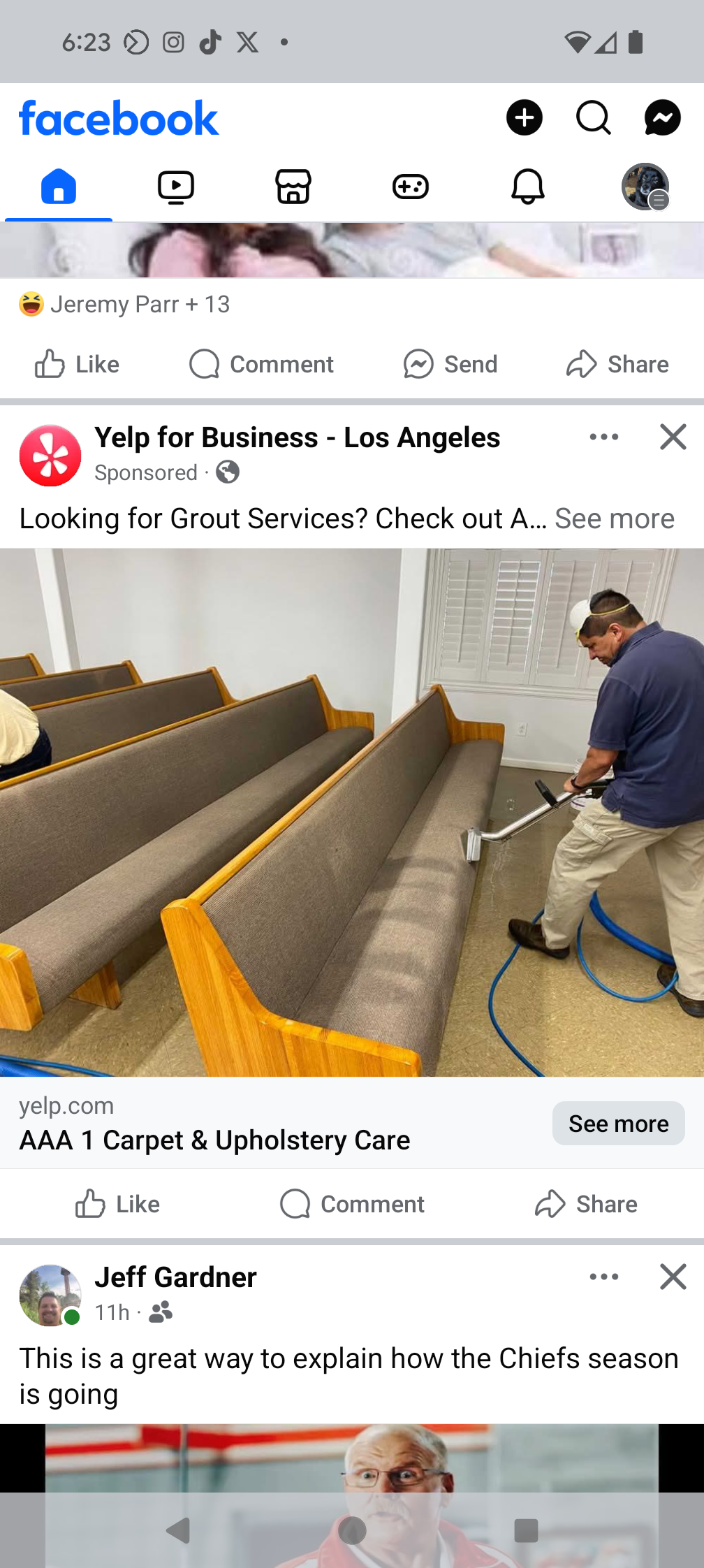

11,378
California
I think I found you a customer Doah!
