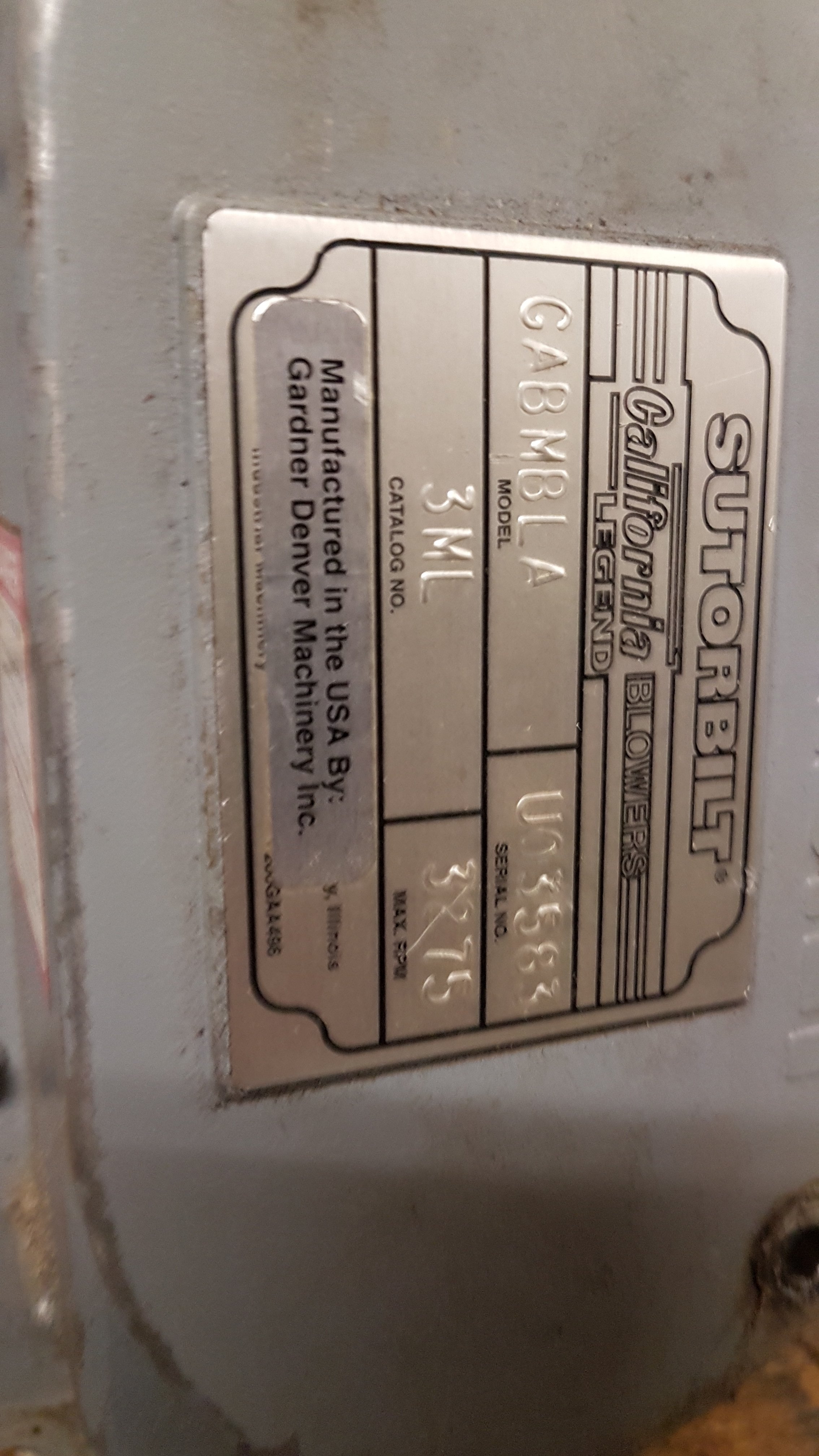

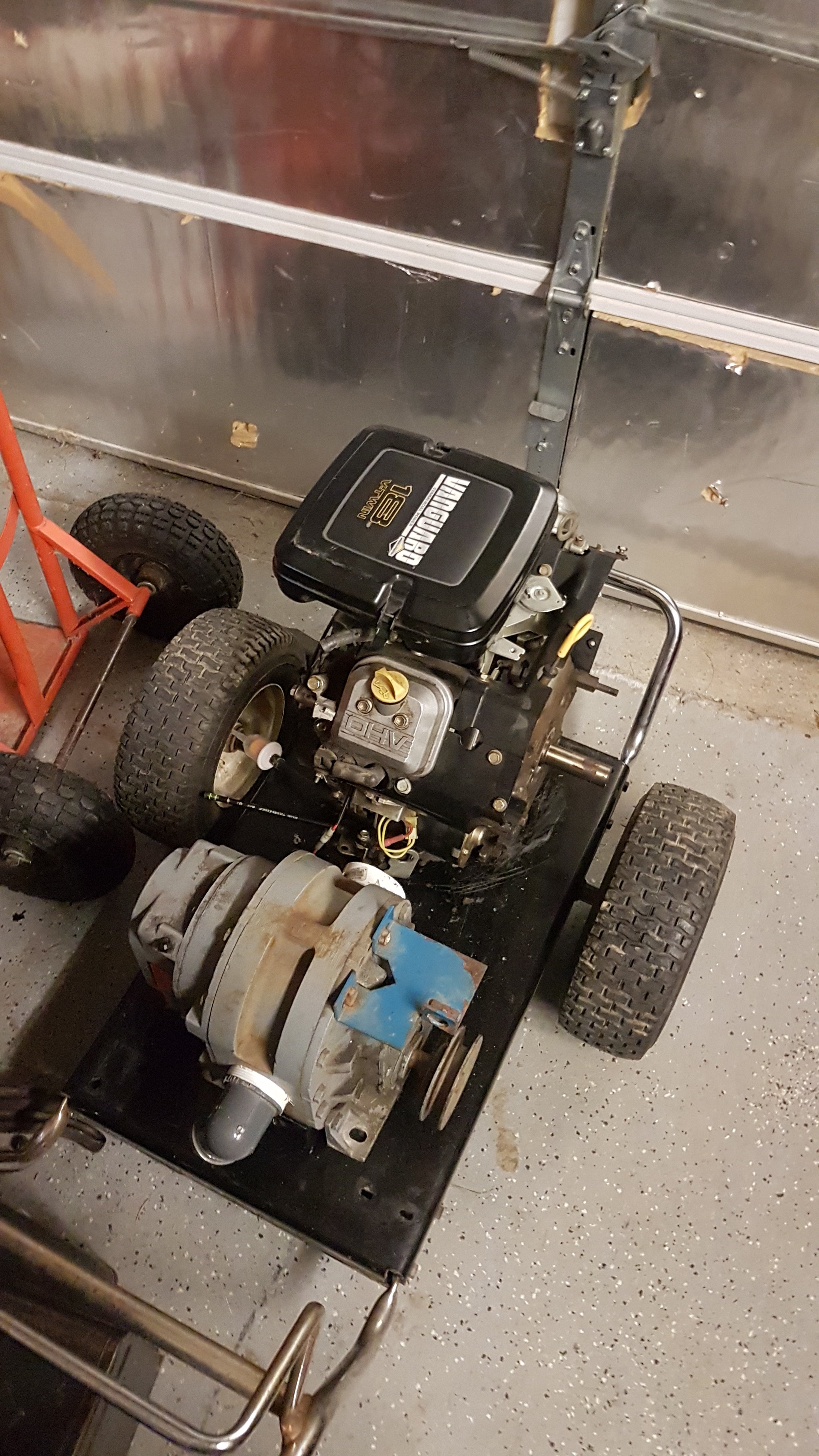

I'm building a machine using a 18hp motor and a 33 (from my bane clene unit) blower for carpet cleaning and pressure washing recovery. The portability of the prowler is great. as someone said here you can use your truck to clean and take the unit out for the winter.

Jason cranked a 33 up to 4000 rpm easily with a 17.5 hp Briggs. Still not as powerful as a 47 at fast idle.
That 18hp should pull it just fine. But I still wouldn't. He's got a megaport in my shop with a 33, just uses for upholstery during turns.
