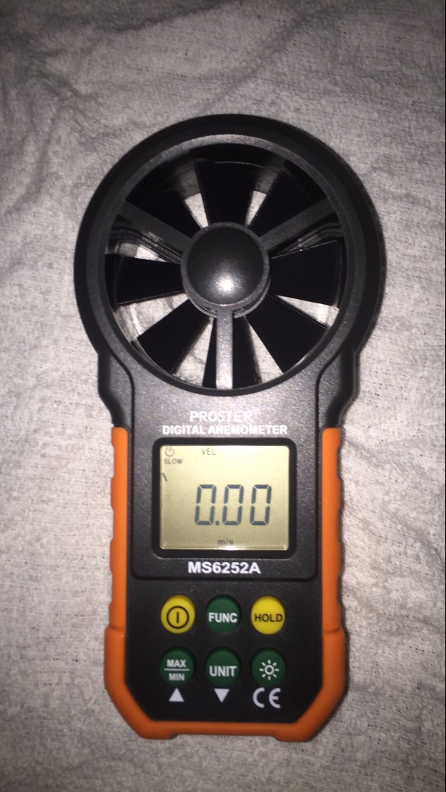

Anyone know how to use one of these? This one specifically. I get it to cfms but when I blow into it - it reads in the thousands. Im guessing it has something to do with punching in the Area numbers. Which I have no idea what to punch in.
Ive sent a few messages to the company which does not have a phone number and the responses are vague and look computer generated based on my questions. Thanks !!

A 2" hose is 3.1416 sq inches.
Sometimes have to funnel or such to get accurate.

I bought one through Bristor he told me how to set it up years ago my main broke but ya there a funnel involved too!

I hear what youre saying .. a machine with less cfm n lift may recover more water due to many variables. But having a better starting point at the machine makes a difference. Like if you take the machine with better performance and side by side test with another that produces lower numbers on the same carpet with the same wand, same hose, same technique then you will realize the machine with the higher numbers will be the one you want.
For instance .. say we look at the numbers on a cars gas effiency .. my wifes Armada gets better gas milage than my Toyota Yaris did. She drives like a gramma and I drove like a bank robber. If she was looking to get the most miles per gallon then she would choose the Yaris based on the numbers.
So it would better to choose based on the numbers .. then if you want to maximize your performance, youd pair it up with the right hoses n wand that will give you the best results.
