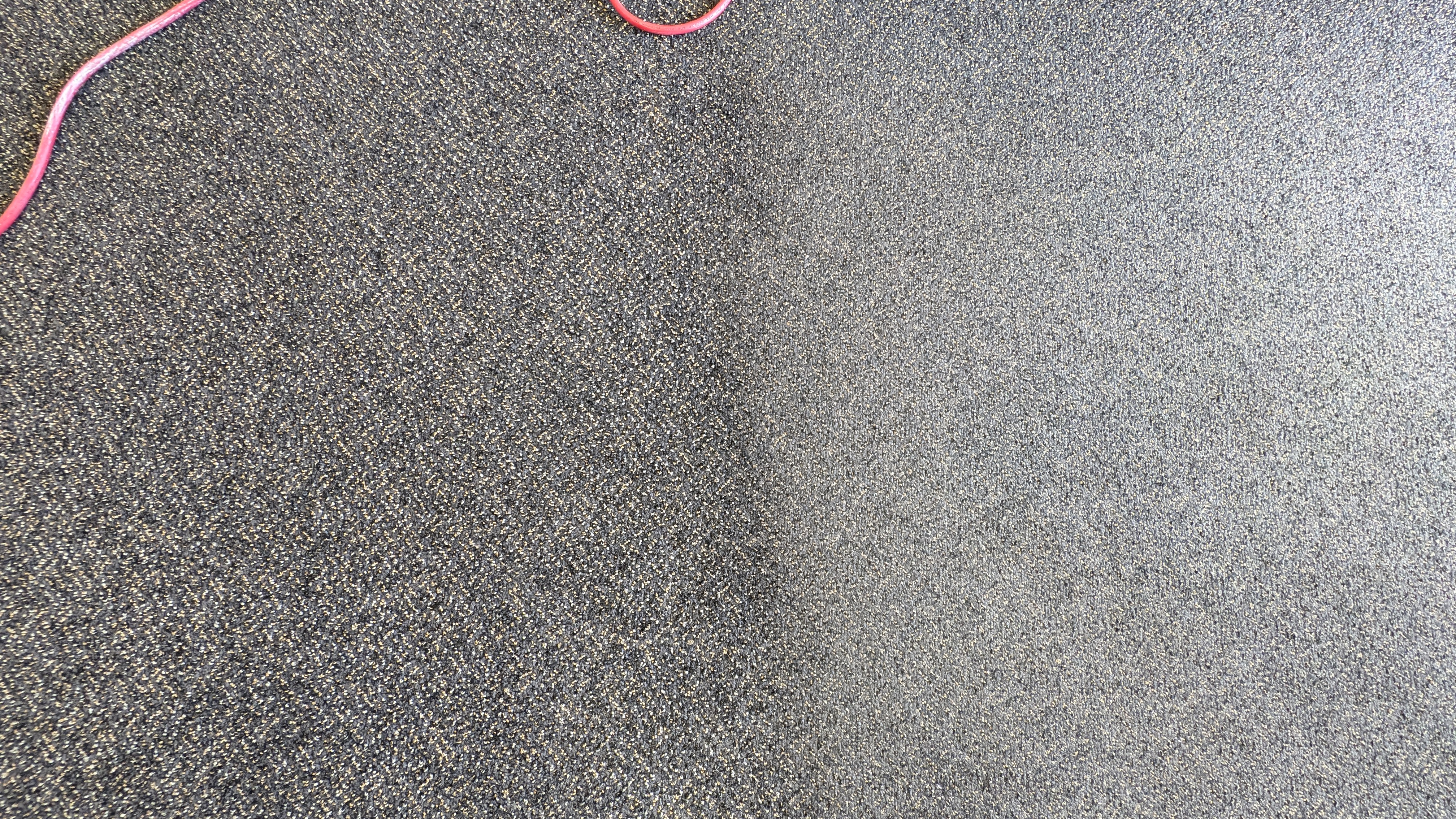

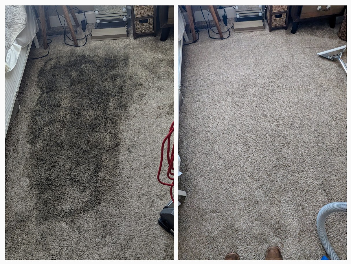

Show us the after pics of that trashed carpet you just cleaned recently?
117,239
Trashed?! lol That whole pic should be purple…
pad job.
I dont go after trashed carpet at this stage in my cleaning career.

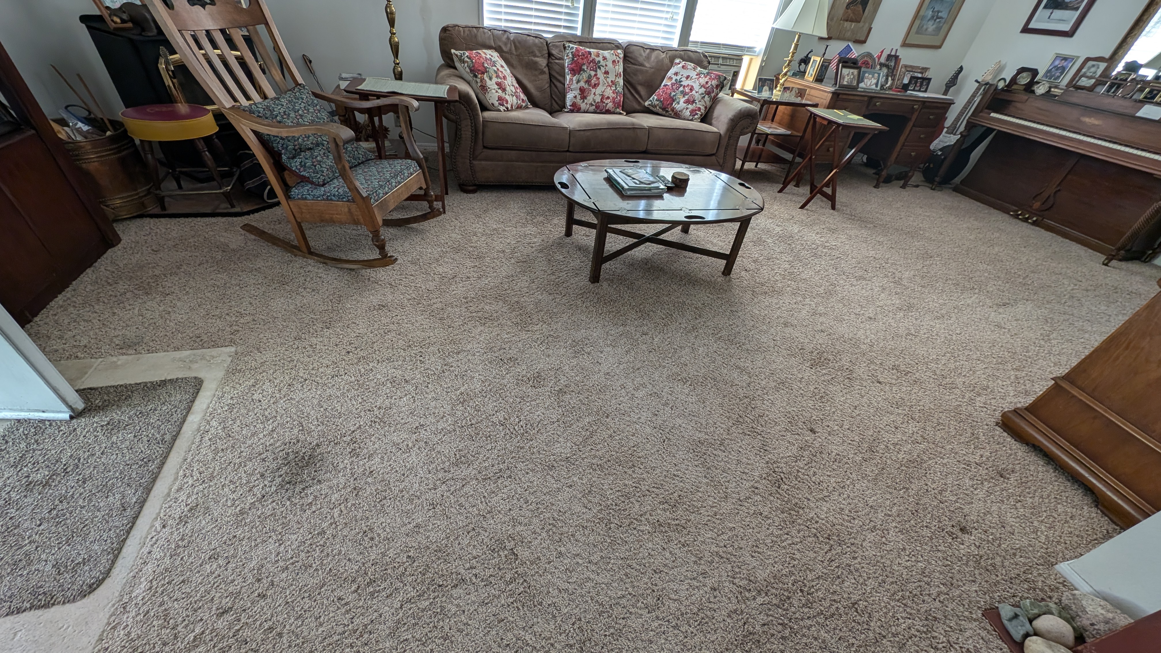

I got a trashed one today .
