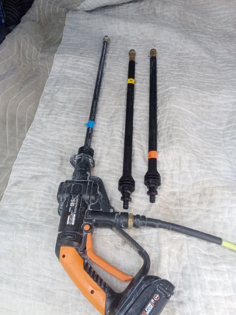

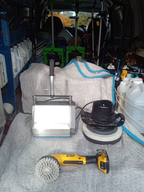

What procedures did you learn over those 6 months that really made a difference?
Cleaning Commercial Carpet with VLM is easy but Cleaning Residential Carpet with VLM is much more of a challenge
SLOW DOWN SLOW DOWN SLOW DOWN and let your machine do it's job. Scrub the carpet thoroughly with the CRB before extracting with your OP. VLM is a slower process than HWE
Put down enough Prespray. At first I was too concerned with getting the carpets to dry fast. I wasn't wetting the carpet enough to get them clean. The sprayers I was using SUCKED. I started using the Worx Sprayer and that was a Game Changer for me
Getting steps clean was my biggest problem in the beginning. I started using my 10'' CRB with short arm to scrub or a Right Angle Drill with Brush to scrub and sometimes both on trashed steps. After I scrubbed I extracted with TOPS Stepson. The steps problem was solved
But the biggest Game Changer was buying a TOPS Odyssey. Challenger did a good job but Odyssey is easier to use, more aggressive, cleans better, faster, and looks Professional. I do a lot of small homes with small rooms. Odyssey is easy to use and maneuver in tight areas
Thank You TOPS for Odyssey and Stepson
Thank You Worx for the BEST Sprayer for VLM

View attachment 124974View attachment 124977

I only use no odor Presprays for nice Residential. I use a Worx Hydroshot to Prespray. Prespray gets into the air and I have had some complaints. If your using Phoenix the jets are only a few inches from the carpet so that's not a problem

I use a CRB and Trinity Odyssey for most of my Residential
I also have a Orbot Vibe TL for large Residential
Residential I scrub with a CRB first before extracting with a OP and Cotton or Microfiber Bonnets
